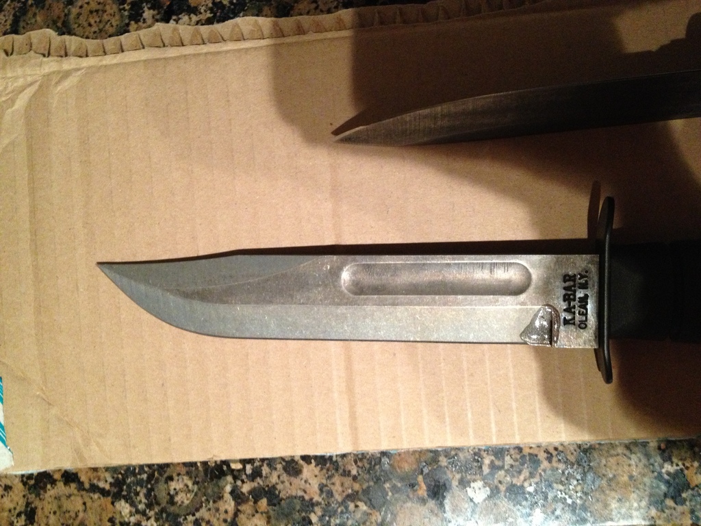

Done! Few questions....
The stripped finish is supposed to be kinda....raw? Rough feeling? I'm sending these off to Richard for sharpening. Is it supposed to look slightly...patina'd?

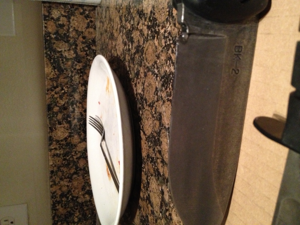

You can see where I decided to leave the finish all around the handle on the BK2. I think this is a better idea. This is not a shelf queen. I think the taping off I did so that the handle retains all of it's coating is a good idea.
