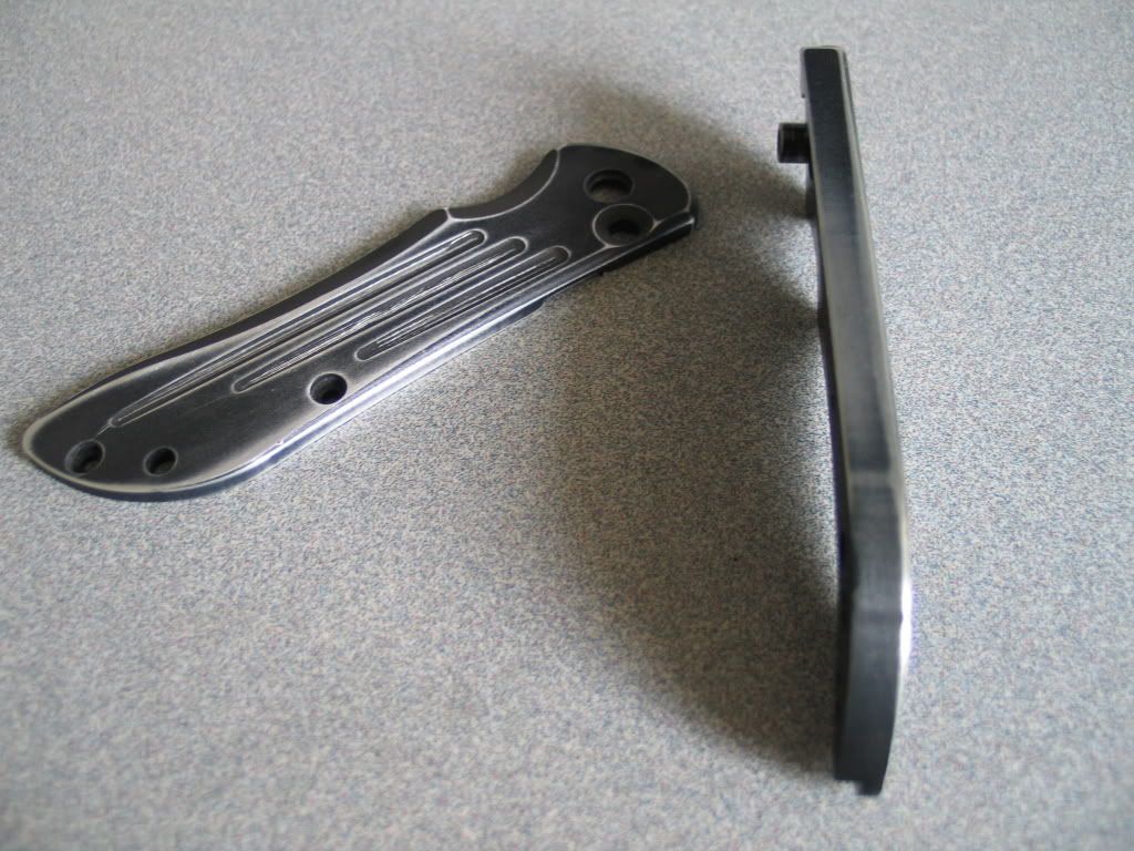

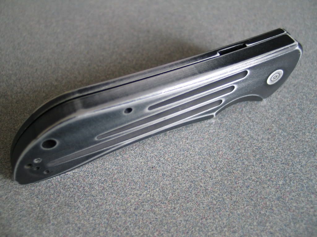

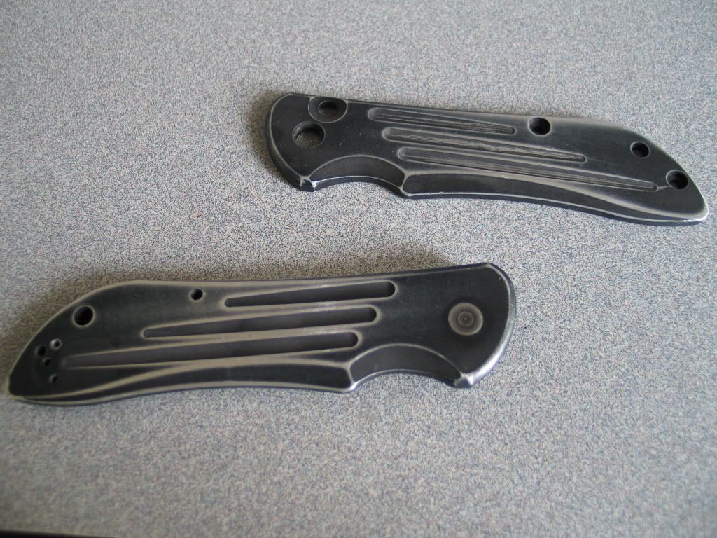

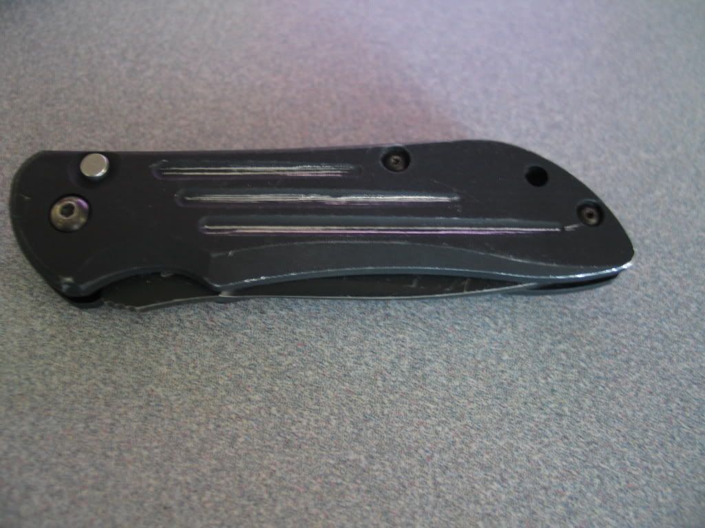

Here are some pictures of the progress I've been making.
Before
After
I need to go pick up some paint thinner Monday. Will continue sanding until then.

So I went with Jasco Premium Paint and Epoxy Remover. Just started the bath a few minutes ago. I'll check on it in an hour or so.
The handles are anodized not painted. You will need a strong Lye solution. It's very dangerous and it will eat the aluminum.
I think you're right about the anodized handles. The Jasco removed the paint from the pocket clip well, but the handles don't seem to be affected by it. I was reading a discussion about removing anodization from motorcycle parts using over cleaner. Any input on this method?
