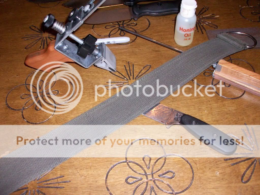

Here is my strop. I picked it up at SMKW's like, a decade ago, I think.
willis was there with me, got him one too.
Here is what I find, I don't hit my knives more than a few times on each side after sharpening them. And by the time I get to the strop, my burr is all but gone. The strop just adds some "finish" to my little ritual. By the time they come off the strop, well, you don't wanna have an accident with them.
