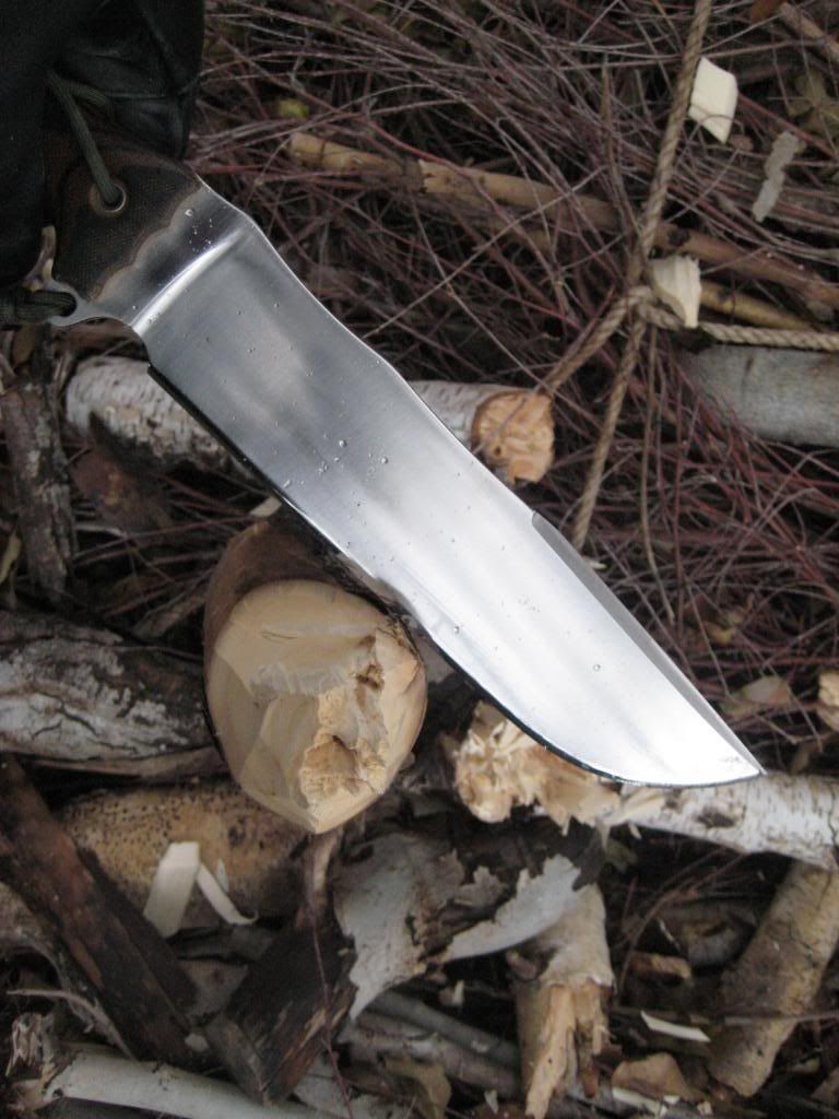

I have three grades, but I only ever use the #6 (red top, but the compound is green. It is really cheap, and I am sure not near as good as the quality stuff, but heck, I get my knives hair popping sharp with it.
Here is the factory edge after just a bit of stropping. (it is convexed now, and the reverse curve is gone).
you can convex an edge by just stropping. It will take a really long time. If you just use the knife and touch up on a strop (and give some strokes to each side higher up on the bevel, you will get a convex edge with a blended transition).
Stropping any edge will make it a bit convex by its very nature. If you hit your edges on a normal stone, or with a fixed angle sharpener and then just finish it on a strop it will still be pretty v shaped.
You can convex an edge on a stone, and infact do a full convex grind on something as big as a sword (which is how the tradition full convex grind is accomplished on Samurai swords).
here are some cuts from a 10 inch chopper with a convex edge. Nice clean cuts.
this was my practice knife. First one I tried.
these were all convexed by hand. The bigger ones took a while.
