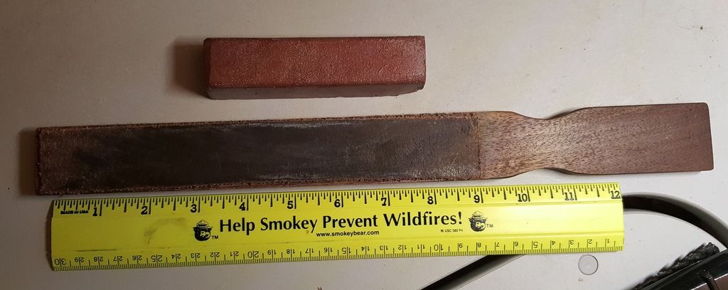

Had to take a picture of my strop. Had been using it for a few years but never took a picture of it. I guy at work made the stick out of walnut and I glued a piece of unfinished belt leather smooth side down with contact cement. For compound I use the brown stick from a four stick set for my buffing wheel, I just rub the end of it across the leather. It is the last step I do after getting the blade edge from my Lansky. If the blade is mirror finish, I pass it over the strop also.
