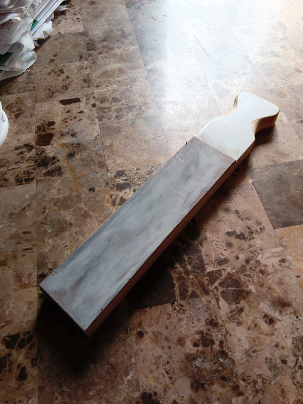

Here's mine. It's a 1x2 board from some children's bed I found by the curb. The handle was shaped on a belt sander. Veg tan leather, smooth side up. Glued to the board.

Build a strop that's one inch wide. At least 8 inches long. Hobby stores sell leather.
And Yeah. Run the strop against the knife. Not the knife against the strop. You can feel if the strop is flat to the edge angle as you move it along the blade.

Hobby lobby sells a small sheet of thin weight, veg tanned cow leather. Which will work fine for stropping. Felt side up or skin side down is a preference. As for the type of other leathers. Start with cow. Unless you really feel like spending more money.
I used 3M, 'High Strength 90', spray adhesive. (Only because I had some for a while. The same can is probably $30 today.) Any decent contact cement will work.
You can use a range of common compounds. Aluminum mag wheel polish, jewelry paste, polishing wheel compound.
