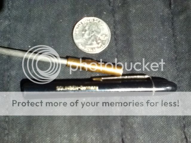

That struck a cord. I remembered seeing Germany on mine. I don't see any other I.D. on it . . . but the pocket clip has a cool patina on it so it's cool right ? :confused: :D
I've had it for ever. I bought it because I thought it looked old and classic and I wanted to learn how to use a steel.
Recently I put it in my EDC ITTESTR (in-the-trenches-emergency-sharpening-tool–roll).
