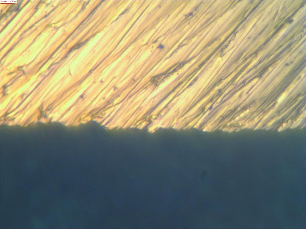

To reduce the likelihood of rounding the edge, use a harder backing. Either compress the leather when its damp (there are instructions in the stropping sticky authored by Stitchawl), switch to MDF or balsa, wrap a sheet of paper around a combination stone, or check out the Washboard link in my signature - I made specifically to counteract both the smoothing and rounding effect from most stropping operations, but retain the ease of use and burr free removal of steel.
This at 1000x (1600 with digital boost), there is no rounding of the cutting edge, the edge stays three finger sticky - very catchy yet capable of treetopping hair or even whittling a hair:
after stropping with compound on two sheets of paper
And after stropping on one sheet of plain paper
If you don't care to invest in a Washboard, at least try using a sheet of paper wrapped around your stone - apply compound to that. The coarse side works better. In general, stropping is a great way to tune-up an edge, finish an edge off, maintain an edge with specific cutting qualities all with the least possible amount of steel removed - just have to figure out what combination of grit, surface, and backing to use, and how much pressure you can get away with.
