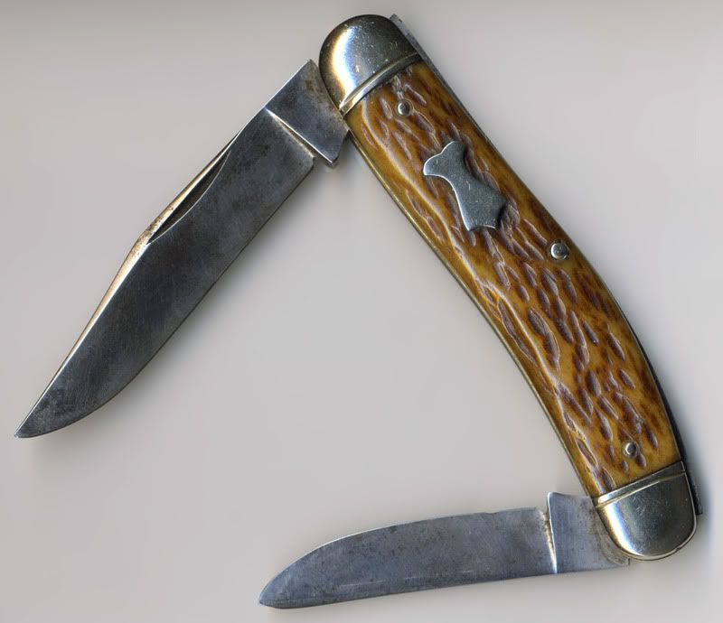

On a double-end jack, the main blade will be made from thicker stock and the secondary blade will have a catch bit. The overall thickness of a double-end jack can be very slender.
Years ago, the pattern that I proposed for the forum knife would have met your requirements. It was a double-end jack with clip and sheepfoot blades like the 2015 forum knife but built on the taller handle of a sowbelly. The taller and curvier handle would swallow up the blades a bit better and fit the hand a bit better. It was patterned after this knife (replacing the spey with a sheepfoot). My suggestion made it to the final vote but didn't win.

Outstanding knife Jake

Jake, the design you describe would go in the right direction indeed. I get however the impression that few makers offer two blades on the same spring (probably for stability and lifetime reasons).
Thank you, Mike.
Another thing for the OP to consider is that the overall thickness of a double-end jack depends somewhat on the size of the secondary blade. A larger secondary blade will require more room to accommodate.
A lot of vintage double-end jacks were very thin knives. Some of the smaller ones are wafer thin. And the old knives usually had very thin blade grinds. So you might also keep an eye out for a vintage knife in good condition.
Multi-blades are a bit more complicated to make. And single blades seem to sell well... my impression is that single blade knives seem to appeal better to folks who are more familiar with modern knives than traditional knives. The makers that I suggested above will all do multi-blades.
