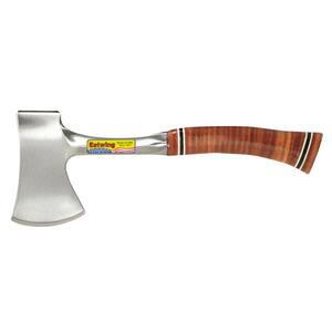

Just got an Estwing axe.
Was worried about the handle and I was right, had to use it today in heat and humidity and man was it hard to hold on to.
Looking at the handle shape, anyone have any experience wrapping this for grip?
Something that will not slide?
I was debating it before I used it, but yeah, once your hand sweats, it needs some meat.
Fancy or not, just want it to stay.
Wondering if I need to strip the lacquer as well?
I would try sanding it and then apply mink oil or sno-seal. I have a few leather handled knives and hatchetes. Once they are broken in they seem to be pretty grippy, wet or dry.

I wouldn't use stripper on the on the leather. Just a good sanding with some 220 grit. A dremel (or similar) works great. Not sure about snow bee. Sno seal is like mink oil. You can put it on leather boots to water proof them. When I treat my leather handles, I use a hair dryer to heat the handle. This allows the mink oil or sno seal to sink in well. You can try the wraping if you like. If you go with the grip tape style you may find you will want to use gloves as the tape will not be comfortable after using it for a while. I just like the looks of the leather grips. Mine are well worn and I have no problem with my grip slipping, Even with sweaty hands. Going back to the gloves, you should probably be wearing them any ways if your doing some heavy chopping. You know...safty and all;)

Will give the sanding a try.
