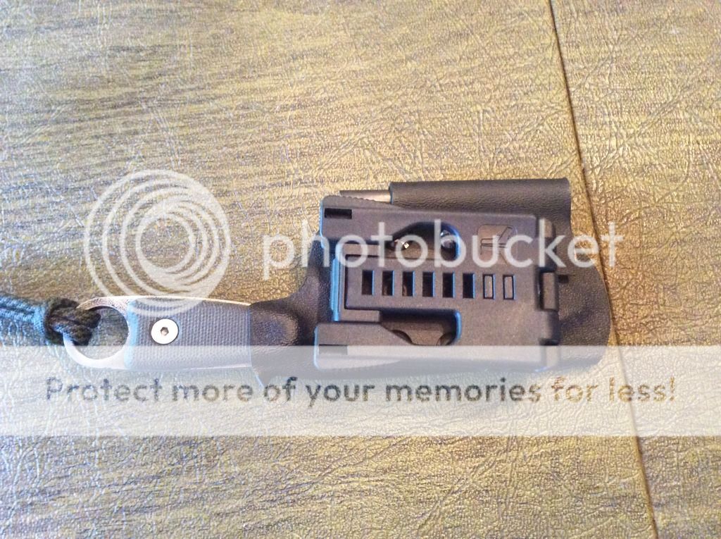

Newest sheath for my bk 14 tek lok and Fire steel with the fire steel the handle came off when trying to unsheathed it so I need to glue it back also I need new hardware I'm hating that look So suggestions praises criticism are welcome I want to get better ;)
Looks good to me.
I'm just wondering if the firesteel holder has a little to much retention if the handle pulled off. Did you leave enough room so the handle doesn't rub either?
The handle was old and no I didn't leave enough room when the handle came off I hadn't attached it to the sheath yet for that reason. Thinking of maybe just using duct tape as the handle think that would work?
Maybe you can slot the holes a little bit so you can slide the holder out some to give you room. I think I'd rather have a piece of an old broom handle or nothing at all over some duct tape.
