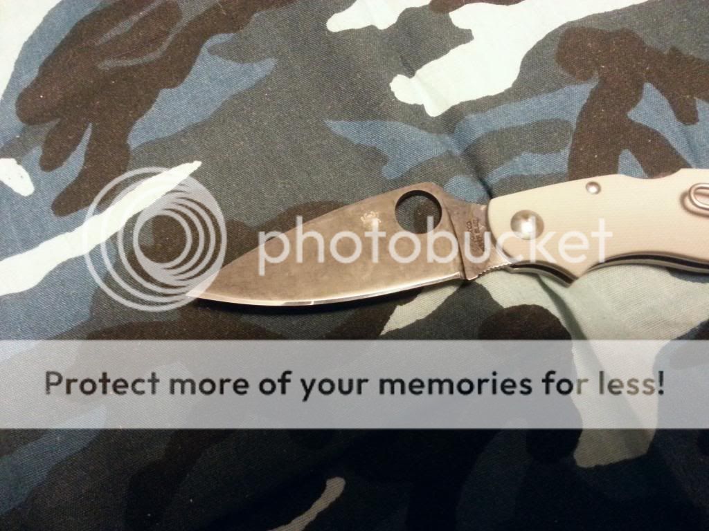

I've got a Caly 3.5 in Aogami Super Blue steel and I love it. SuperBlue seems to perform as well as ZDP-189 but is easier to sharpen. I've read that SB takes on a petina quite easily but resists actual rust build up. Well I don't find that to be the case. I really like the Caly. I resisted carrying it because I didn't want a high maintenance steel. Eventually I took the blade apart cleaned it with alcohol so it was free of oils and forced on a patina by submerging it in distilled vinegar for about 8 minutes. It took on a really nice and even greyish bronze color. My hope was that this patina layer would protect the steel from actually forming rust. Alas, no. Specks of reddish brown rust are popping up all over the place, and they're hard to remove. Part of me wants to say screw it, and let it do what it'll naturally do. Would another treatment of vinegar build up the patina further to help prevent rust deposits? Or am I way off? Spyderco is coming out with a few more SB blades, I'd love to pick up a Delica in SB. I love the look of a patina, but hate specks of rust. :confused:

Interesting. I didn't know the new SB Spydercos will be coated. I havent been cutting foods or fruit. I've noticed that even touching the blade will leave a fingerprint image of rust deposits. Oh well. Maybe I'll try forcing a patina in vinegar again.
I would advise against forcing a patina. Polish the blade with Flitz and then let it form a patina through use. This will slow the process down enough for you to make sure red spots are not forming. This should not really take long, especially if you are using it with food. Once it has a decent patina along the whole blade you should lubricate it.

I guess I'll just have to live with it. I did a forced patina since I wanted the entire blade to be nice and even. It looks great. I just got it in my head for some reason that the patina will prevent actual rust spots. Thats why I wasn't using a rust inhibitor. I'll keep it oiled from now on. Thanks.
a lot of people say patina prevents rust, but I think it's probably just a placebo effect. what it does is make new staining harder to see. in my experience they will rust just about as quickly, if there is a difference it's too small to notice.

Patina is pretty much a natural and crude form of bluing. Both prevent rust in that the steel has a stable and relatively passive oxide layer on the surface. The issue is that it's easily defeated in the presence of acids and salts (aka fruits and sweat/fingerprints). I really don't get what the big deal is though, it's carbon steel, and a bit more rust resistant than 1095, so treat it like carbon steel by keeping the pivot oiled and wiping it off immediately after cutting something that would stain it, the patina will be self-repairing and rust will not be an issue.
Thanks for all the info guys. For the record, here is a pic of the forced patina.
Thanks. It came out really nice. Originally it had a lighter bronze-ish patina but it was soon peppered with rust spots. I scrubbed them off as best I could with alcohol and forced another patina. It almost looks like a cerakote or DLC coating. It's shiny because its slathered with oil now.
