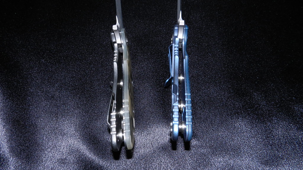

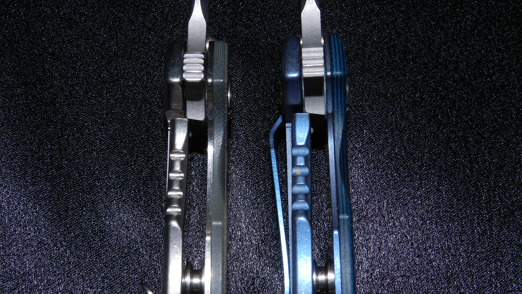

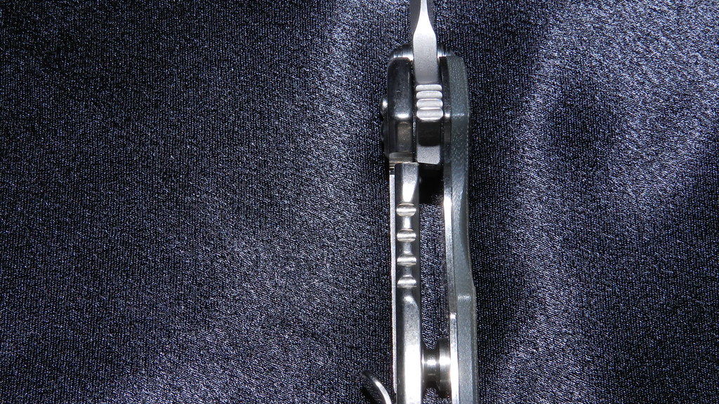

I guess I can give props to Hinderer for always giving us early lockup, I think I've found the earliest lockup on any knife I have ever seen. It's a Production XM-18 3.5" Flipper Slicer Gen 4 w/ working finish on blade only from BLADE Atlanta. (Knife is not Mine, just here for Wicked Edge Sharpening)
What's the earliest lock up you've got an an XM-18?
Here it is next to the earliest lock up in my collection of Hinderers, the blue custom is the earliest I have at about 15-20%, doesnt even come close. This one Looks to be about 5%.

Have that also on some of my customs, indeed super early but still rock solid. Its looks a bit scary though :)

Yeah it does look unsafe but if slipits can do without a lock I'm sure we're good here. Although I'm sure that may be a little too close to the edge at less than .5mm of contact & it may disengage if you tried to, (not my knife so I'm not going to see if it will disengage.) Use it like a slipit till it breaks in to a safer zone with the benefit of even longer lock life.

It looks like it wouldnt even hold 5 lbs, or a tap on the spine - thats a bit scary for a "hard use knife"

Its not a case peanut by any means, its a " hard use knife" i think i would want 10% lockup at the VERY least
I would not feel confident with a lockup that early if there was pressure on the blade spine and my fingers in the path of the blade.

Though I do agree that the OP's lock up is a bit too early, as long as he's using it to CUT, the pressure is being exerted upwards..... there's no reason why that lockbar should fail. Now for whatever reason one decides he needs to be "tactical" and start stabbing 3" steel plates, then it might. Other than that I don't see early lock up being a problem.
Really not sure what the point of this thread is/was. IF the actual Owner of the knife sees this as an issue and wishes to have the knife adjusted then he/she can send an email to Rob and the matter will be handled in an expeditious manner.
