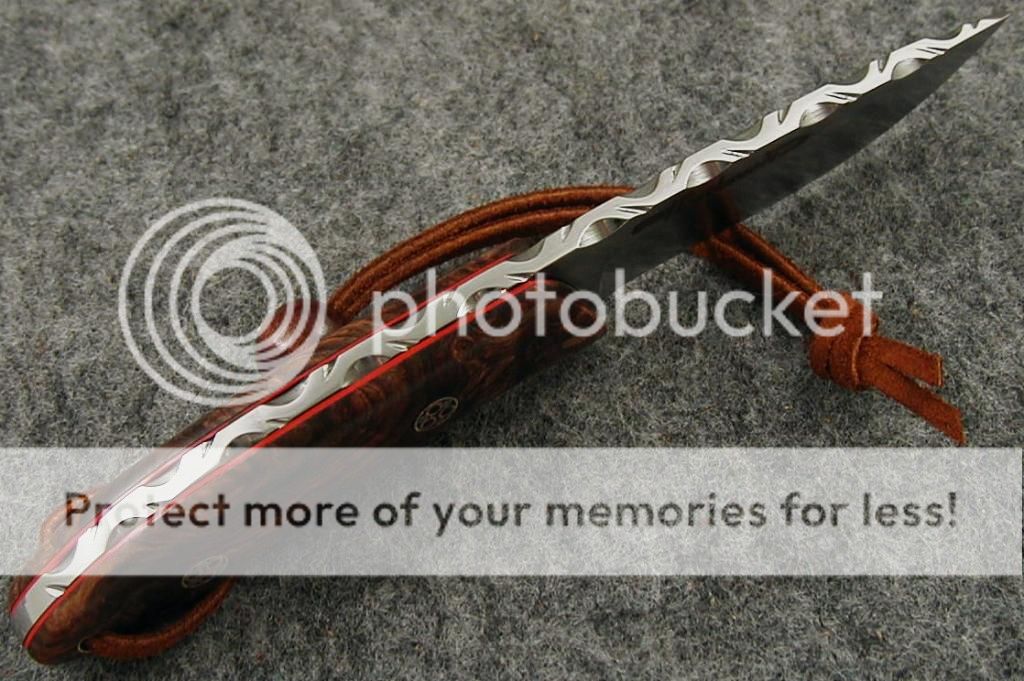

Does anybody know where I can get some plastic spacer material? I can find tons of vulcanized available but most of the makers here seem to think it's too hard to work with and complain that it's affected by moisture. Texasknifemakersupply lists the plastic material but they are "out of stock" on all colors, so no luck there. Couldn't find any at Jantz, knife kits, or USAknifemakers.........

Don't waste your time with plastic!!!
I quit using vulcanized stuff about 9 years ago and started surface grinding micarta down for spacer material (works great but time/labor intensive for something so simple).
It was fairly recently that it FINALLY dawned on me that my buddy Chuck Bybee (Alpha Knife Supply http://www.alphaknifesupply.com ) sells G10 in a myriad of colors in just about any thickness you could want.
I currently have 0.014", 0.024", and 0.060" It is THE WAY to go (IMHO) :)
I wanted to add that using plastic plates is a horrible idea. It's cheap material that your epoxy won't stick to, and if you clean things up with Acetone it will eat right through that crap.
Sheets of G10 from AKS are a few bucks and will make a ton of spacers.
I'm glad that somebody mentioned that. There are very few plastics that are durable and chemical resistant enough for this application and there are also very few that epoxy will bond to properly. Lunch plates, cups, plastic packaging, vinyl siding etc all have poor adhesion. Some can be solvent welded to similar material, but not to steel, and epoxy, CA etc don't bond well to these materials. Not well enough for a knife handle.

+1 on what Nick said,it's the way to go.Also great people to deal with.

I also use the thin G10 sheets from Alpha Knife Supply for liners. It works and looks much better than the vulcanized rubber I have used in the past.
