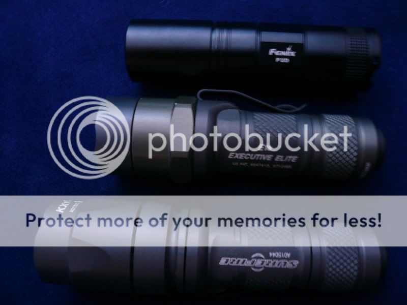

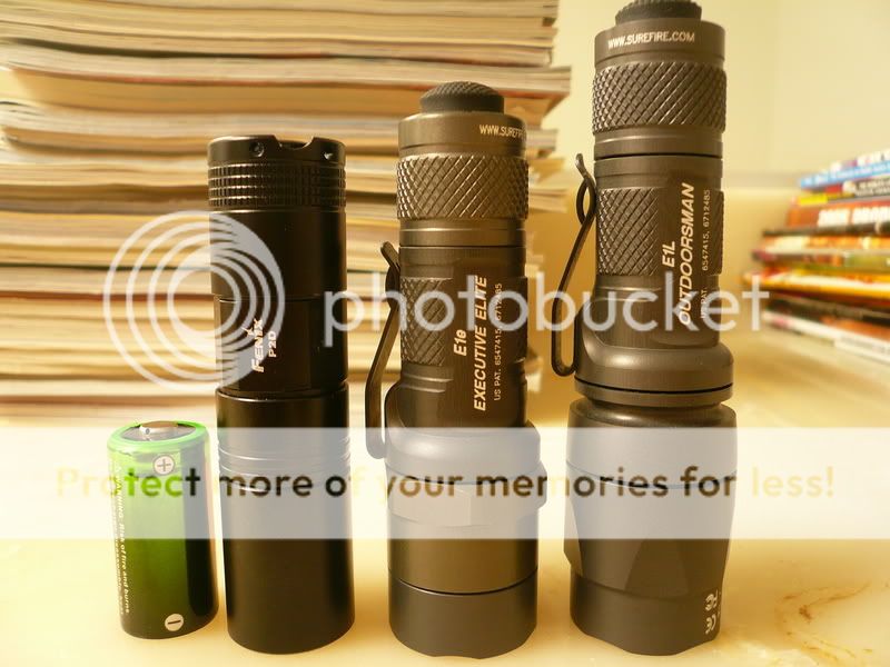

as a result of a recent thread, i purchased a fenix p2d to try out. i also recently purchased a surefire e1l with the cree head.
some thoughts on both.

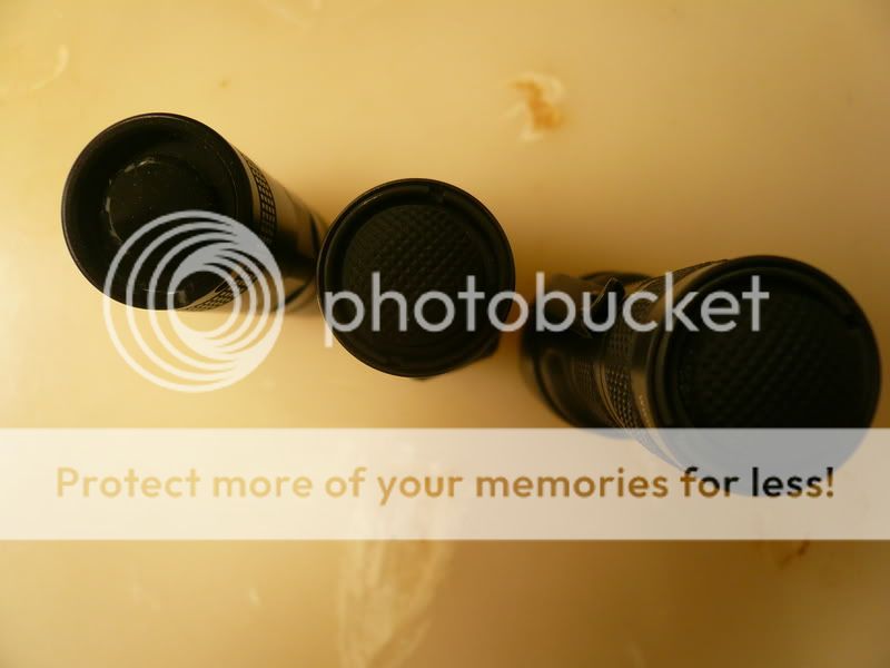

comparison pics, 123 battery for scale.

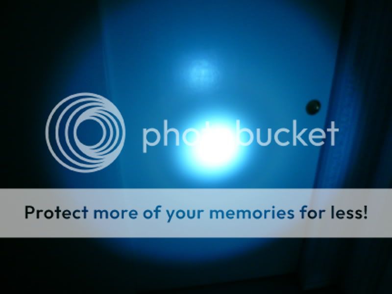

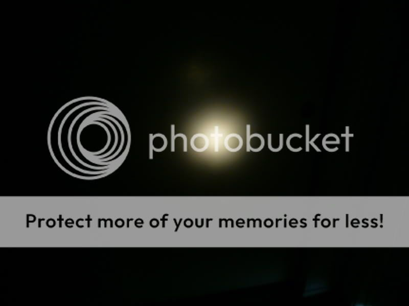

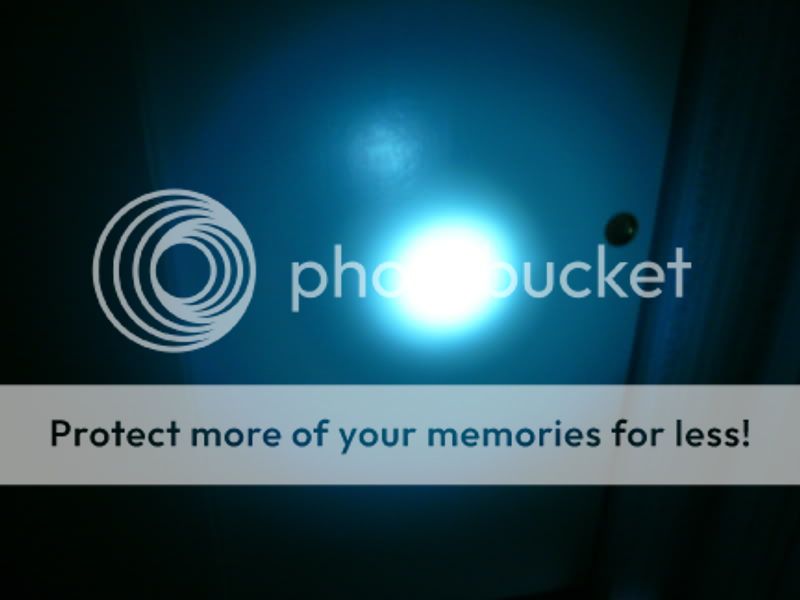

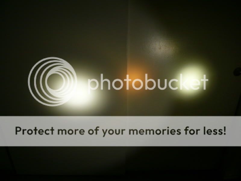

comparison pics of the beams.
left to right, fenix, e1e, e1l
e1e...
e1l...
fenix...
all had fresh batteries. the beams are at a distance of about two yards.
size: the fenix is MUCH smaller than the other two. the surefires are comfortable in a front pocket, but the fenix just disappears.
egronomics: i found the fenix to be a bit "slippery" as a result of the smooth round shape and small size.
the surefires are very comfortable and have a no slip grip. the surefire "no roll" shape also ensures a positive grip. be careful setting the fenix down, it will easily roll away under a car or off a table.
function: i dont care for the multi settings on the fenix. i would prefer just bright and dim settings. i found it frustrating to have to "toggle" through each setting. i also dont like the lack of a momentary on position.
the surefires, of course, have only momentary and constant on. very simple to use.
price: at half the price, the fenix has the surefires beat.
brightness: may not be evident in the pics, but the fenix is easily twice as bright as the e1l, and the e1e is not even worth mentioning here. the e1e incandescent bulb produces far less usable light.
overall:
both companies produce unquestionable quality products. as far as durabilty, time will tell. i have only had the fenix for a few days, and the e1l for a few weeks.
i plan on keeping and using both, though i will likely carry the e1l more often. its simplicity and momentary on function being the reasons.
the fenix will find time when dressed up or when weight/size is an issue, though all three are easily and comfortably carried.
i have ordered another fenix, the p1, which has only one brightness setting. i dont have much use for all the settings on the p2d, and the lack of a momentary on will relegate this one to second string.
i would recommend either flashilight, both are well made and bright. if size and price are important, the fenix wins hands down. for ergonomics, customer service, and time tested durabilty and function, surefire (as a company) gets the nod.
Nice review! The pictures show a pretty dramatic diference between the incandecsent and the LED.

Thanks for your review and the brightness comparisons. Really shows a dramatic contrast between the cree lights and the regular bulbs. I have been thinking about getting a Fenix light, and now I think i'm sold! :D
