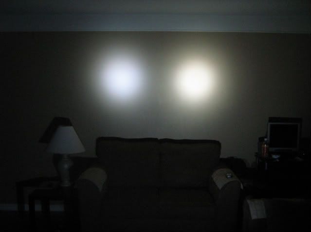

The beam pattern was typical Surefire. Flawless bright center dot with an even diffused surrounding off spill. Light color was a different story. Close up you can't really tell, but turn the lights off and shine it on a white wall and there is a very noticeable blue ting to the light. Disappointing really considering my E2DL has a perfectly tuned white beam.

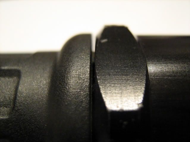

Construction was top notch, F&F were amazing as always. Close tolerances on all the parts, especially the battery tube. Changing batteries is fun because they slide in without any rattle and hold very securely. Some lights will have a battery "rattle" while this one doesn't.

Here is a side by side of the two drop-in's, surefire on the left malkoff on the right.
The blue tint is normal for the underdriven Seoul emitter that Surefire uses for this model.
I guess that explains it.
