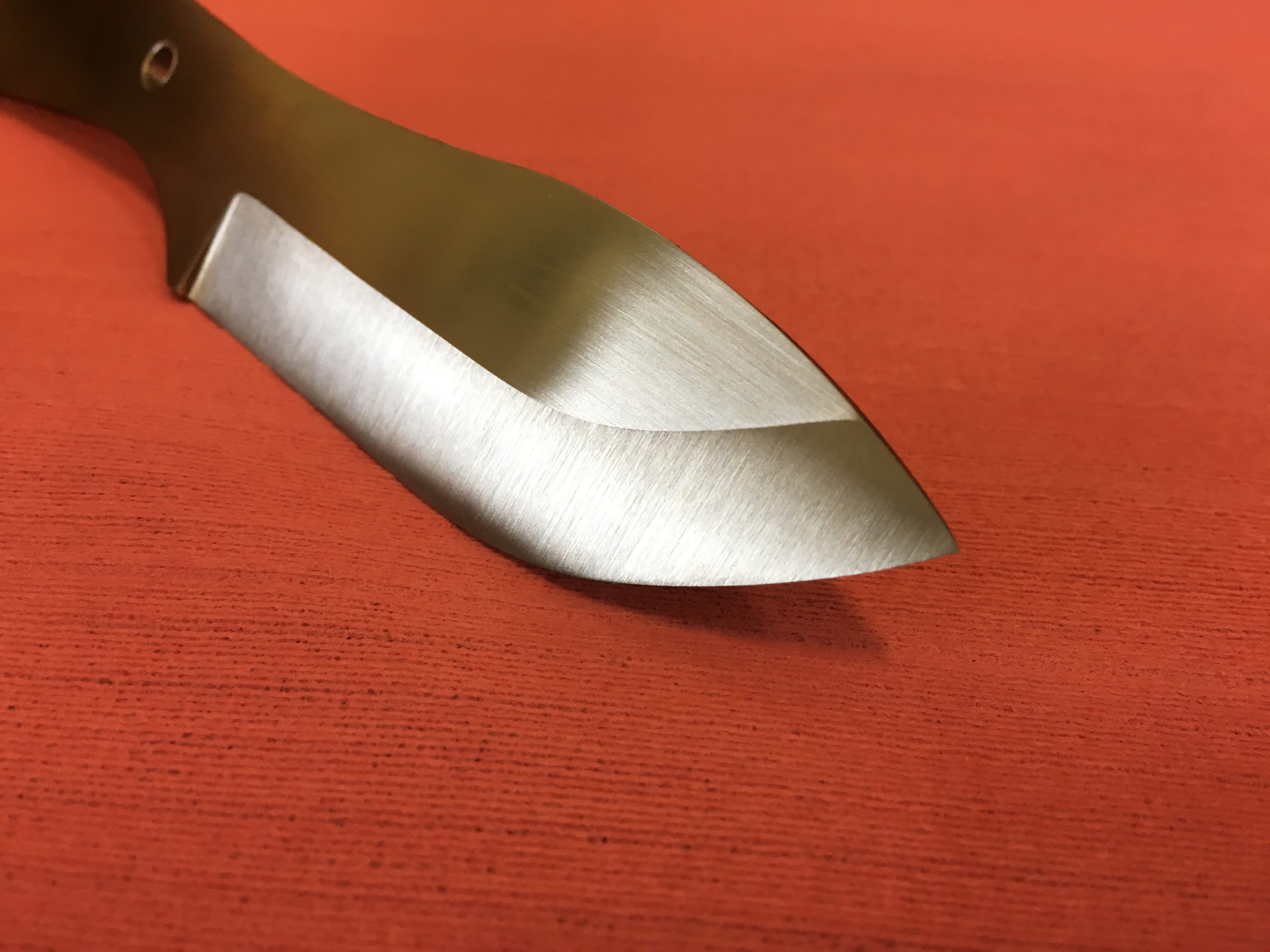

Ive been hand sanding my flats the length of the knife up to 400g, and the bevels on the grinder (perpendicular to flats) up to 220 or 400.. after I get the bevels the way I like, I hit the bevels with a blue fine conditioning belt until its a nice even finish, this makes scratches on the flats obviously 90 degrees to my hand sand finish. Then I will do a quick hand sand on the flats lengthwise again being careful not to hit the bevels, otherwise I start over haha. I like the perpendicular grind lines even though its a pain.
This one below had a quick buff to it also but hand sand lines are still present

Do you use a jig to grind your edge bevels? Reasion I ask is the edge bevel grind lines are running vertical and do not sweep with the edge.
No jig, all freehand. Yes I’ve noticed that with a couple I’ve done like the bottom picture. I’ve been able to fix that since. Too one actually micrometers right on the full bevel length. I’ve found when I scribed my lines I wasn’t scribing them right so they were tapered a little
