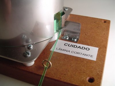

Came across this video that has a simple device that allows you to make long strands of "rope" from 2 liter bottles. Unfortunately, I don't understand a word of what they are saying, but the video shows the process well.

I thought this was pretty clever, and a good use of materials in a pinch.
http://www.utsumi.com.br/pet/English/filetador/index.html

It's a great idea!! Cut the bottom of the bottle off with your knife. Then slowly and carefully start cutting ribbon with the same knife by going around the bottle. Definitely a good way to use an extra plastic bottle in a survival situation if you already have enough water containers, etc. but are short on cordage or want something moisture resistant, such as for shelter construction.
Strong enough for shelter building i would think. water bottles may be a bit problematic though, they're thinner and have those grip groves in them.
That is really, really cool. It would be pretty easy to make one with a dowel, board with a groove in it and a utility knife blade (or better yet, a carpet knife blade which is much heavier).

I attempted to make one this weekend, and man it didn't go well at all! I was using cheap utility blades that kept breaking (I was holding them in place with small nails). I'm interested in trying to make one out of common things we might have in kits.
So, a saw, small blade, maybe some nails or something. I'm report back if ever actually get it to work!
Try a carpet knife blade. They are much more stout than utility blades and have a nice elongated hole in the center so you could hold it in place with a screw and washer. They are rectangular in shape. Do a google image search to see what I mean.
..actually. ..one of those hookblade type utility blades might be good here being that the material would pull into it..
