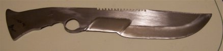

Here is a rough out of a survival knife a client has requested, The saw teeth actually work! Tell me what yo think and what you would like different. It will have green Micarta scales.

Holy cow! A finger twirling tracker knife. To be completely honest, I would have done away with the "hole", but if that was a requirement, it's a strange one. I could have accepted a slight subhilt though. Would have preferred a less downward curved handle and gone with a stright one instead; as your design is a dual edged cutter. Good luck. That is all.
I like it. The "spinning Hole" would actually make for a good grip, especially in a pulling action such as working the saw. What kind of grip will it get? I hope it gets one.
