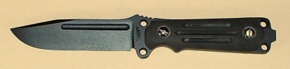

Hi All, Something else I don't do very often is a tac styled knife. I designed this for my wifes doctor who is for one an avid hiker and also goes to desolate parts of the world doing surgeries during times of disaster. I really like this piece and am prototyping it with more survival minded features so the design is not yet complete.
Specs are;
Blade ; Differentially tempered 5160, 5" X 1/4" thick X 1 1/4" wide, flat ground to spine with a convexed edge. Blade has 2 3/4" x 1/4" fuller and unsharpened
clip point.
Handle; Inclined knurled thumb ramp, Index finger recess for better retention and blade control. 4, 1/4" chamfered holes for lashing to a pole for use as a spear
or extended weapon. Extended tab on but for prying and glass breaker. Handle scales are fluted bead blasted black G10 attached with Chicago screws.
OAL; 10 1/4"
Thanks for looking
