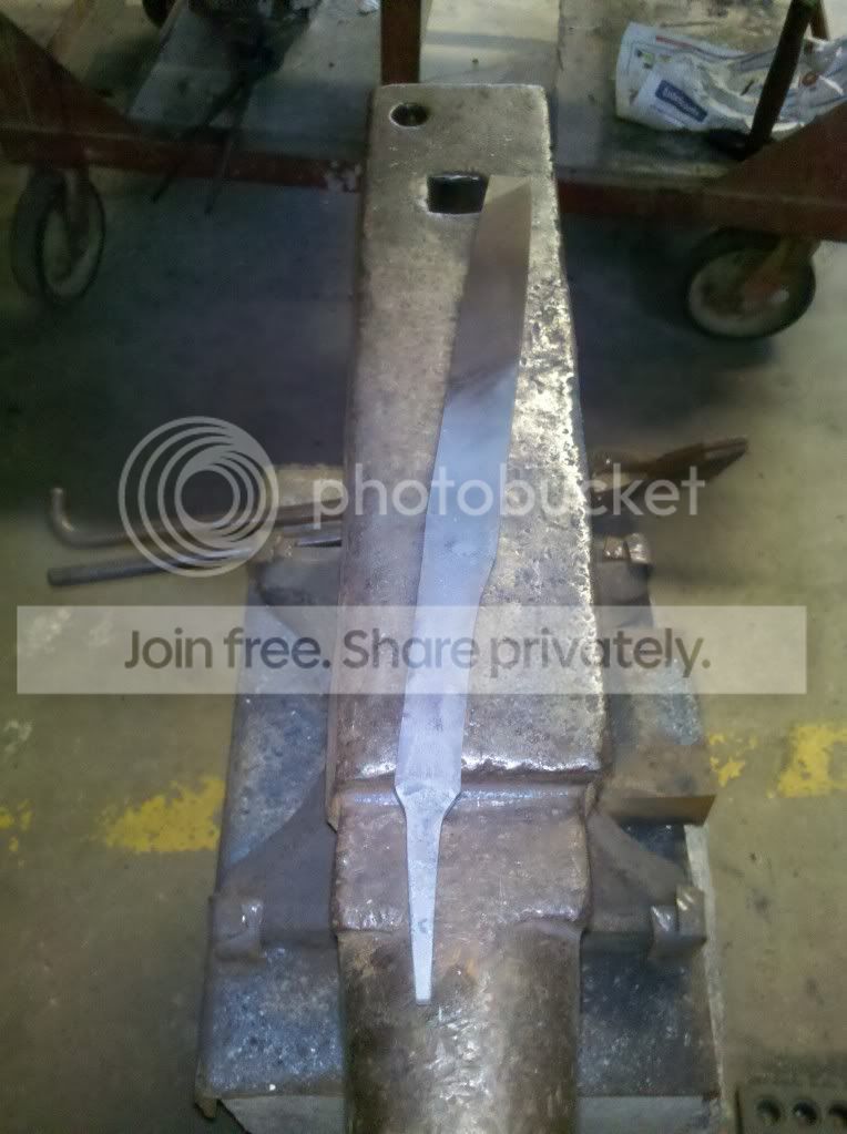

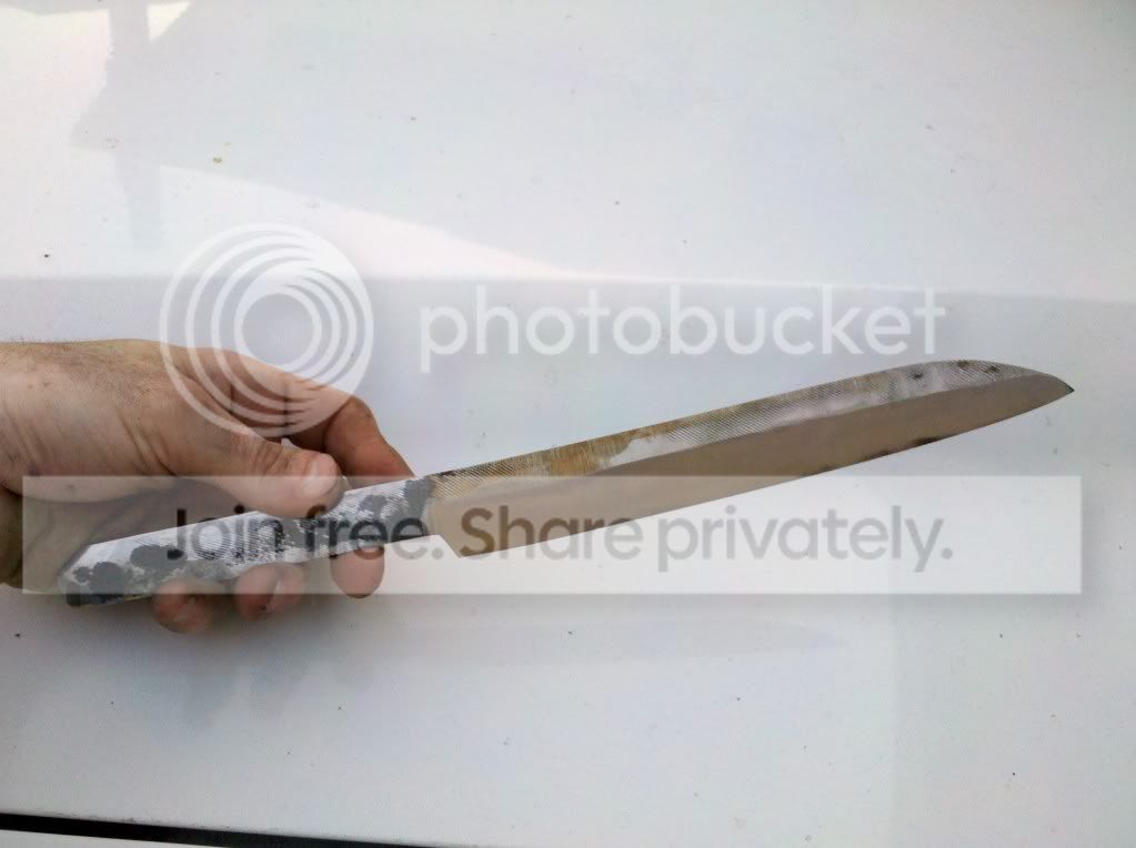

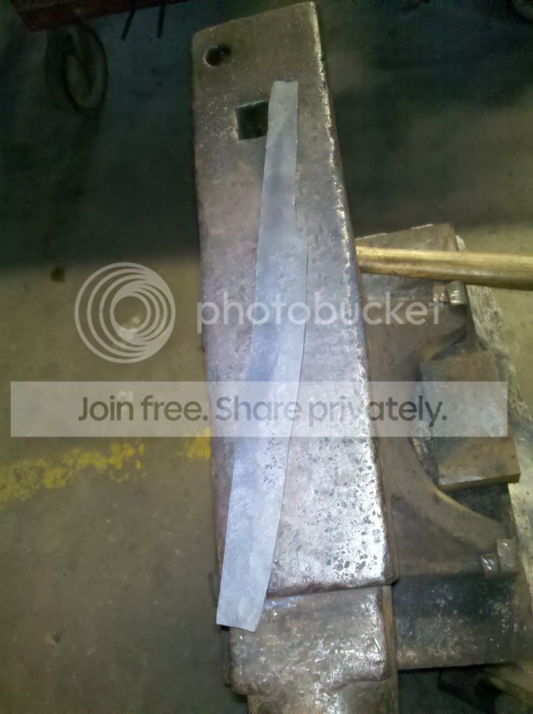

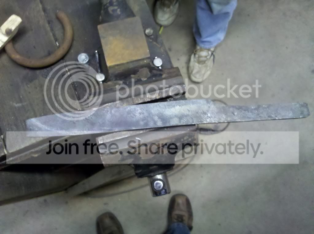

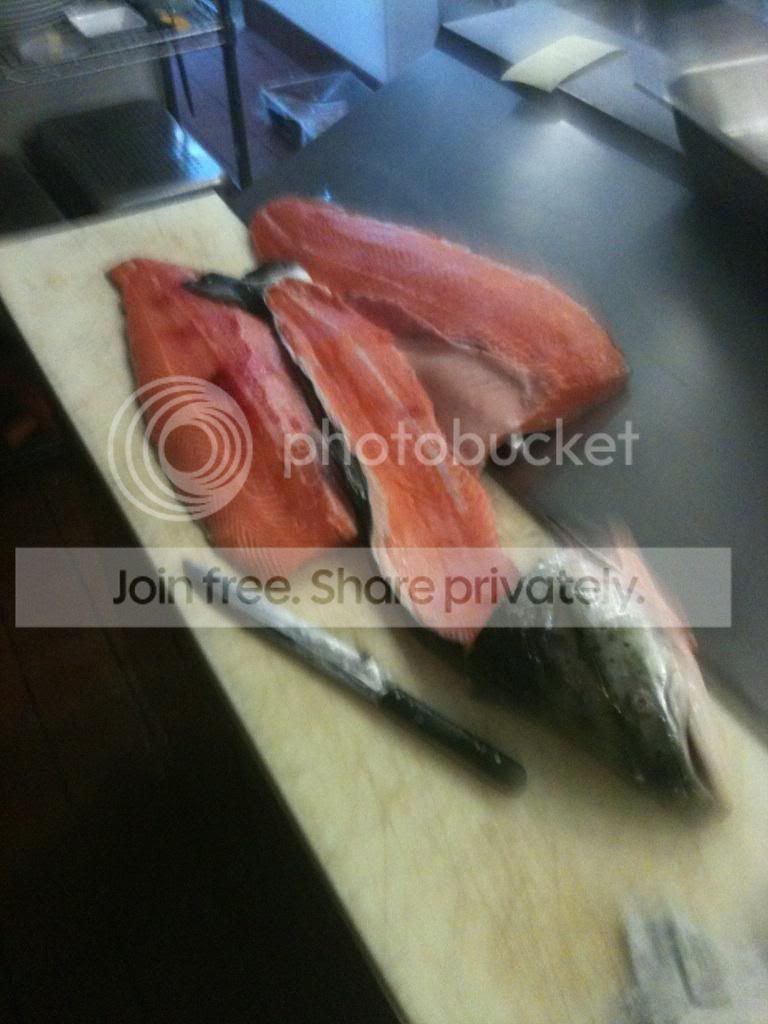

So some of y'all have probably seen some of my knives on here or ARFCOM and i've been getting better and a little more creative with my designs (although they're still fairly simple). a friend of mine here in San Antonio is a chef at a really nice seafood restaurant and wanted a custom made japanese style sushi/chef's knife. i started out with an old nicholson metal file and threw it in the forge.

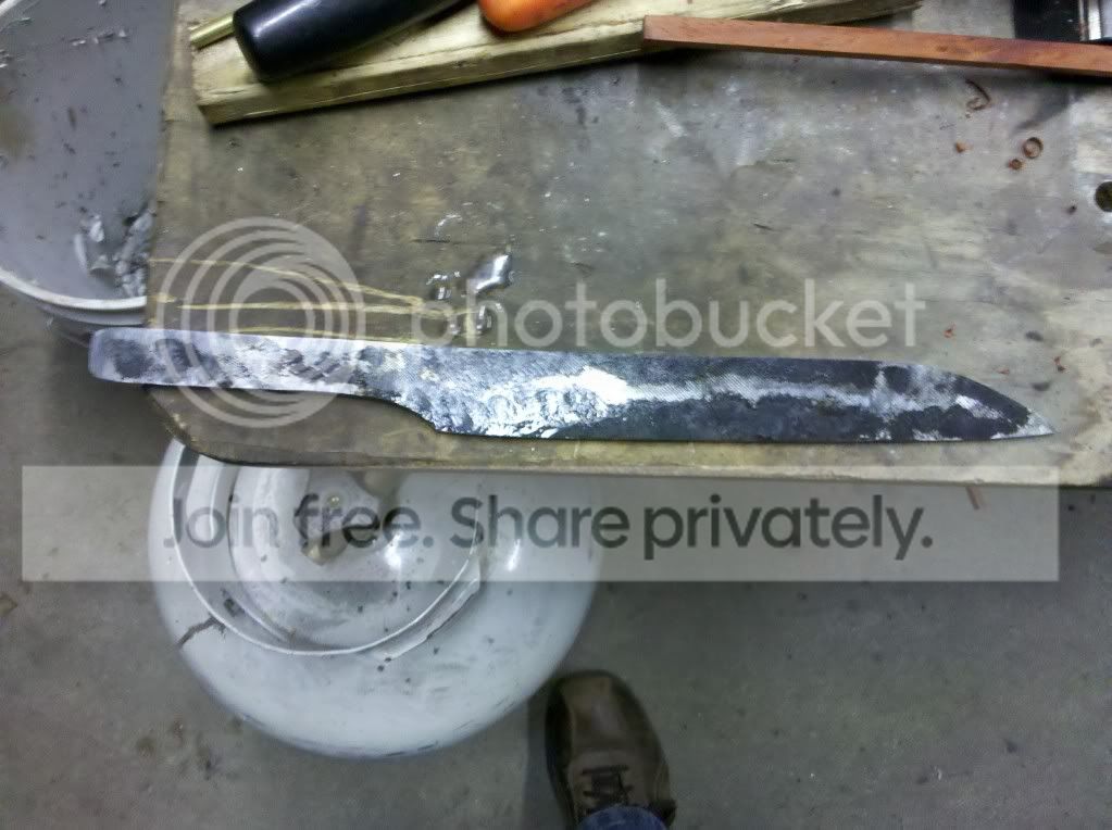

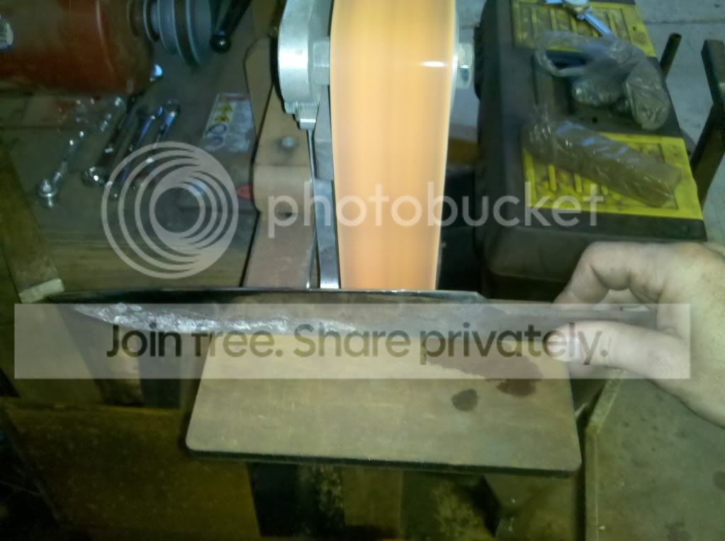

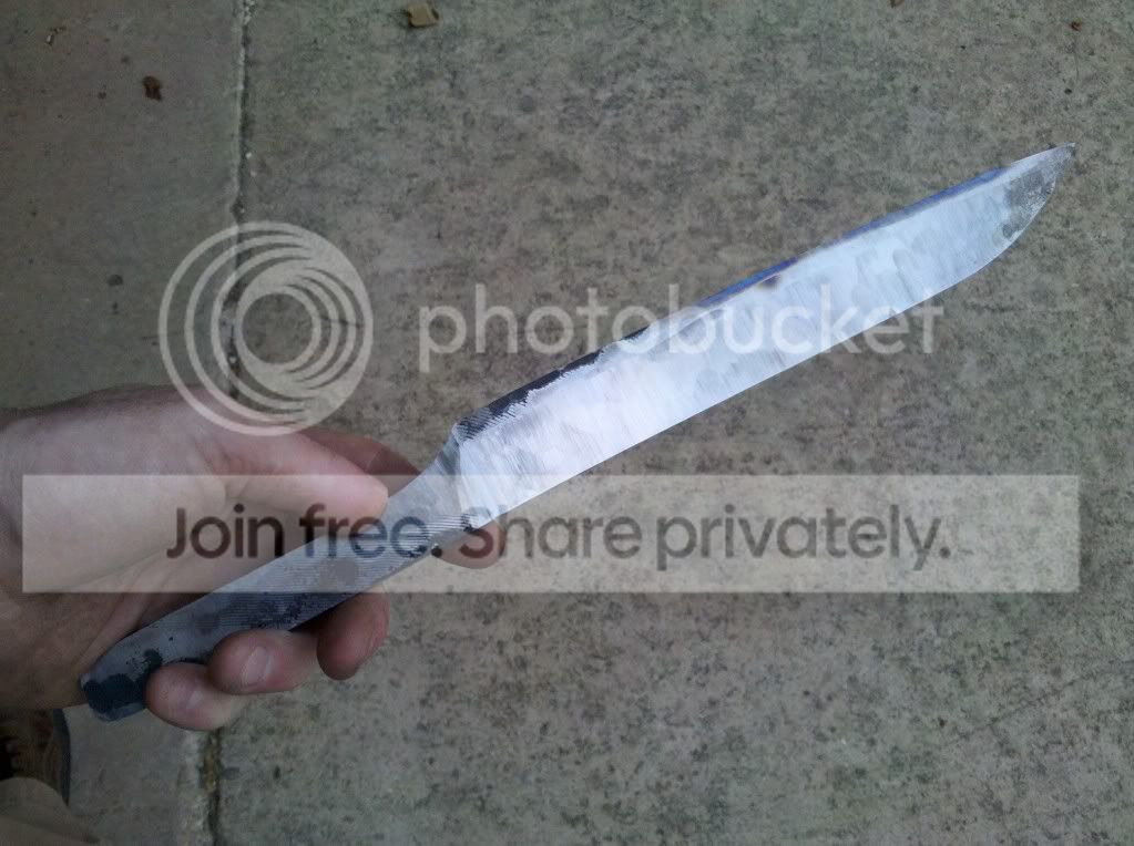

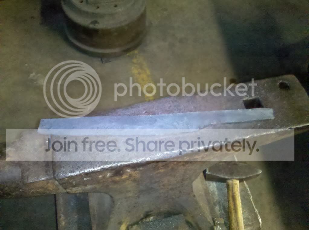

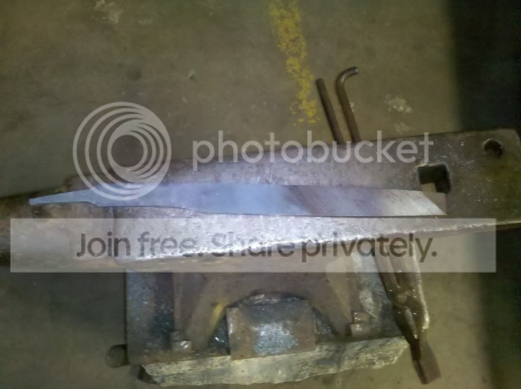

once i got the shape of the handle i did a little bit of forging on the blade to make it wider. once i got the width where i wanted it i took it to the sanding belt which took up the vast majorty of the time i spent working on this project. the steel was extremely hard and the progress was slow going. my instructor finally got in some 60grit belts which made the work go a lot faster.

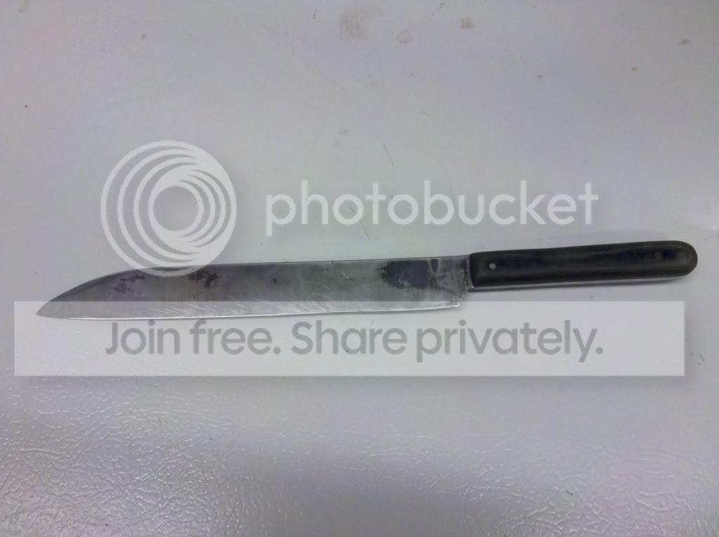

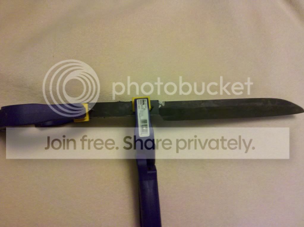

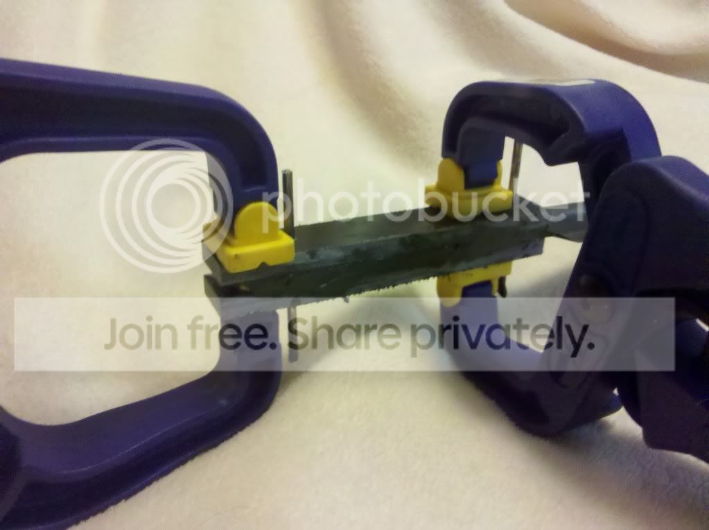

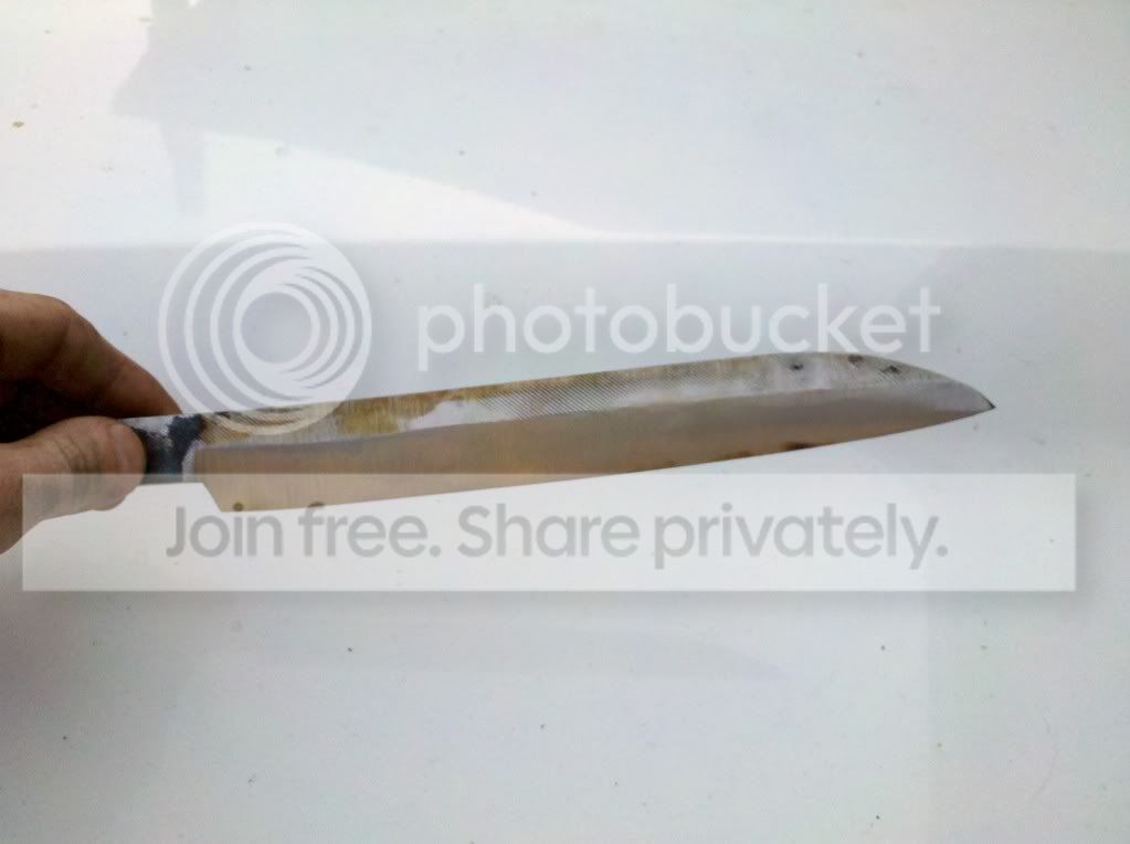

after i got all the shaping done i heated, quenched and tempered the blade. i went on knifekits.com and bought some black canvas micarta, some stainless steel pin stock and some jb weld for the handles.

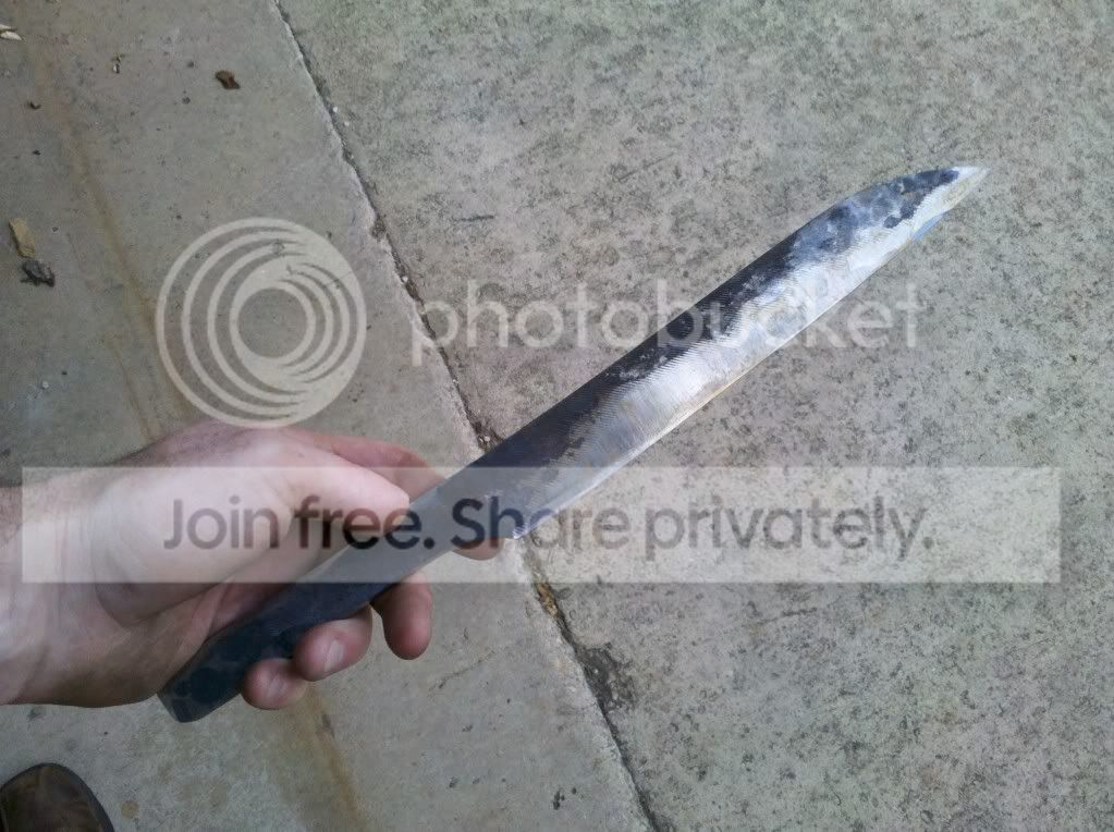

after some work back on the sanding belt i sharpened the blade shaving sharp.

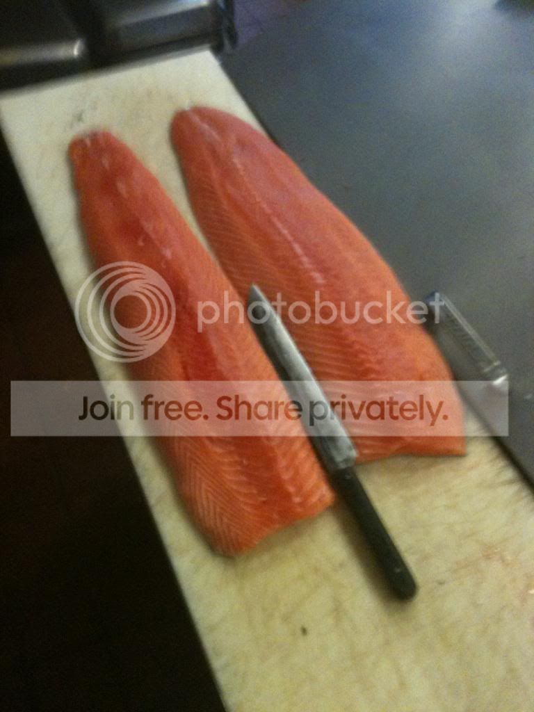

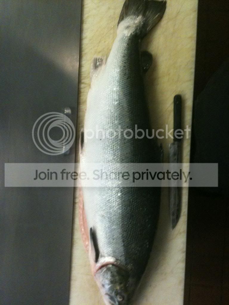

after class i dropped by my buddy's restaurant and delivered the knive. he was amazed at how well it turned out. as i drove to work i got a text from him that said, "Damn son. That blade is sharp as shit." he then sent me some action pics of a salmon getting fileted.

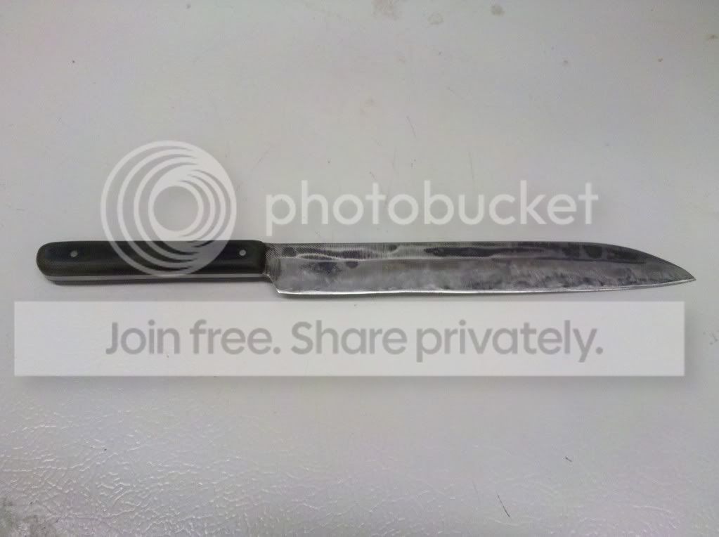

I will start by saying that the knife looks functional and the forging looks good.The photos show it can cut. The finishing looks poor, however.
I know it is a user knife.......but would you buy a new truck from the dealership that had dents covered in primer, just because it was going to be a work truck? I doubt it!
A culinary knife should be finished to a smooth and clean surface. The "Brut de Forge" look is popular with some folks for frontier knives, but does not belong, or look right, on a kitchen knife, in my opinion. No need for a polished blade, but a 220 grit satin finish might have been a better choice.
...it's not all that pretty...
There's the understatement of the day.:p;)
As sharp as it may be, I would think that a polished finished would have been much nicer to fillet/sushi if not essential.

i offered to do a better finish, but my buddy said he wanted it left as is. i agree it would've looked better without a lot of the scratches, forging marks and file pattern, but i tried to make the customer happy!
