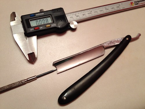

All (except the very old examples referred to as "wedges") straight razors are hollow ground. Even the Kamisori (Japanese straight razor) are hollow chisel ground. The result is a VERY thin (see below) and very acute angle (generally 13-16 degrees inclusive) edge. While specialty kitchen knives can have some pretty radical dimensions at times, I have never seen anyone attempt a straight razor geometry for one.
Straight razor edges can be damaged QUITE easily, and would not be a good choice for any sort of food prep I have ever seen (sushi and sashimi included).
Here is a measurement of the blade thickness of a basic straight in my collection. This thickness was measured at a point about 1/3 the way between the edge and spine (as indicated with the pointer). Your half and quarter hollows will not be as thin this high up the profile, but all effective razors will be extremely thin behind the bevel.
