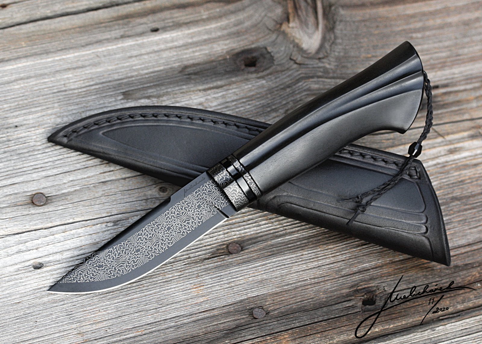

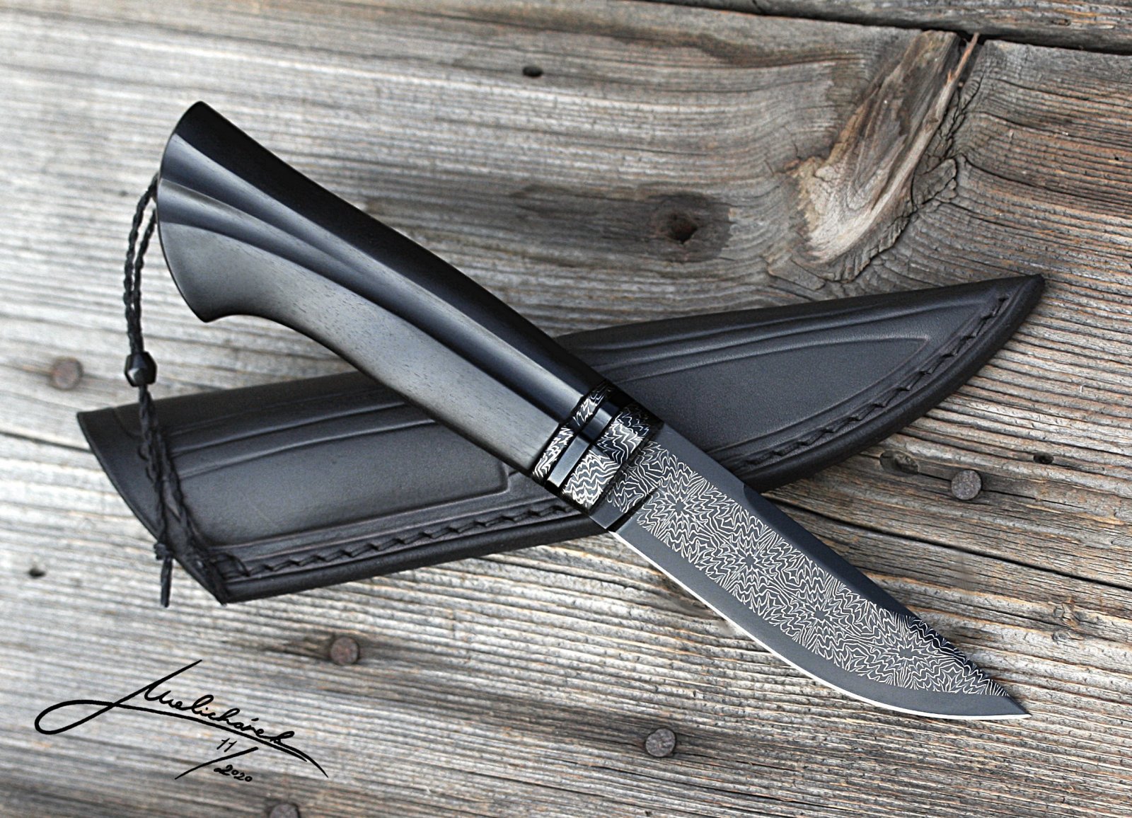

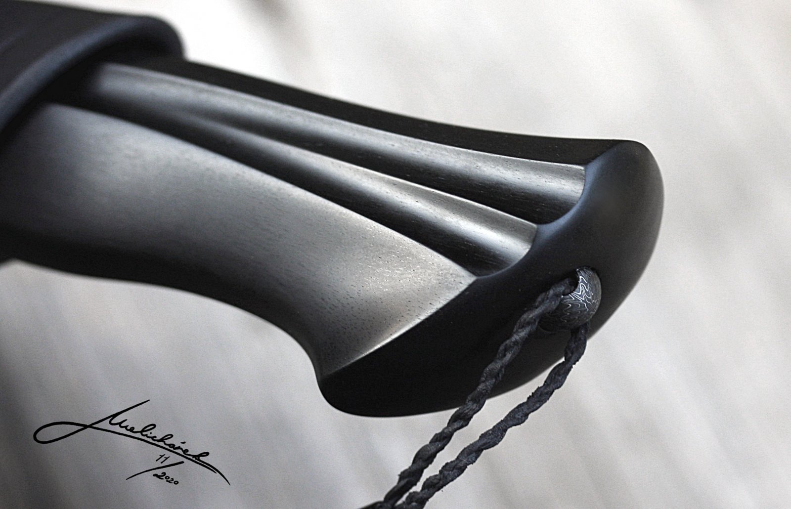

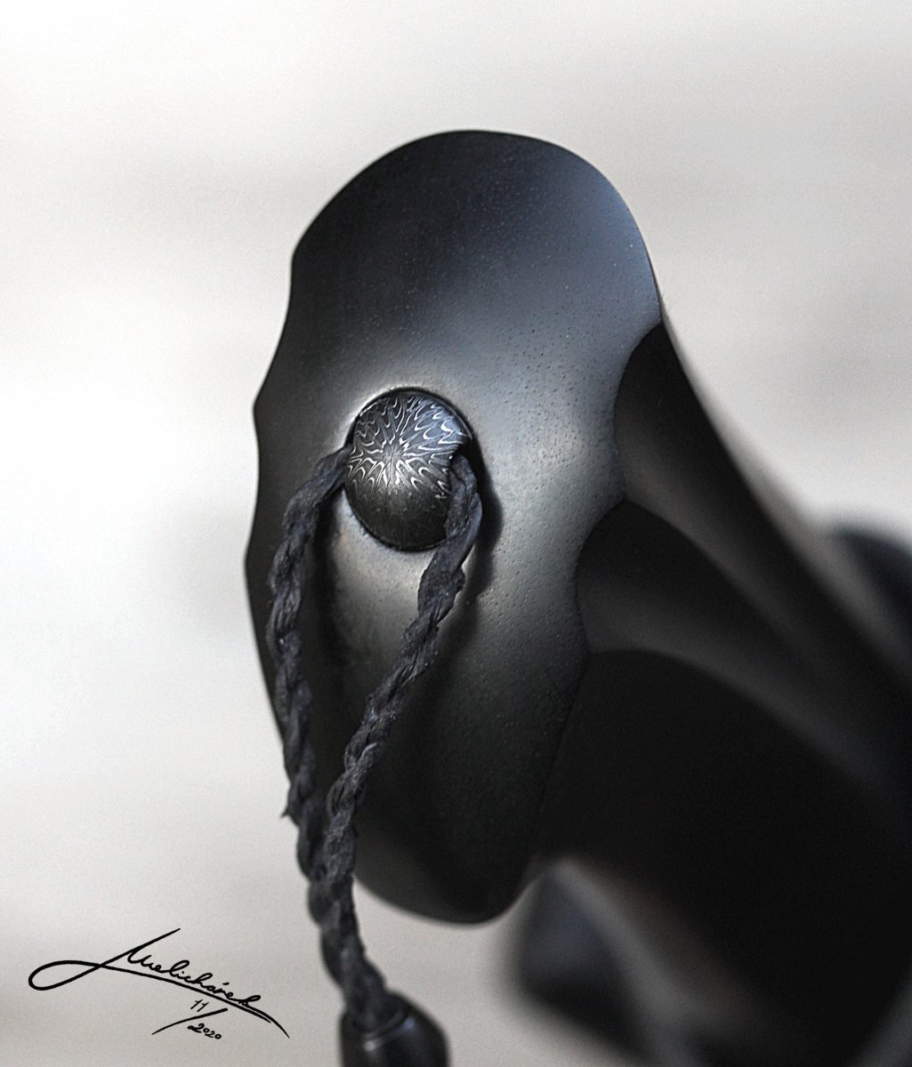

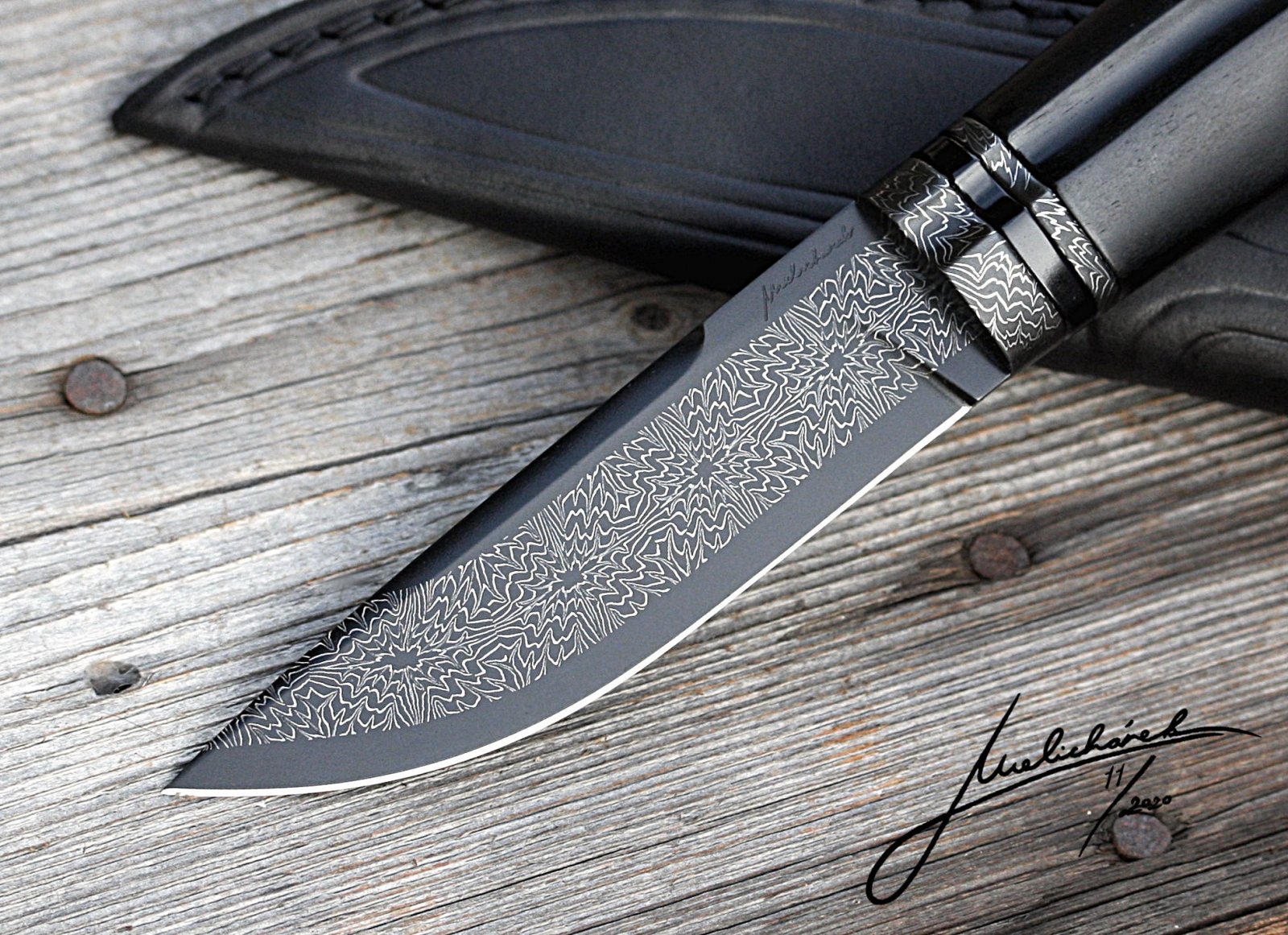

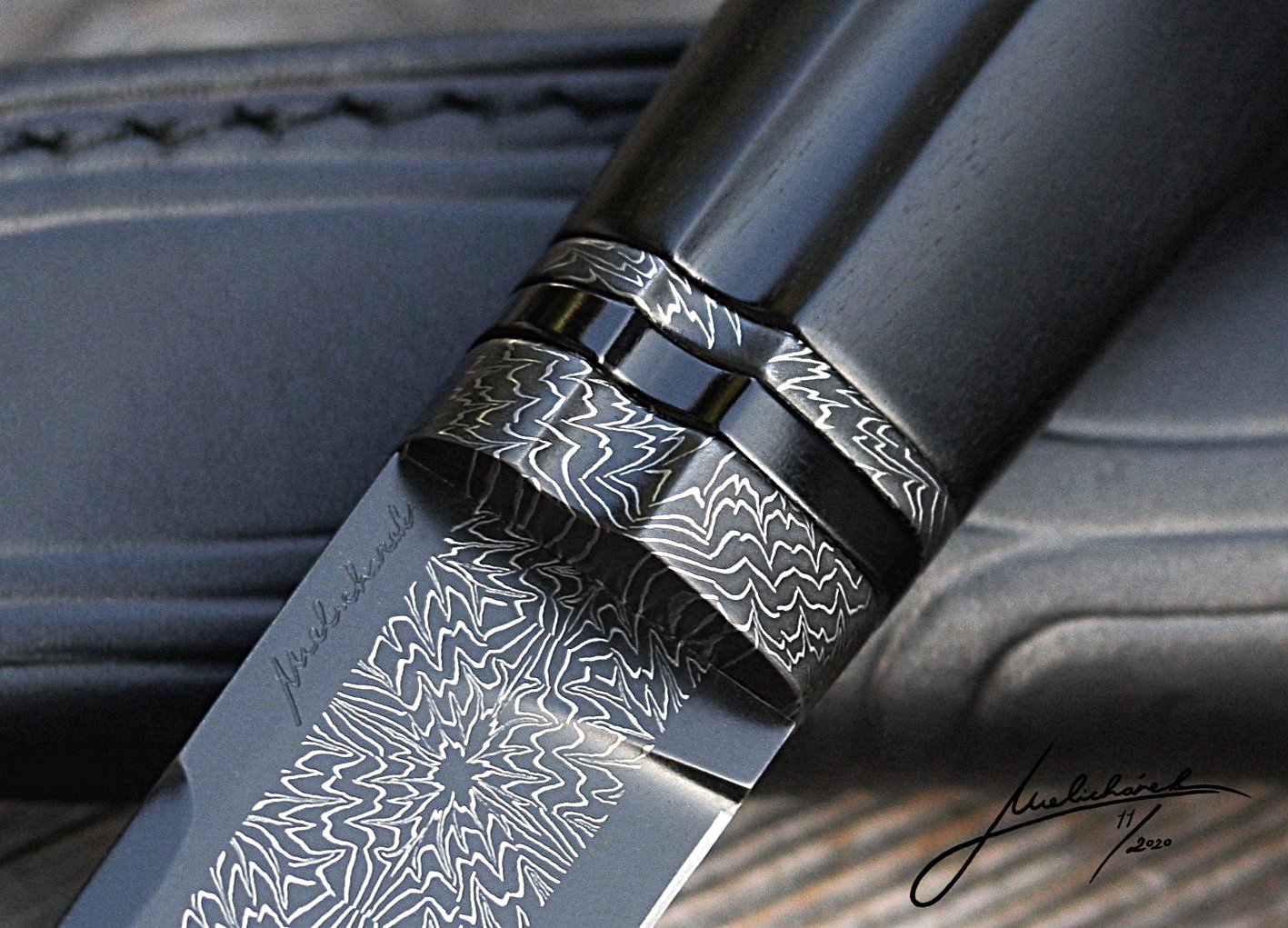

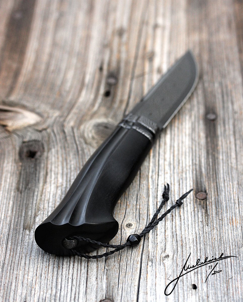

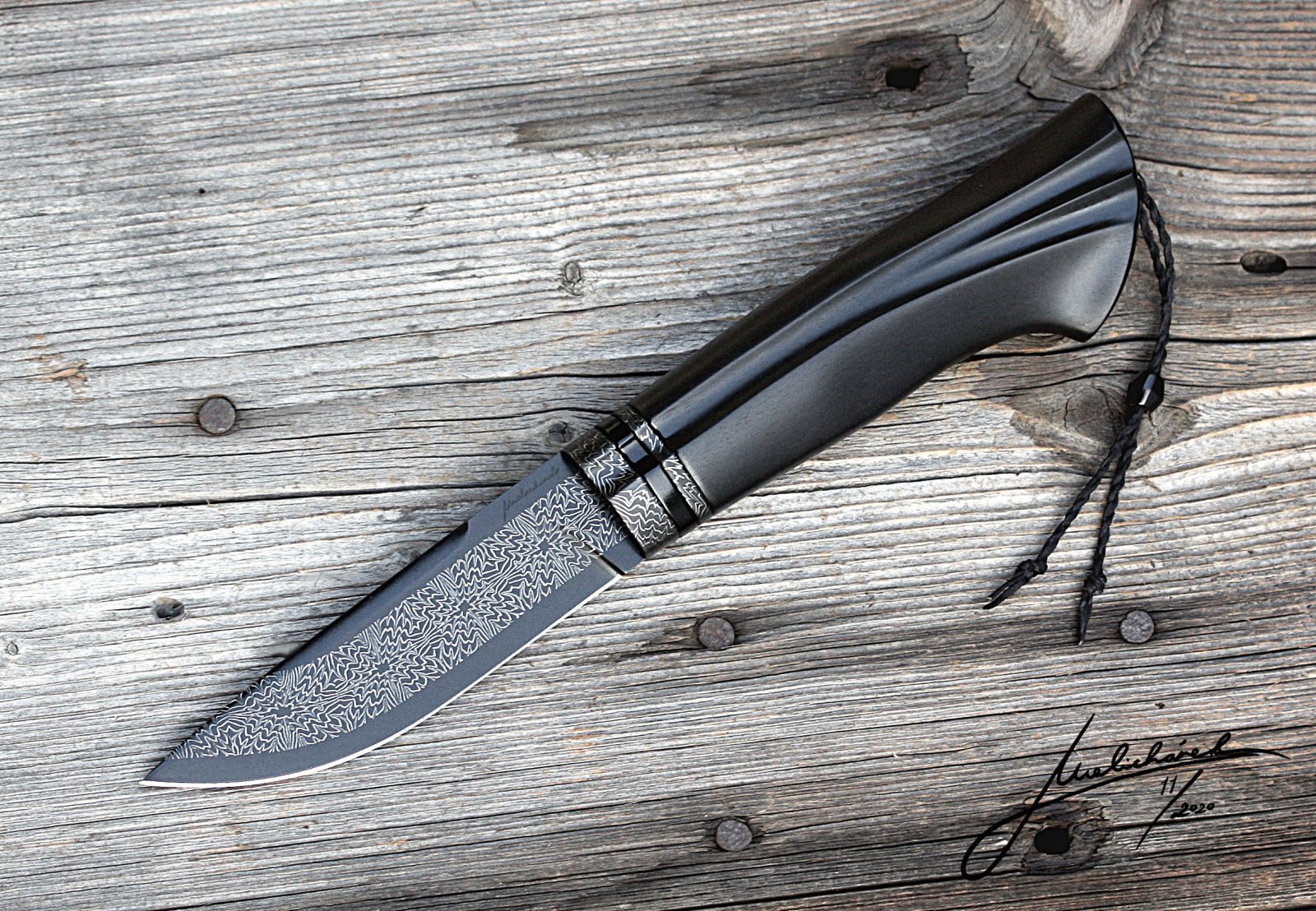

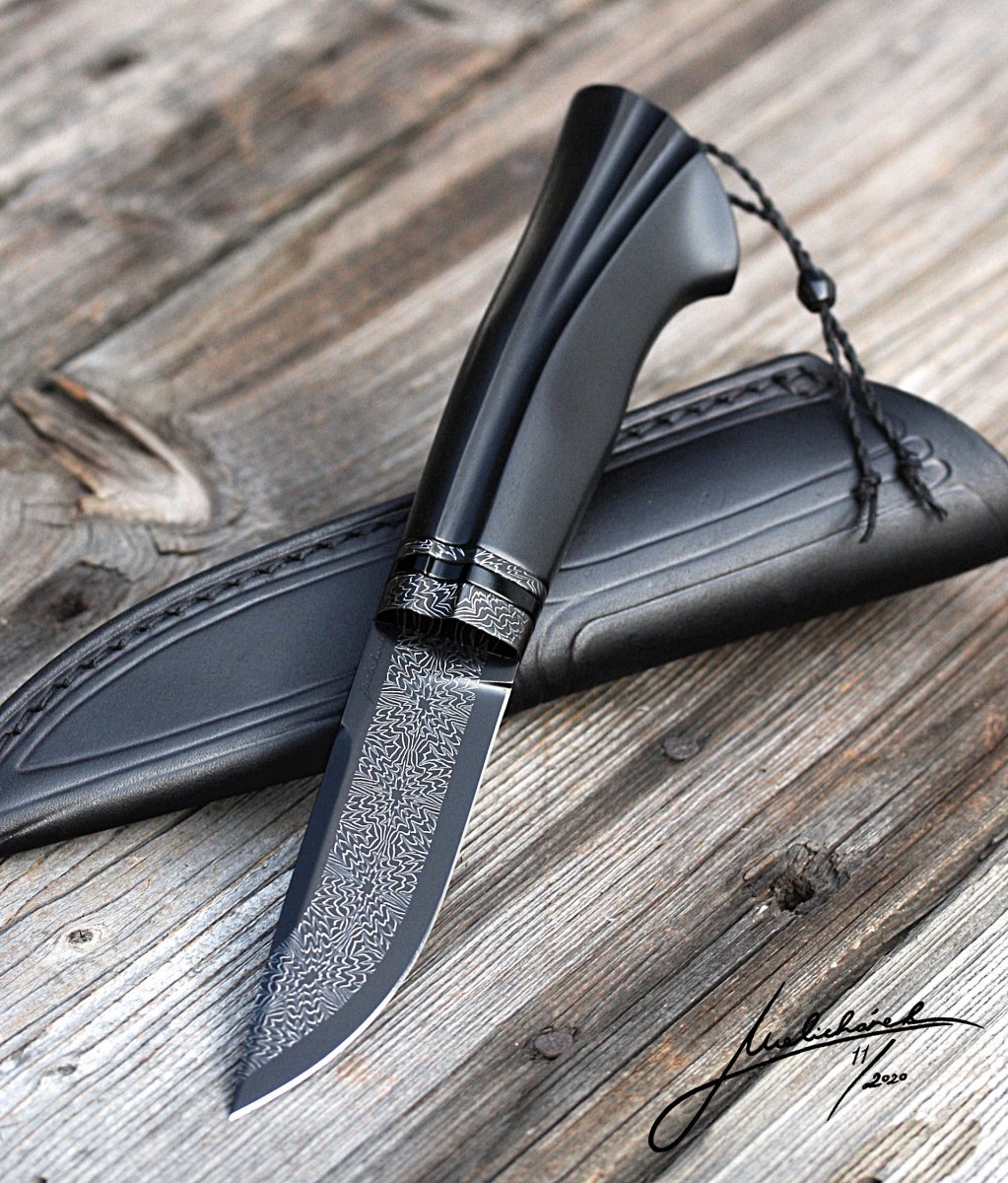

Hi everyone :)
I just finished this fluted handle "scandi" knife. It is darker than midnight in the coffin and pretty elegant i think :) . . I hope you will like it and have a nice day , Petr :)
EDIT : :confused: Please let me know if there is some problem with pictures . It seems to me that it works wrong lately :/ :( :confused: Thanks

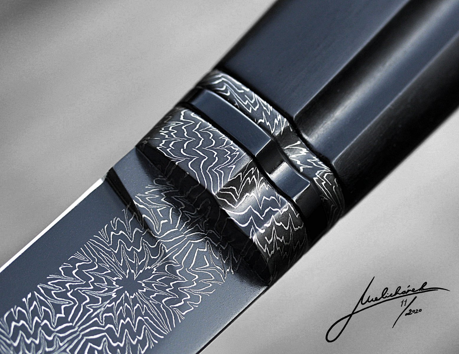

SUSUWATARI
Blade - mosaic damascus steel 1,2842 (O2) + 75ni8 Uddeholm (15N20) + edge and spine 1.2842 (O2)
Guard - mosaic damascus steel 1,2842 (O2) + 75ni8 Uddeholm (15N20) , buffalo horn
Handle - ebony
Average length - 26,5 cm (approx- 10,4 inches) , blade - 11,8 (approx- 4,6 inches).
Blade width at widest point 30,5 mm (approx 1,2 inches) , blade thickness 4 mm (0,157 inch).
Thanks a lot guys !! Im really glad you like it :) ... Happy Thanksgiving for all of you .. :)
Wooow... I am blown away.
Pictures were worth the wait.
Hmm, tho clicking on the empty space for one of them did the zoom thing and rendered it properly.
