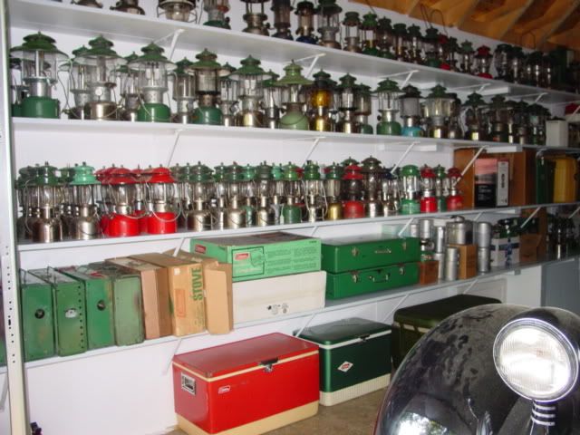

I may be biased - I collect and restore liquid fuel camp stoves and lanterns...
That is a collection of stoves and lanterns.
