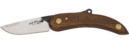

Here is what the knife looked like when I received it (stock photo)

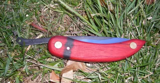

The handle was very uncomfortable. There was a sharp angle about 1/4in from the edge of the handle all the way around. I disassembled the knife and sanded the sharp corners and edges and slightly rounded the back of the handle for more comfort.

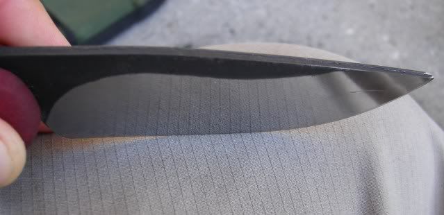

The blade was dull and very uneven. It was over heated in a couple spots and the iridescent rainbow on a few places along the edge and tip showing the heat damage. The colors went back about one millimeter. I ground down one mm along the entire length with a file and then sharpened it up to 2000 grit paper. It needed a little work but it took a great edge when all was done.

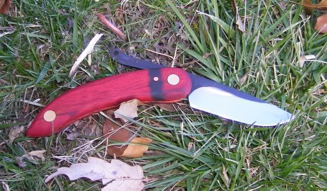

Anyway, here is the knife after I finished with it. The red and black is to match the color theme of my arrows from my last thread. I'll get pics tomorrow when its light out again of the fuzz sticks and traps etc...

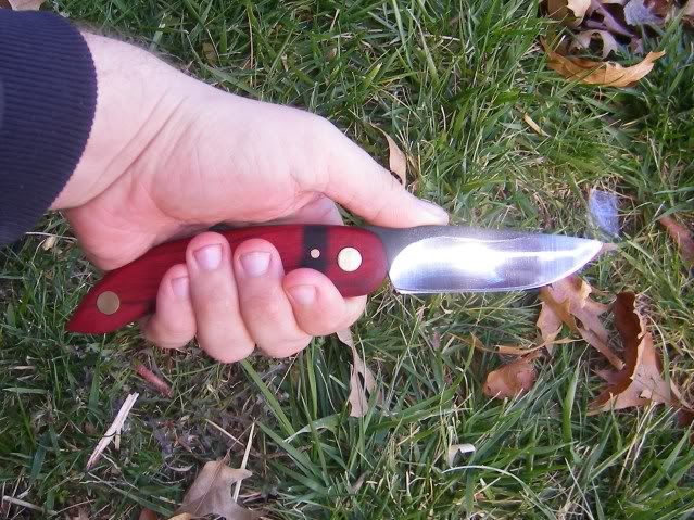

Shown in-hand for size
