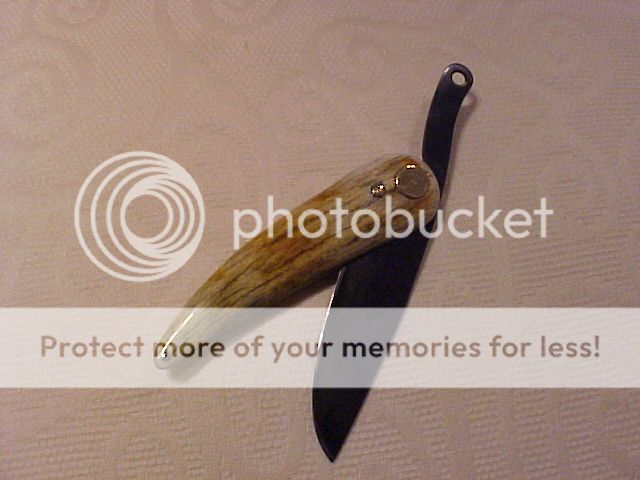

I have seen the mini in person in both plastic and Wenge wood, the large I have handled in plastic and whatever wood they use as well. The wood versions are fine, but are left a little rough. From my experience the platic ( polypropylene ) have the most predictable action in terms of how much friction to the blade is present. They are relatively easy to replicate wooden handles for...I used a 3/8" Forstner bit to cut the scew recesses with. I have had very good results using a brass spacer in the butt of the knife and pinning/glueing the frame together.
Buffalo horn is another great handle material for these...
of course this was a more complicated build...
Be safe, and have fun! At the worst you can always put the blade back into the original handle...

You can use the screws but you will still need to add a stop pin. Peasants are great knives to mess around with because they are simple and inexpensive. If you mess it up the first time you can always try again. :)
You can get as fancy as you like with these, blades are great but most of the handle types are so so.
Richard
Sitflyer that is a kit knife I can appreciate and afford.
That wasn't quite a kit knife... It's a custom re-handle Duane (sitflyer) did, using some slabs of buffalo horn and the blade from a Peasant. Looks pretty slick, you're right. ;)
Tinbasher, those are spectacular!

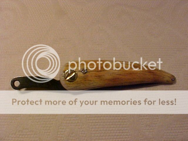

Another viable option is to get a wooden handle version and shape it to your liking...
the wood on mine took on a very pleasant look when sanded up through the grits, but I woul NOT recomend cutting the tang as short as this one!
I went with the blue polypropylene handle for my full-size Peasant. I wanted a working knife for gardening and yard work, and it works great. The blue stands out if I leave it in the grass, since I haven't gotten around to making a lanyard for it yet. I would not recommend cutting off the extra length on the tang until you've used it a bit: I thought it would be obtrusive and get in the way, but it makes it easy to one-hand open by pressing against my leg while holding the handle.
