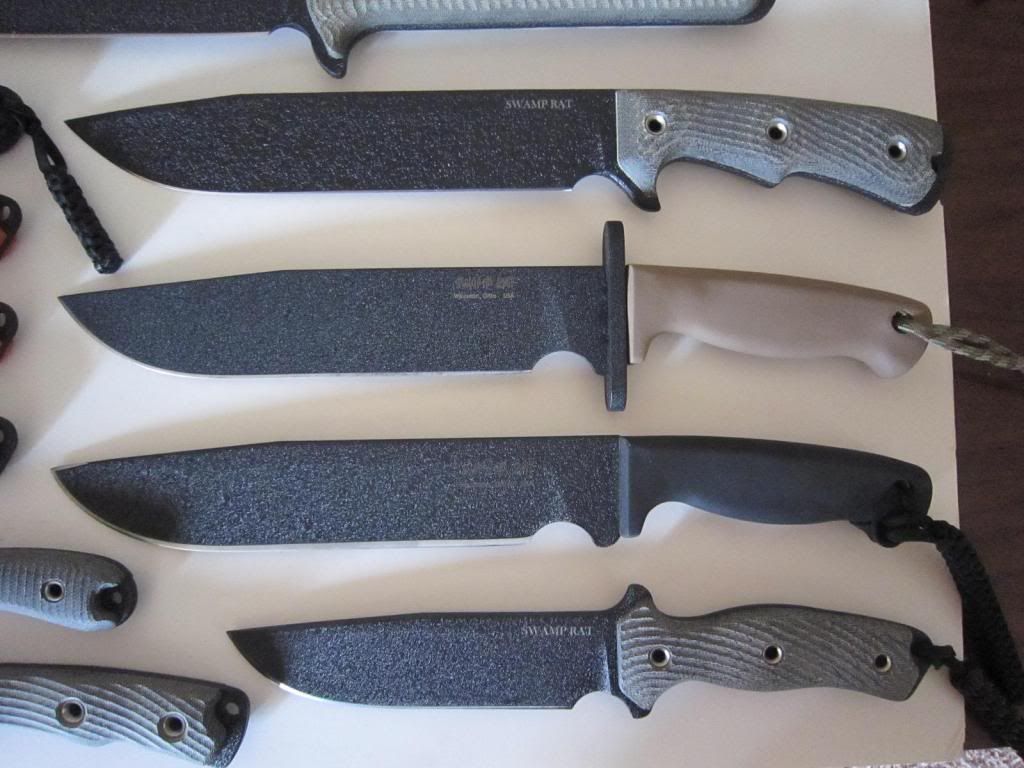

The Battle Rat AND the Battle Guard are both differentially heat treated gentlemen. The tan handled black coated Battle Rats were the through hardened models. I think the Battle Rat is my favorite Bussekin knife of all time. DAMN bold statement, but its just perfect in my eyes. Not too big, not too heavy, differential SR-101, Res-C, and that old school black crinkle coat is impossible to wear off!! I will certainly take one to the grave with me.

Ohhhhh man, that is a hell of a lineup Russ!! You don't see too many Battle Guards around these days :cool:
