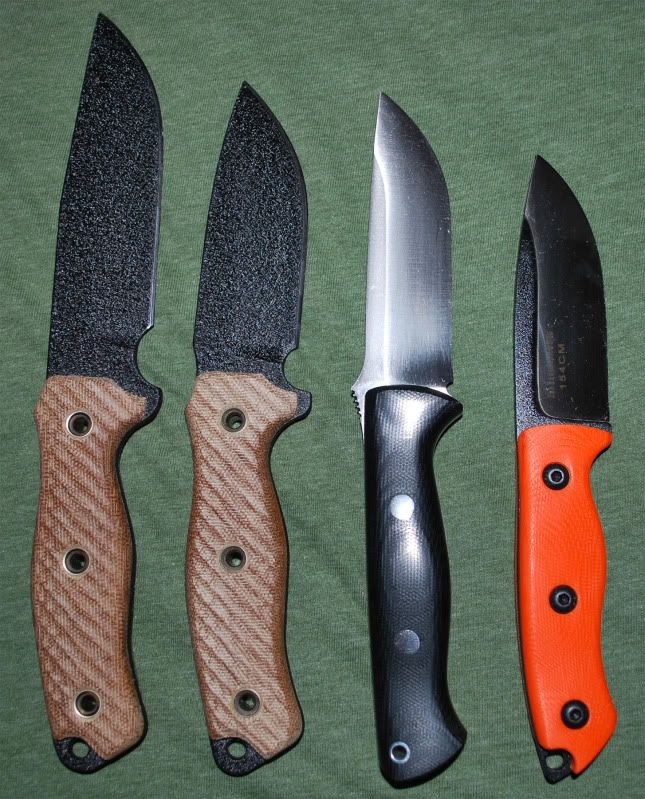

IF I had to choose I say HRLM, if I could add in the STS, I'd go with the STS... here is a pic of my outdoors/hunting larger fixed blades (I only kept the RMD, and regret selling the STS3). (another few to consider if you didn't already look at them, the Bravo, fox river, and the Gunny).
