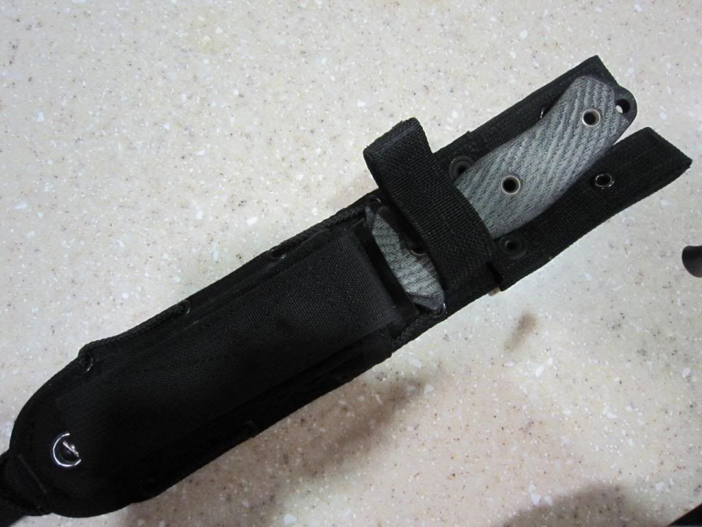

Referring to a R6 fitting a small Spec-Ops or not that’s a resounding YES IT DOES and very well by the way.
1st pic, R6 sheathed.

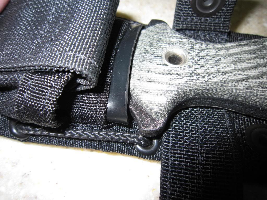

2nd pic, a better shot of R6 seated in liner throat.

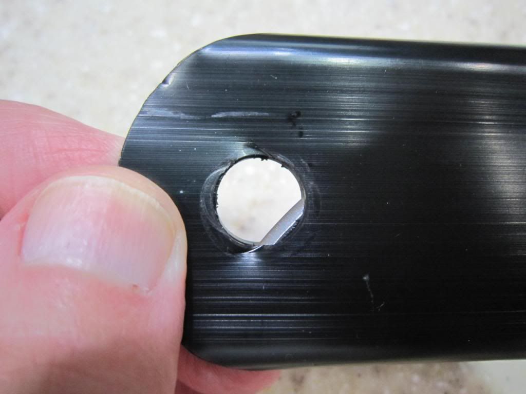

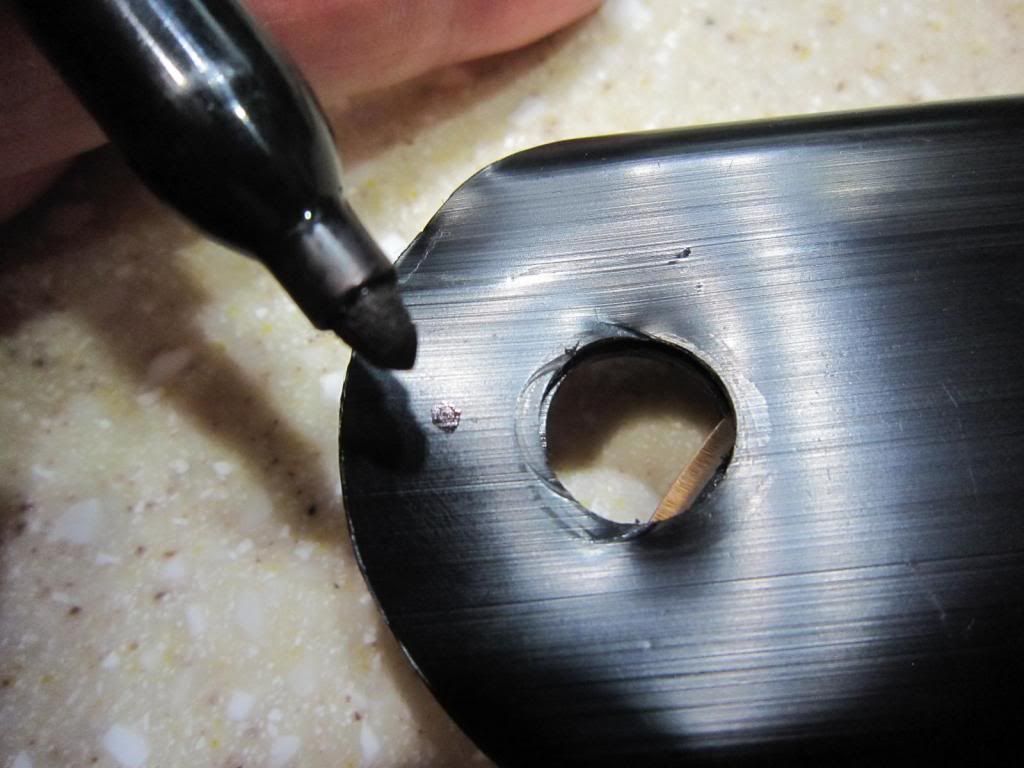

5th pic, if the location of the edge bothers you then this is what you do. Mark a spot ½ way from the edge of the liner and the starting edge of the factory hole. MARK IT! You can use a 7/32nds, 15/64ths or even a ¼” drill bit. Make sure the bit is SHARP. Drill through both side of the liner and WAH-LAH, problem solved. Now reinsert the liner and replace the screw. I guarantee the tip nor edge will contact the screw post.

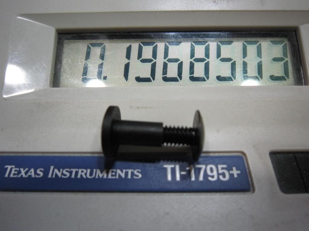

6th pic, this show the OD of the screw barrel being .196 If you think about it that is also 5mm.

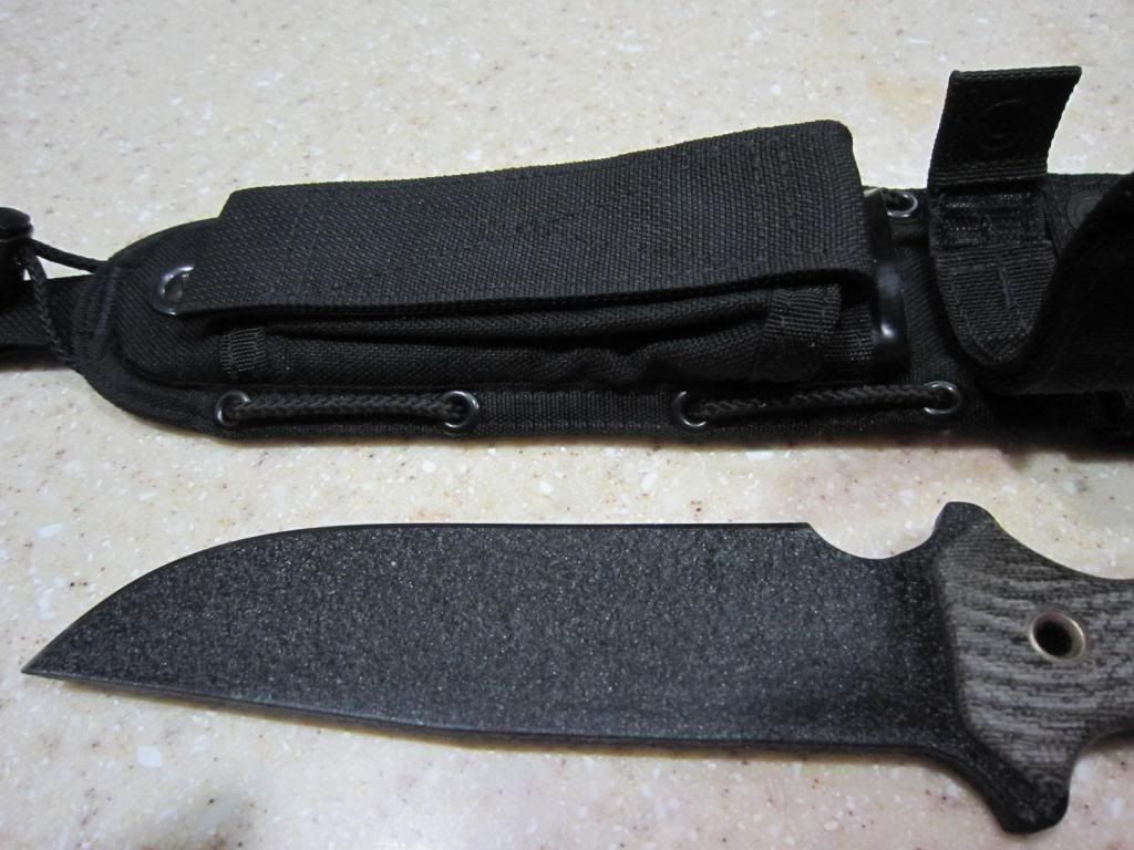

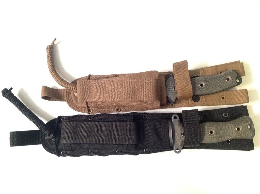

I did not go for the MO because it's dimensions were right on with the R6. When my R6 first arrived I tried it in the smaller Spec Ops Combat Master and it fit.
Older photo (posted before).
Yea agree big time. Mine didn't require any modes either. I just showed those pics as an example to explain how you can make a small adjustment to a length w/o much ado. Still wish Spec-OPS MADE THE master sheath with the bellows aux pouch. Could get more items in that one.
