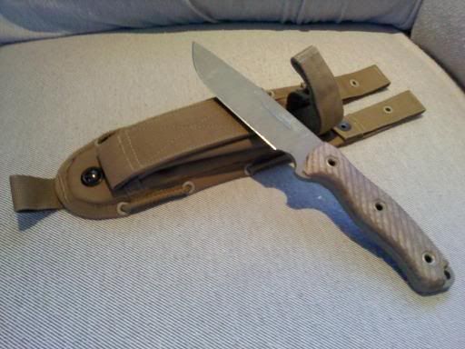

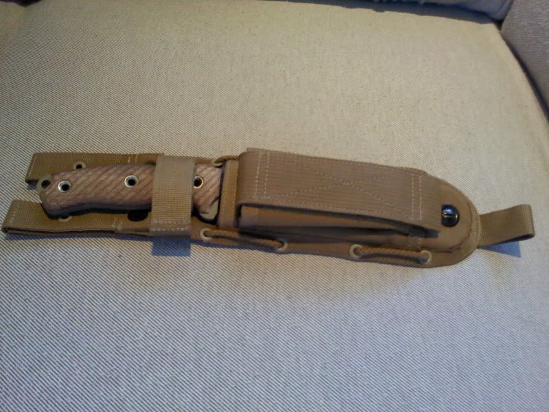

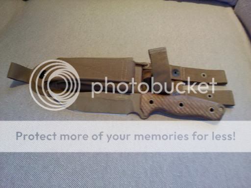

The RMD fits very well in a short combat master sheath.
Thanks, Chingon1988
Did you have to modify kydex insert so that it wouldn't rattle?
I remolded my insert due to an already present bend in the entire length of the plastic (came that way). I borrowed a heat-gun from a neighbor, plied her up and straightened her out (wear gloves for ease of handling), then molded the length tighter to the blade and the lip around the beginning of the micarta handle so that the kydex openning is somewhat flared to allow the knife to slip in easily and sink a little deeper into the sheath (the snap secures slightly higher on the handle). The result is excellent, no rattle.
The insert-opening on my sheath was ~1/4" thick, the RMD ~1/5". I did experience some rattle prior to proper molding, though other inserts might fare differently. If you have a heat-gun or toaster-oven, it's an easy fix (60 seconds).
