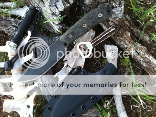

Here is a pic (taken a while ago, and I don't have it with me to take a better one, sorry) of my Game Warden that I put the Torx screws in
This one is actually kind of cool, because this isn't actually the knife I drilled out the rivets to swap in screws, I drilled out the rivets on another GW and stole the scales off of it to make myself a SLUT Warden of sorts.
The scales came off of an Urban Grey Warden that I got a smokin' deal on and bought as a scale donor because I didn't really (or should I say really didn't :p) like the color. It is here with some of my other Wardens.
Actually drilling the rivets was fairly easy, I just used a cordless drill with a 1/4" bit and took my time. Once the flare was off of the rivets, I carefully pried the scales off and had to use pliers to get the rest of the rivet out. Easy. The screws I had to shorten by a few threads, so the belt sharpener made quick work of that. If this affects the warranty, so be it, I'm not gonna do anything to a GW that will hurt it. That's what the Mistresses are for ;)
