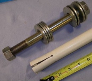

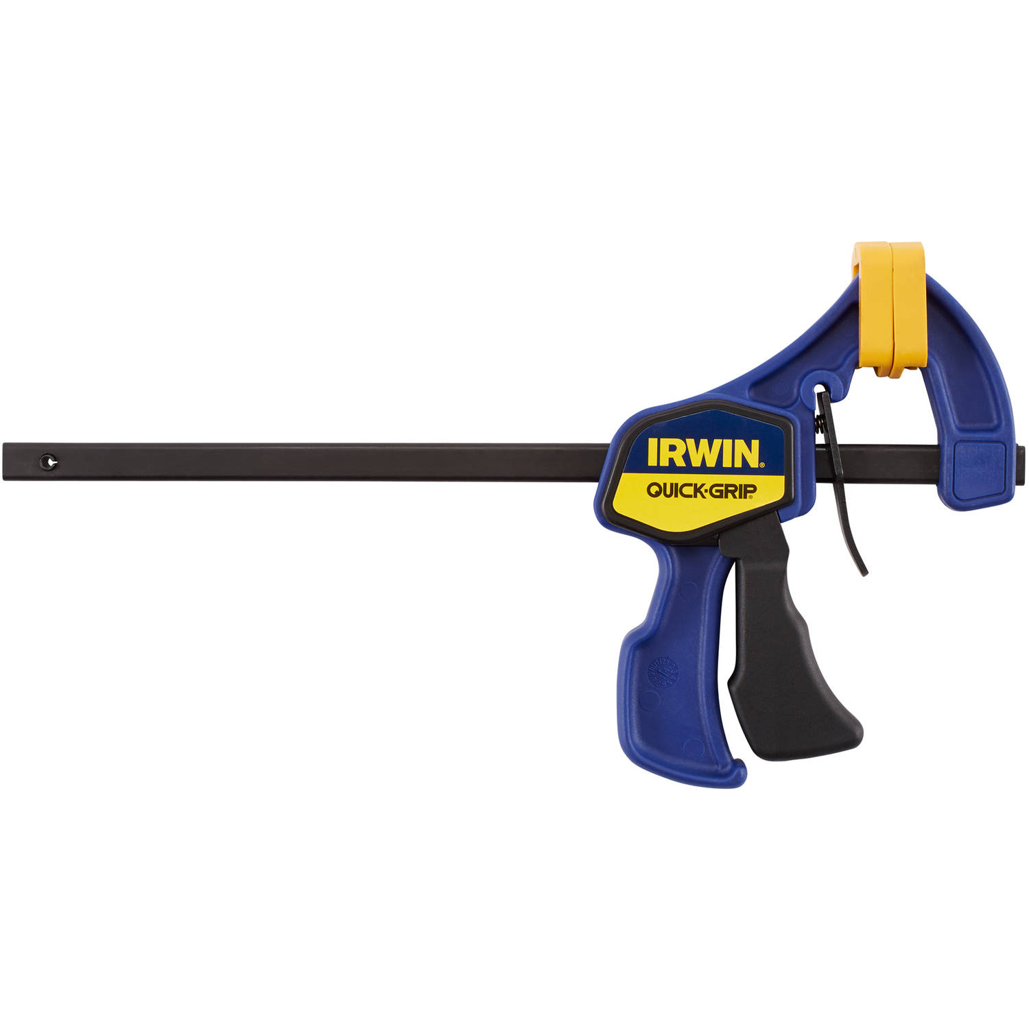

Be careful! You can crack the g10 if you muscle it wrong. Try and wiggle them on just enough to start them and get them to bite inside the hole. Then you can try a small bar clamp [1]that will squeeze the scales evenly around the hole. The problem with using your hands, is that it is so hard to apply pressure evenly. Or you can make a homemade press with a couple washers, and a nut and a bolt[2]. Just be sure and use a fully threaded bolt that is narrow enough to fit through the lanyard hole without scraping.
[1]
[2]
And above all, work slowly and patiently. If you do it right, there won’t be any chips, cracks, or rattles concerning the lanyard hole. Keep us posted and can’t wait to see pics when you’re done!
