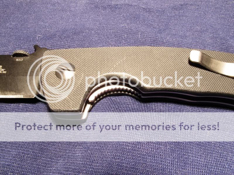

The finish was nice, like this all over:
But I sanded alll the edges smooth, and sanded the whole thing while I was at it.

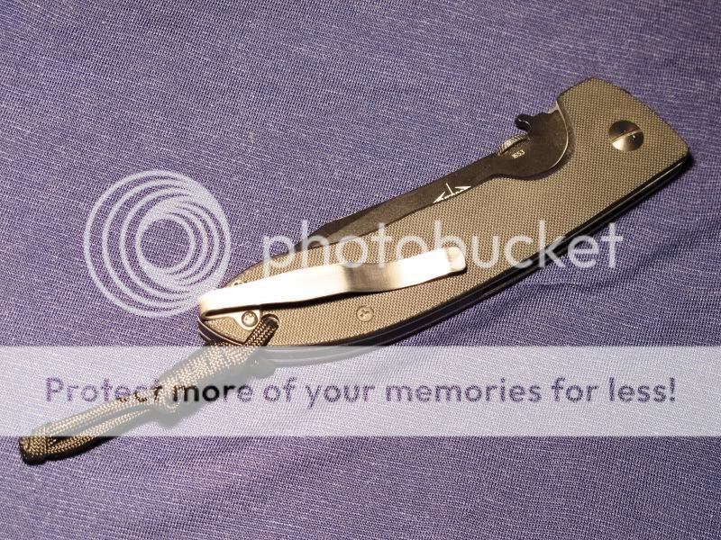

Got the clip installed no worries, drilling and tapping was easy as expected, done it before on RC Heli's etc.

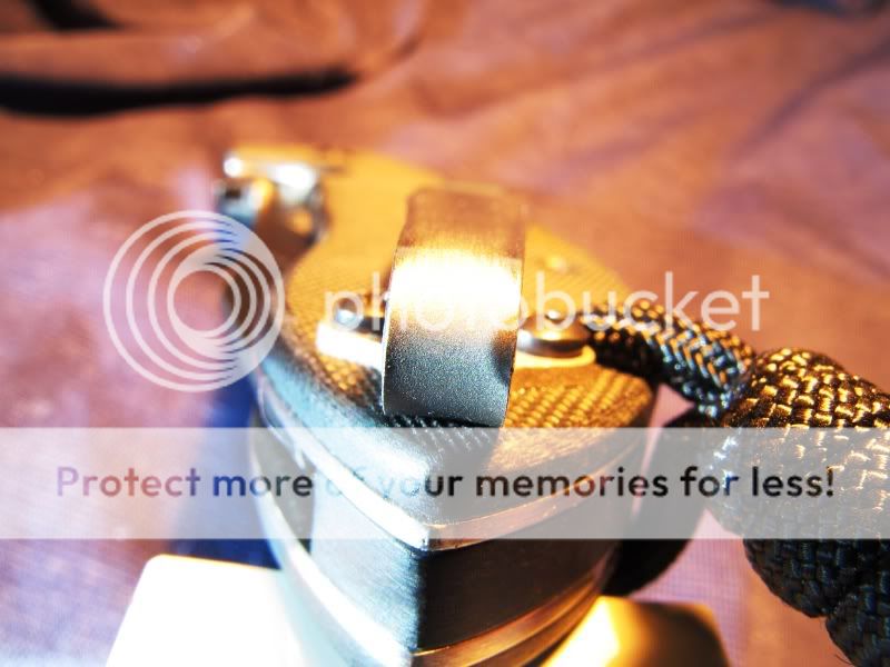

I love the clip, exactly what I wanted. Thanks STR! The knife sits flush with my jeans pocket and the lanyard makes for easy waving still. Took me a dozen goes to get a lanyard length and dimensions I was happy with in all situations. My last 2 fingers fit perfect in the gap between the twists and the knot.
Had to be careful with positioning the clip, got extremely close to one of the other screw holes coming through from the other side but it worked out great.

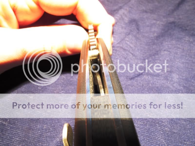

Not long after I got the knife I ground then sanded the G10 and liners a fair bit to give more relief around the thumb disc and especially the lock release to make it easier to get to. I also removed all the laser cut marks by sanding.
Later I sanded the jimping on the liner lock release a bit to make it less hard on my poor delicate fingers. I must love sandpaper. I waved and closed it over 1000 times the first week and it was extremely hard to unlock sometimes. It unlocks with consistent pressure now and locks up perfectly, halfway across.

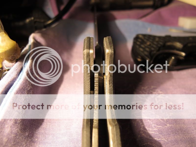

I took pics when it was new after waving and counted the first few hundred openings:
Brand new, first hard wave:
Note the uneveness between G10 and liners from Emerson, promting me to get sanding.

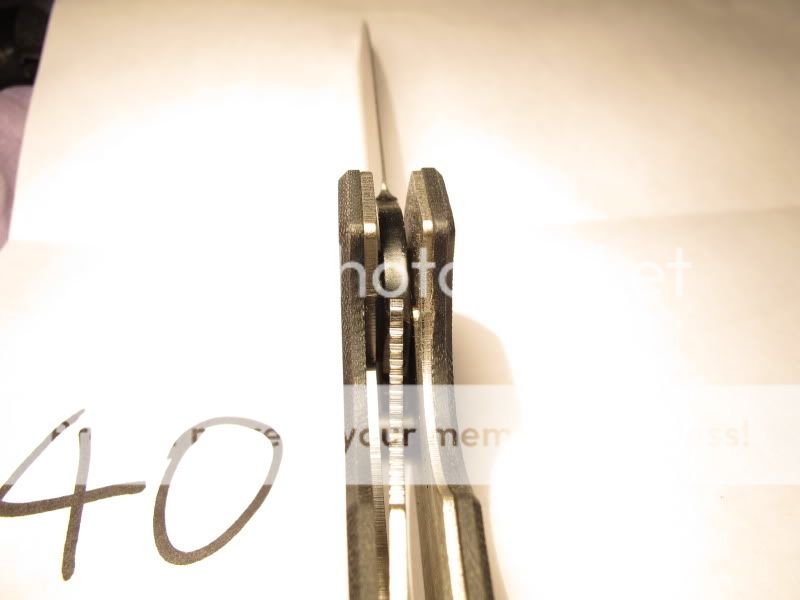

40 hard waves:
By 100 hundred it was nearly half way, bby 200 it was bang on half way and has more or less stayed there.
