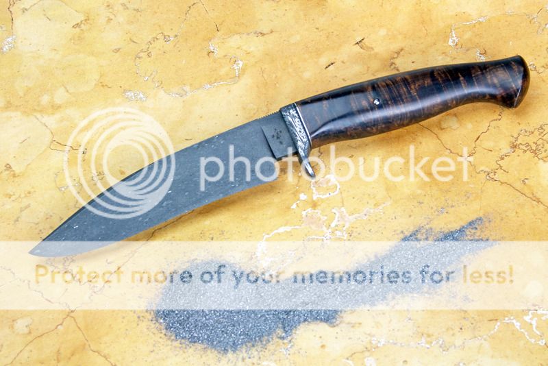

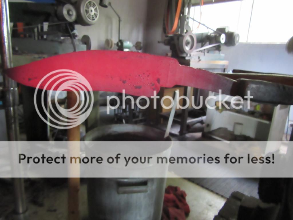

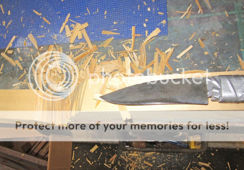

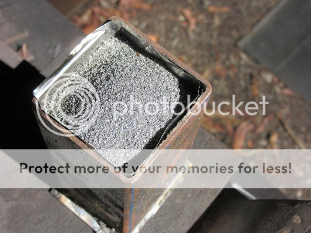

You might recall a knife I posted recently called mystery fighter, made from off cuts and bandsaw swarf. Well while I was at it I made a billet just out of the bandsaw swarf (hence the name). As you can see from the pics I tested it, the small cuts are due to the fact my temporary handle was very uncomfortable :( No nicks in the blade and shaving sharp afterwards). I parkerised the blade because I did not like the look of it. There are no inclusions or faults in the steel :)

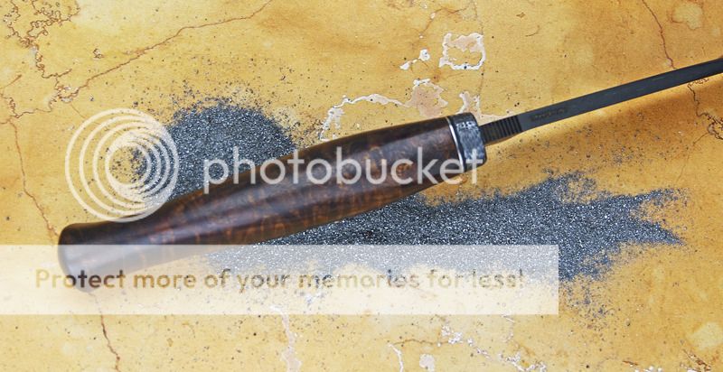

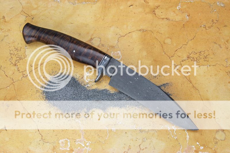

Specs: BL 5 1/4", 134mm. OAL 11 1/4". Damascus guard with G10 and stainless spacers. Ringed Gidgee handle with domed pin. Looking for a new home once I've made it some pants to get around in.
Thanks for looking and comments welcome.
Cheers Keith

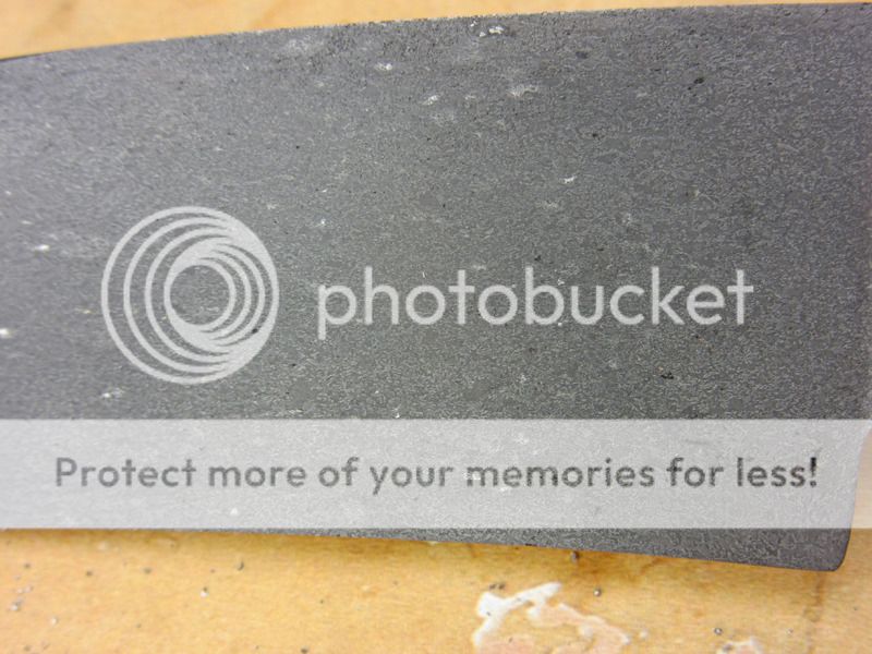

Here is a close up of the steel. What do you think?

Keith,
I like it. You probably have an idea of what you've been sawing most and what the carbon content should be. The main thing is how well it hardened.
I've done a lot of can mosaics but always used a 1084 powder so I salute you for being creative with this one.
I noticed that you lined the can. Aluminum foil?

Thanks Gary. The mix is mainly 1075/1084 and 15N20, maybe some O1 and W2. It hardened very nicely. I lined the can with stainless steel foil. Easier to cut the can off.

That is too cool. I think the steel has a bit of a Wootz appearance to it.
That is very creative, wish we could see more works like that.
How long would you guess it took to accumulate that much saw dust?
Thanks Big Chris, Yeah I geuss it does have a Wootz look. How long to accumulate, Hhmm. Well every time I make damascus and accordian or tile cut I just collect the dust on a piece of paper. I have a fair amount of it. I'm going to make some flat bar out of some of it and incorporate it in a billet. Could be interesting I reckon. Thanks again.
