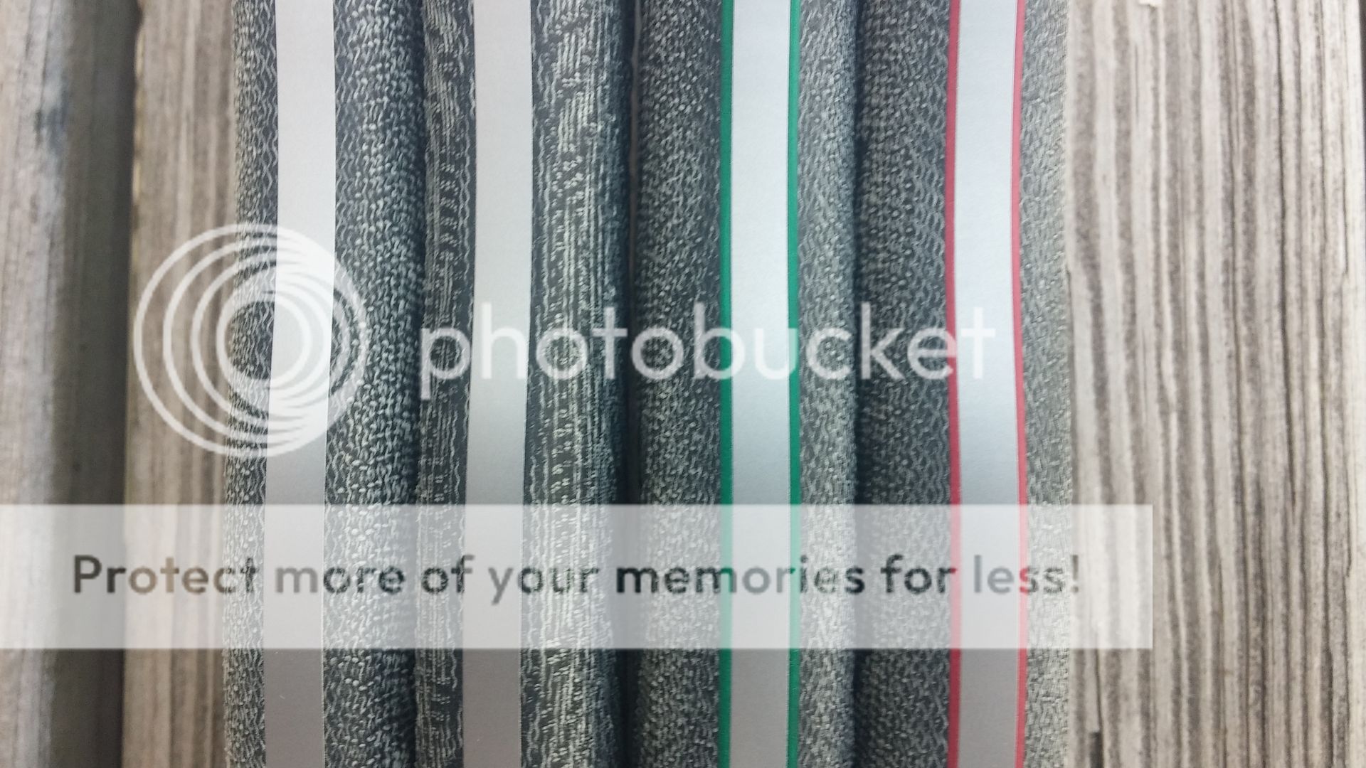

Notice the red liners on the SWAT? Feels awesome in hand... love that knife!
Below are a few SWATS two with and two without liners...

Also worth noting for anyone comparing the two are the different patterns on the g10 handles. Shown very clearly on rickshooters pics with the two bruisers side by side. Can someone confirm if all are different or only g10? Do the micarta handles look different as well?
