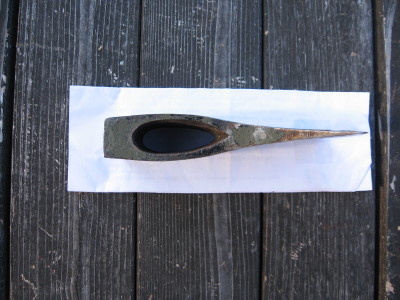

I was getting some stuff online and saw a "new" offering of a smaller military axe, which looked interesting so I added one to my order. Buying used military axes sight unseen is a bit of a gamble, since there can be variations from what is pictured in the ad.
Here is the one that I was sent, after I did a little work on it. The head is stamped "KB42", and I think the axe looks pretty good for being 69 years old.
Head measurements: 6" by 3.5"
Head weight: 1 pound 13 ounces
Length: 25"
Total weight: 2 pounds 8 ounces
Without looking it up, I think the weight and length are pretty similar to the Scandinavian Forest Axe, but in this case it cost me less than $20. (Plus some work, but that didn't cost me since I did it during my "free time".)
I know the head weight since I removed it without damaging the handle (more on that here). Here's the profile from above:
What else to say?
The handle had no splits.
The grain alignment was virtually perfect (for what it's worth).
The head balance was good.
The head alignment was very good.
Here's the axe as I received it. I later took off the head and applied some soy-based paint remover which took off the green, leaving some black oxidation on the head (which I left on). I didn't use vinegar and only did some light filing and sanding. I obviously also sanded down the handle. I'll do some more work on the edge before I re-wedge the head.

How do you feel about the hole in the head? When it is all said and done, any impact in performace, etc, overall?
...How do you feel about the hole in the head? When it is all said and done, any impact in performace, etc, overall?
I don't think that the hole will be detrimental. I asked Peter Vido about this, and he agrees.
Maybe the supplier made a batch of axes that were a tiny bit over the spec weight, so they had to get rid of some weight somewhere. ;)
If not for simply hanging on the wall, maybe the hole is for racking/stacking/packing a bunch of axes on a rod of some sort.

I've been interested in this piece but I found an unfavorable review from Mike Hotel on his blog <http://thesharpenedaxe.blogspot.com/2011/09/swedish-army-axes-from-sportsmans-guide.html>. He says the steel is too soft. Not sure if he got a lemon or if he's right. Have you tested it out?
Really it is difficult to judge because those axe are surplus that was collected other the years so you probably get a mix of various makers and various specs, also the axes may have seen some abuse by bored conscripts or wrong handling (like sharpening with power tools).
About hole in the head, I'd think this would be related with hanging it on some vehicle or something like that.
My axe seemed OK, but I haven't totally finished and used it yet, too many projects on the backburner.
I agree with Ravaillac that someone down the line might have been too heavy-handed with the bench grinder and ruined the temper. You're taking your chances with used military axes. Some real bargains, some not.
A friend of mine bought several of these axes and about half of them had handles about 3" shorter than the one I got (which I think is more in line with how they are advertised). Most had evidently been rehafted but some of these had the eye not totally filled with wood, and with a single metal wedge about half as wide as it should be (didn't run the whole length of the eye). Not quite the "like new" as advertised.
