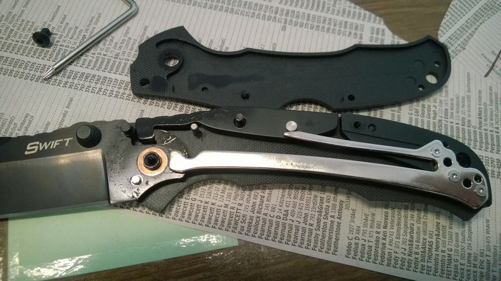

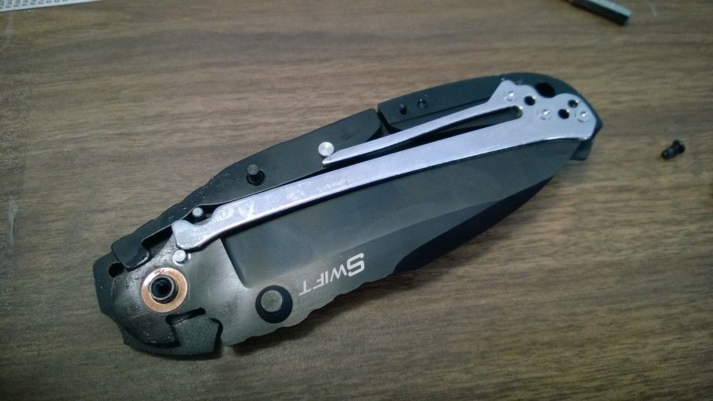

Got my Swift 2 and have been playing with it a fair bit. I am quite impressed with a number of aspects of it. I was really curious about how the assist would work and so I have taken it down and the system is actually real genius. They have used one piece of steel to serve as the spring for the lock bar and the assist it's quite heavy but also located in such a way that it still allows for one handed operation (like a Kershaw). The only down side would be it's not really possible (not easy anyway) to deassist. Here are the pics:

After seeing the pictures, I thought perhaps it was the face on the spring that rests against the pin, or maybe something in the pivot.

Many thanks for the pics, kevin. :thumbup: I could see the silver plate down in the handle of mine (the spring), but I couldn't quite figure out how it engaged the tang, and I didn't want to take mine apart right off the bat, so these pics are really helpful. :cool:

I guess if you had to de assist it you can cut the assist bar off in front of the 2 torx screws that are holding the whole bar in. I didn't realize 1 scale is hollowed out to allow for the assist bar.
