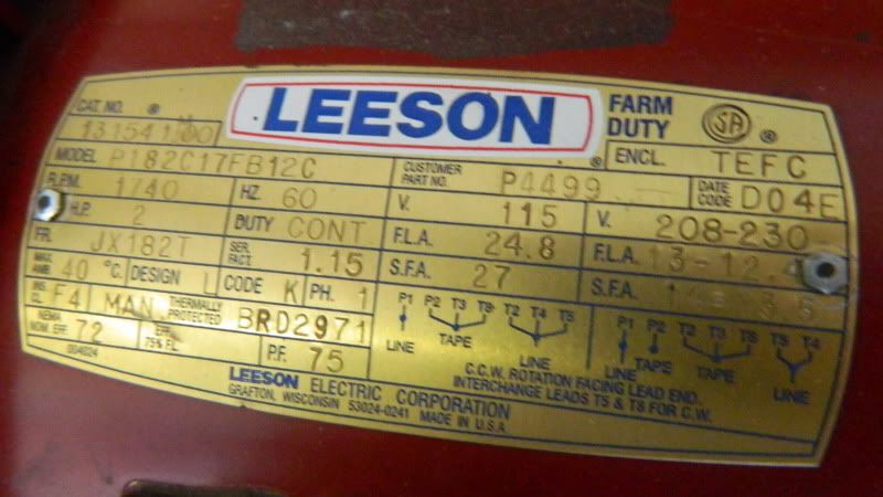

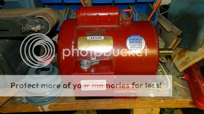

I have this motor:
I would like to wire it to 220V.

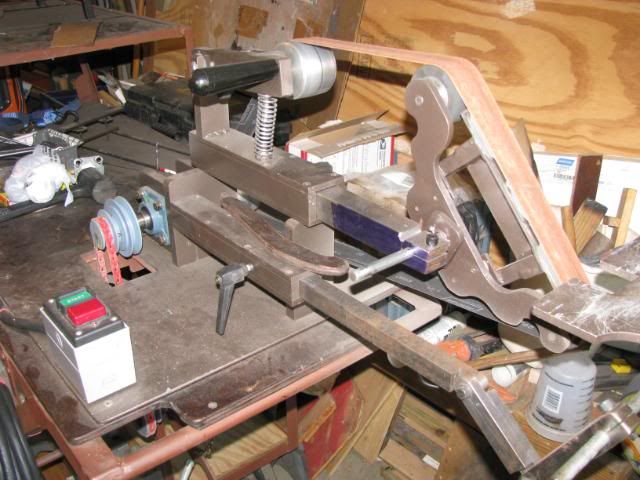

I used this switch and put it in a double box to accommodate the height of it!
http://www.grizzly.com/products/110-220V-On-Off-Switch/H8238
Here is a pic of my set-up.
If you look closely on the left side you can see the cord, I think it is S instead of SJ but would have to walk out to the shop to verify and I have my Grandson this morning so can't turn loose but, a good supply man will set you up with the best for the need if you explain what you are doing.
