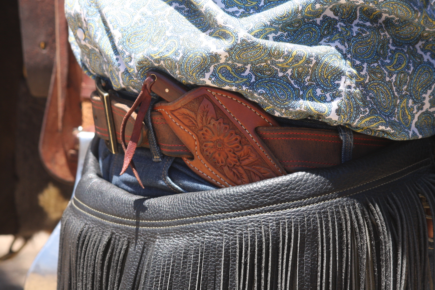

Here''s what well used flower carving can look like with quality leather and the proper depth of swivel cuts. This sheath belongs to a good friend Janene. She is a professional horse trainer, ropes with us (she and Nichole have two big competitions coming up this year) and helps on the ranch. This sheath has been worn continuously, worn and exposed to all kinds of abrasion and pressure etc. From saddling horses, doing groundwork on the ranch, putting the ice chest in the back of the truck, just life. One of the competitions that they will be in requires the competitors to do their own groundwork. We've been training the ladies up every weekend. Point is that carving done well can be used and be durable.
