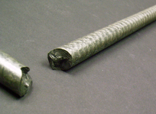

I've made sticks of Delrin and of Nylon 6/6 MDS. The Nylon 6/6 MDS is very tough material, but occasionally you'll get some rod stock with an internal flaw -- and it will break:
