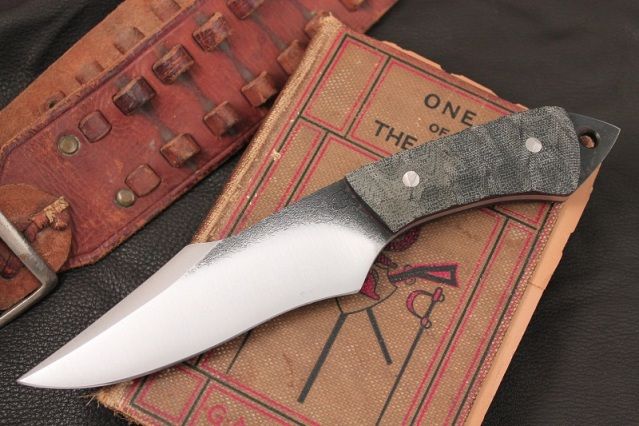

This is another custom order I just finished up.
It is a Persian stlye blade based on my Tac bowie model.
The OAL is 10", with a 5 5/8" blade of .214" 5160. The handle is scalloped black canvas micarta with red liners. It will be getting Kydex when my Tek-loks come in.
Any comments are welcome!
The lines are of course rad, but I especially like texture and gray tones. How did you achieve the gray texture in the blade? Do you do a lot of ricasso-less blades? What would I knife like that be used for?
Phil, the gray on the blade is just mill scale left on the flats of the blade.
Up until recently, I did all ricasso-less blades.
This was custom designed per with the customers input.
It would be very usable for most tasks, and could be one heck of a fighting knife!
