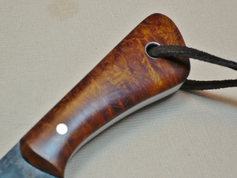

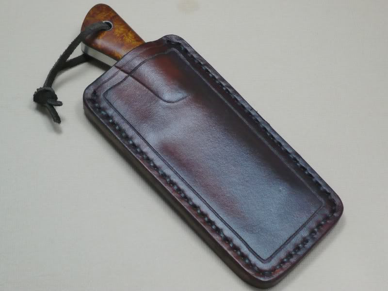

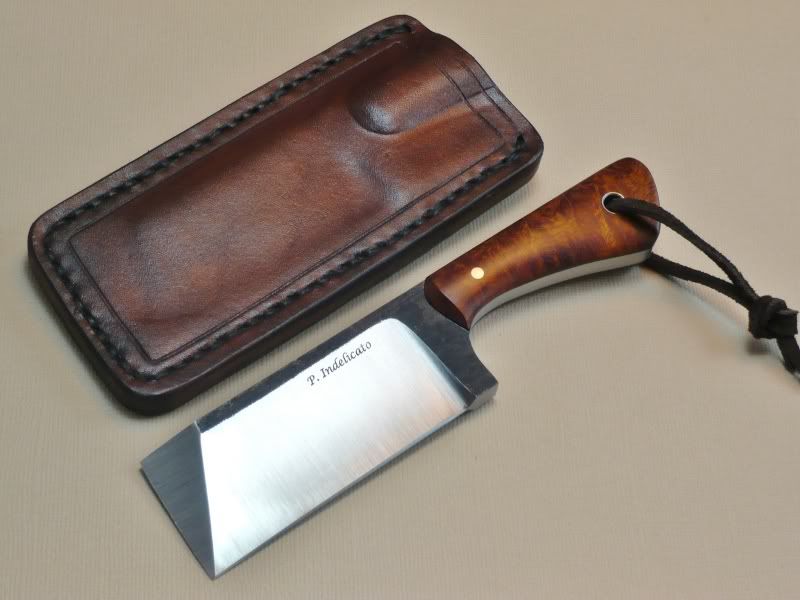

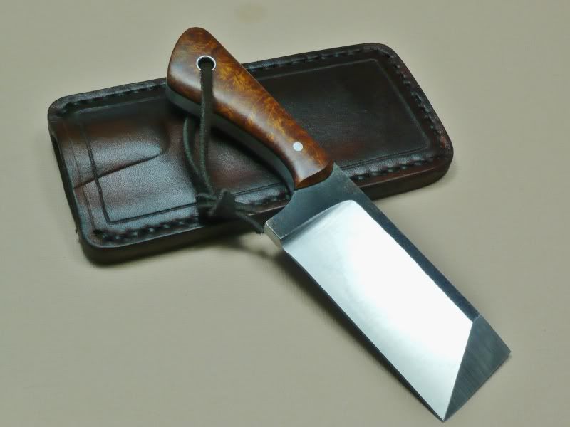

I just finished up an order for a fellow forum member for one of my Tactical Pocket Cuties (so named by the customer who purchased the first ones I made), a Dress Tactical Pocket Box Cutter model. Comments and questions are welcome; thanks as always for viewing my work!
-Flat ground 1/4" 5160
-~3" blade, ~6" OAL
-3 finger tang w/ beautiful slim Desert Ironwood burl scales, black G-10 spacers, SS pin and thong tube
-Mill scale and heat treat coloration were left intact on the flats to contrast with the machine finished surfaces
-Sheath is a dark brown handsewn and wet-molded Wickett & Craig Premium cowhide ambidextrous pocket sleeve
I really struggled to capture the depth and detail of the figure in the Ironwood burl scales for some reason...the pictures in this case just don't do them justice.
