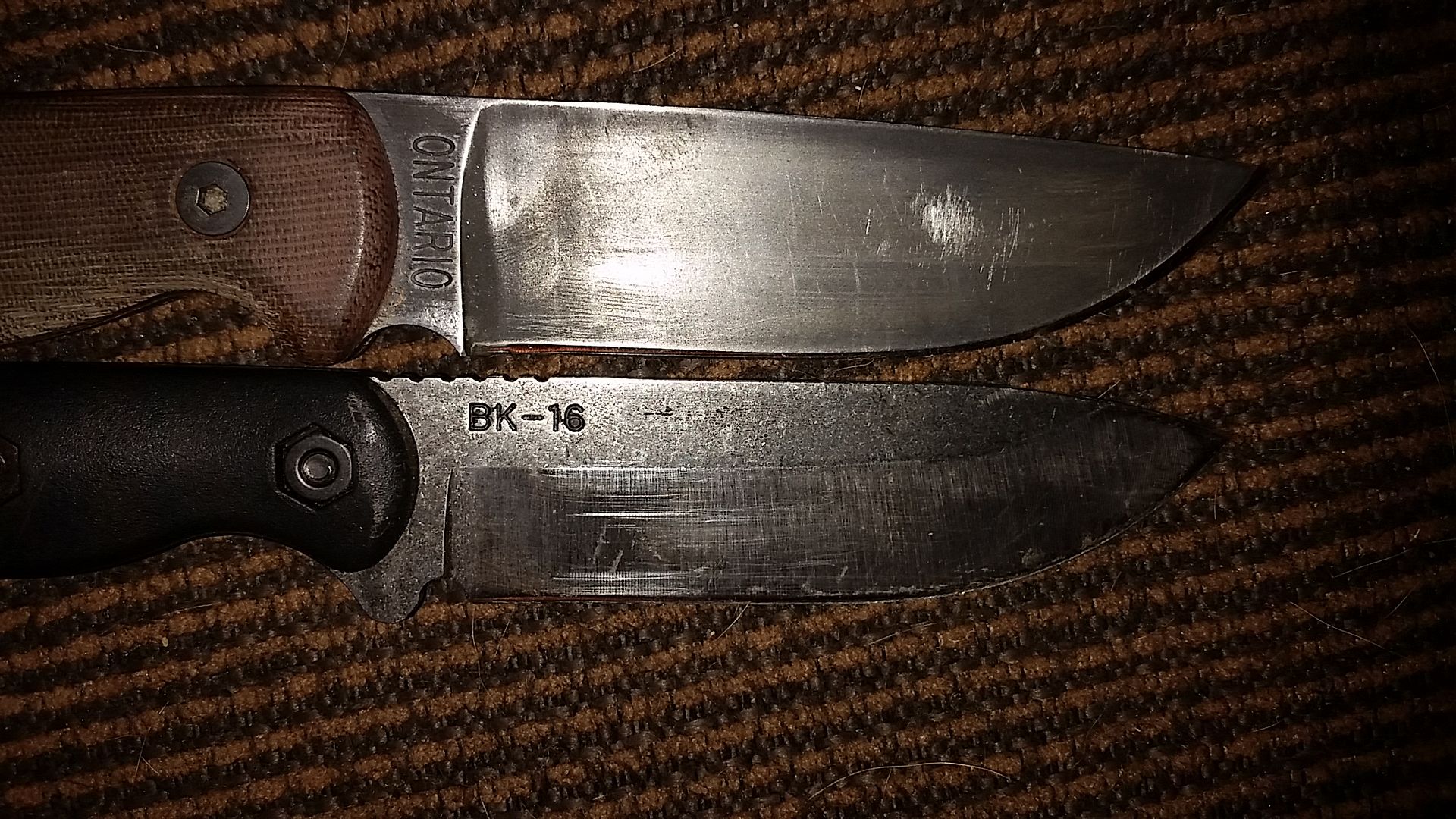

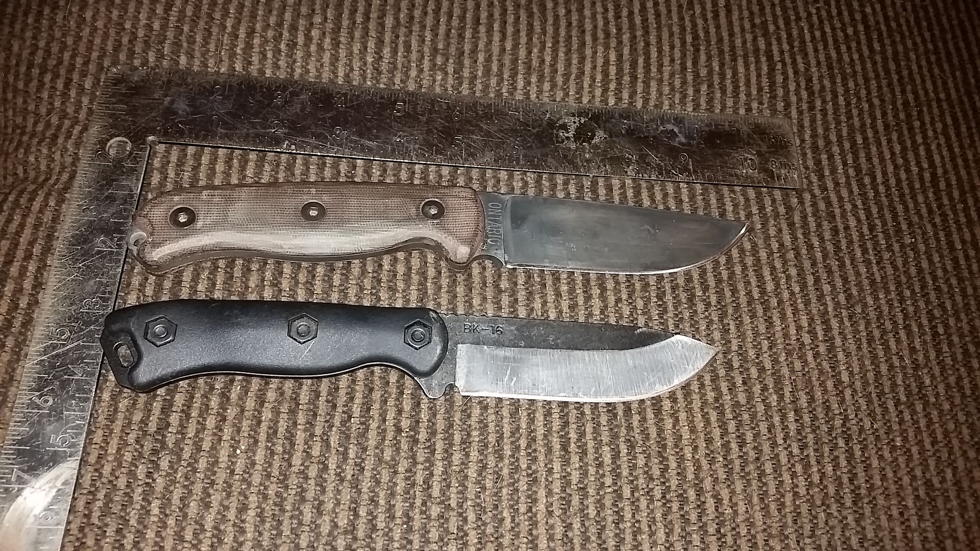

I'm really drawn to this knife. I think because it reminds me of the Rat1 blade shape. I have a Rat1 and love it. My concern is that the Tak1 might be a bit thicker and longer than I want. The BK16 is just the right size. But the Take is aesthetically what I want. Also with the BK16 I would immediately mod the knife but the Tak1 I wouldn't need to mod. So basically its the width and length of the Tak that I'm unsure of.

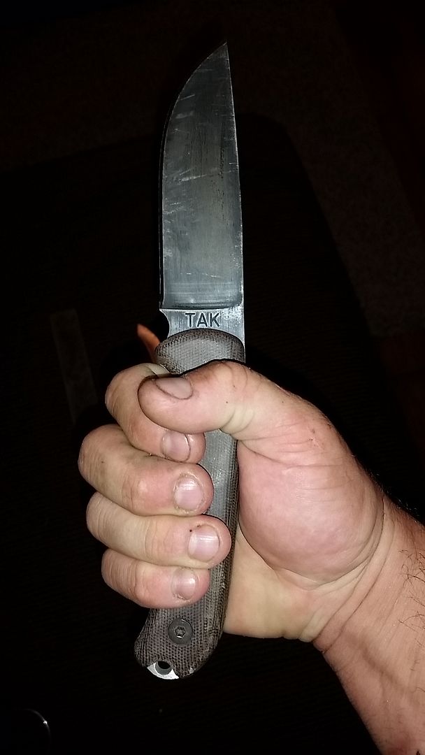

I like it better than my 16, and the 16 is an awesome knife. The main reason I like it better is the handle. I can comfortably wear gloves with this knife where as on the 16 there isnt enough room for a glove with my big hands.
Here are some comparison pics.
Keep in mind, the TAK handle was not comfortable out of the box. I had to do a lot of reshaping on the belt sander to get it contoured and comfy, but that took all of twenty minutes. Get one, you wont regret it. Oh and you will want to thin the edge a bit.
Thanks tobissm!! That's the comparison I was looking for. Not saying I wont get a BK16 at some point .... but my next purchase is the TAK 1. I will be ordering it within the week. Thanks again.
