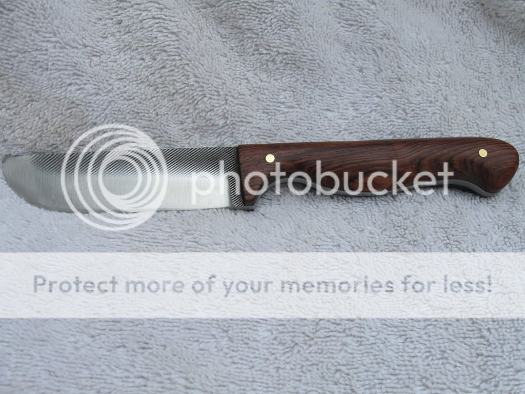

Mine have always sucked mainly because i know nothing about camera,s or photography.With a little help and some experimenting ive gotten better.
Here are some i took of a Knife a built to sell.And a bit about how i got to this point:

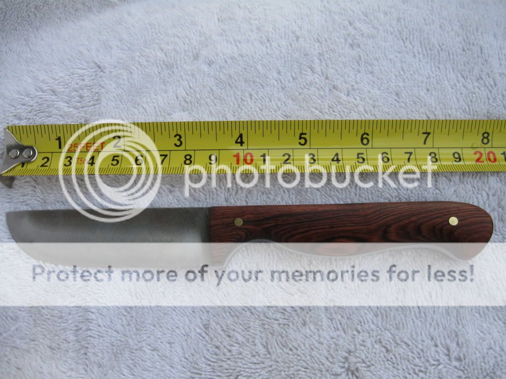

It was cloudy outside so there was no direct sun light.My best pics resulted from setting my camera dial to BEACH,MACRO on,FLASH off, NO tripod(yet).The other thing i tried was different backgrounds, i used a white towel (worst),a faded purple towel(a lot better) and a green and white striped cushion (best).These pics are as they came from the camera ,i have NOT done any touch ups.
This is with camera settings the same as above and a few minutes earlier using the white towel as a backdrop.Fairly large difference in quality is seen.IMO
This is from a coupla days ago similar cloudy conditions and the camera set on AUTO,and FLASH off :HUGE difference ! Im stoked !!!

I don't think they are so bad but I'll tell you something I've noticed so far if you wish.
The background is quite important as you said.
When the knife is in relatively dark colour (in this case), the background should not be
in light colour. It will make the main object look even darker and make it inconspicuous in the scene.
I think there are some photo related threads sticky in custom and handmade subforum.
It should help you I believe.

You've got the main elements.
1) Natural light is supreme and flashes have a way of doing unattractive things to tiny scratches on the blade;
2) Cloud cover to keep direct sun out of the way, but provide enough light for the shot
3) Low iso setting if you are capable of setting it on your camera for better resolution;
4) Low F-stop, again if you can control it, for sharpness of both knife and background; If you do photo-edit touch-ups, it is better to under expose the knife. You can always brighten up later. It is hard to correct for too much brightness effectively.
5) A good background - I like the woodsy setting myself the best.
