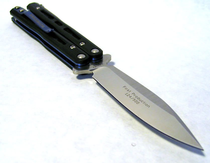

Shot with a home-made "photo-box" and a single off-camera strobe and fill reflector:

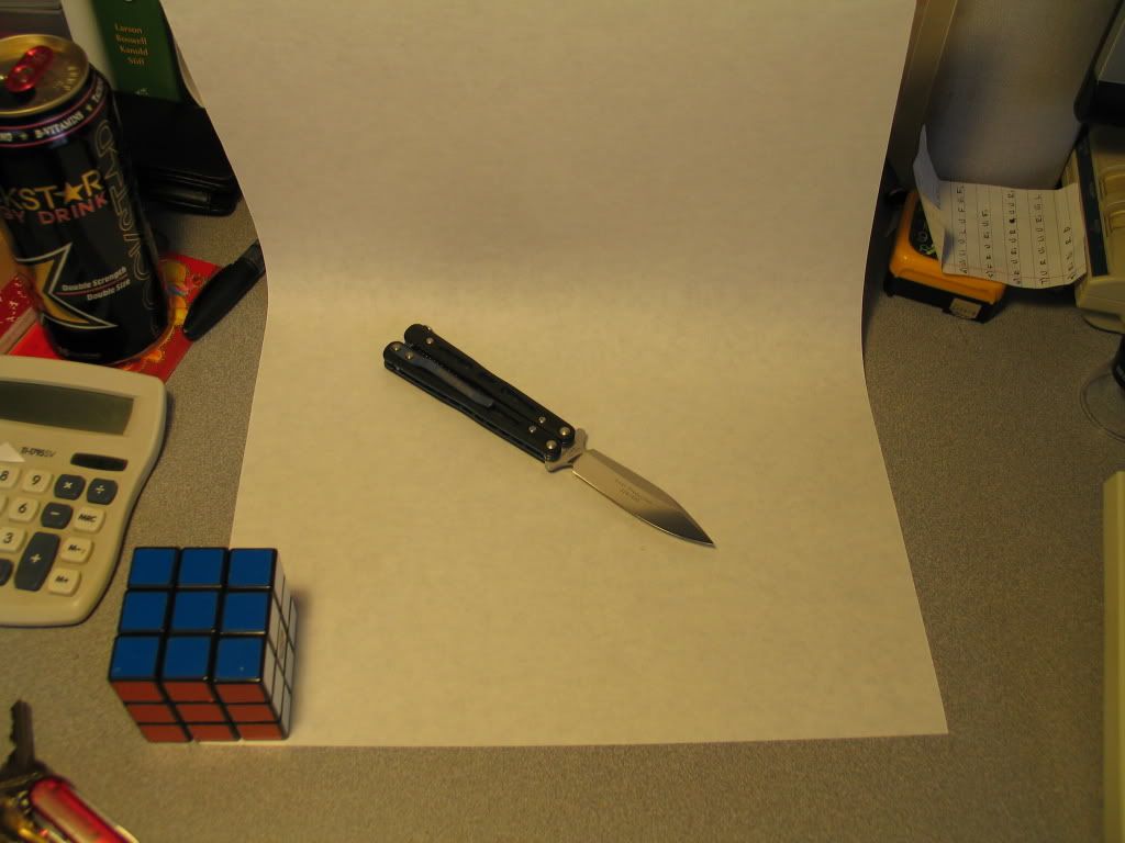

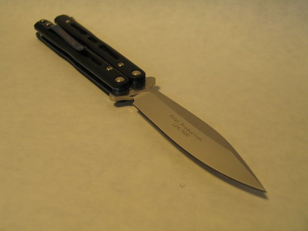

If you don't have the option of going outside for pictures for some reason, you can set up a small studio in your own home for smaller pictures. I have one of these on my desk.
Knife photo
Studio
I am using a Canon Powershot G5 with flash off and macro setting on, and a generic brand table top tripod.
As you can see, it's nothing more than a piece of large butcher paper. The rubix cube keeps the paper from sliding around, and for a backing, I just used a glass that I was drinking from. When I use my table lamp, I try to keep it as far away from the subject as possible to shoften up the shadows.

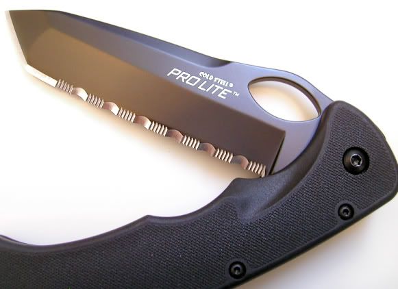

First - to control reflection in the blade - edge. It is like mirror and show whatever reflected in it - and it should be something white lightened screen or filter. al3xd4gr34t provides excellent demonstration of this.
Second - usual mistake, I see in many even in some professional knife photographer pictures. Side of the knife need to be lighten. Handle is rectangular and so if light source is up sides of the handle will be dark. Sides need to be lighted - it is like 40% of handle picture and special light need to be provided.
Thanks, Vassili
P.S. I use three flashes - more then enough.
Here some examples:
You may see that front of the knife is lighted not dark and this is IMHO looks way better then when it dark - as on many pictures of knives.
Here I found same knife with dark side and with lighted side:
You may see difference for yourself.
