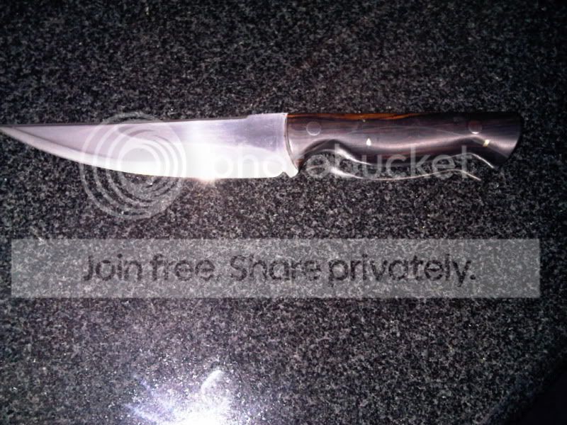

1st blade - 1095 steel, 1/8"t, cocobolo handle, suguha-ish hamon (Apple Cider etched and polished), Stainless corby bolts.
FWIW - forgive the quality of the photos. My significant other took the camera with her on vacation, so I had to use my blackberry instead. Not the best of photos, but it gets the job done.

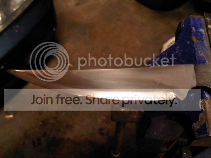

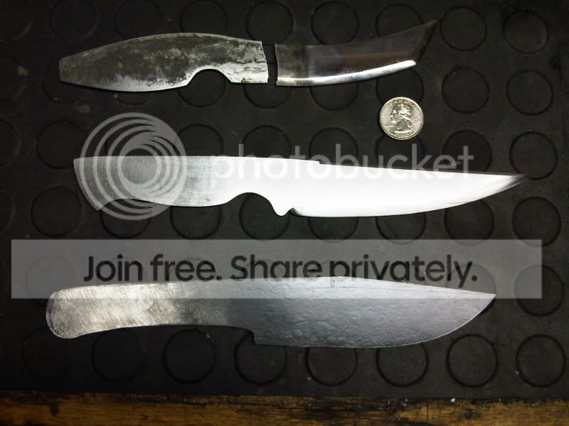

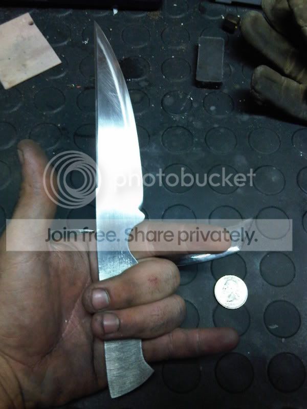

Here's the blade profile ground.
Blade in question is in the center. Blank on the bottom is my second blade which is detailed later. Blade on top was an experiment that failed - I tried to straighten a slight warpage...before tempering. Yup - SNAP! Bladsmth set me straight on that affair.
Here's the blade in my (dirty) hand just prior to heat treat.

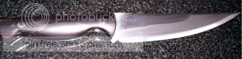

And in the end I "tossed on" the cocobola scales, ground to fit, polished, and here's the end result of about 30hrs of labor. (The pics don't do the blade any justice. The hamon line has a nice silver line on the blade that looks like it wants to jump off the blade, with some slight irridescence on the spine-side of the hamon line. I'll get some better pics up when I have my other camera).
To me the blade looks beautiful, but it's not without flaws. I still need to sharpen it, I'm still working on my profile-grinding technique (it would look better with an actual flat-grind), and I won't do what I did on the handle again. If you look carefully you can see the ends of little brass pins in the handle. I wanted to have a bit of spacer material look like an inlay, so I cut the scales in half and glued them back together with black spacer material in between. I used little brass pins to help hold the peices of scale together while the epoxy cured. During grinding/sanding of the handle I removed too much material and hit the brass pins. The brass clashes with the bright blade and SS corby bolts too much. The effect of the faux-inlay is neat, but flaws the handle if ground too deep. Oh well - learning experience.

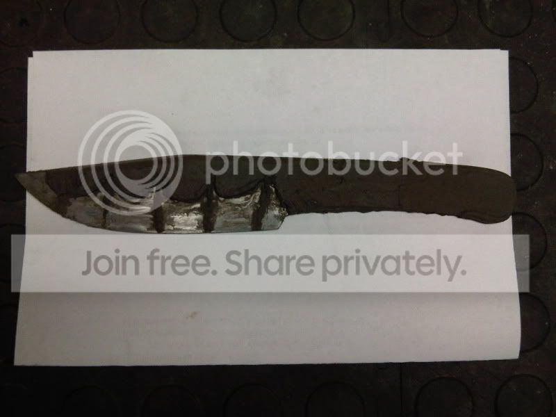

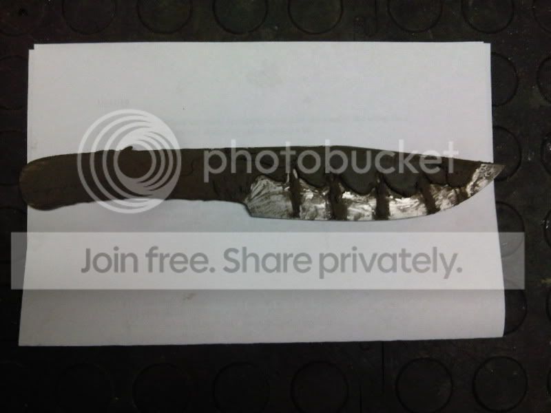

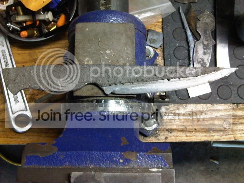

Here's the right side of the blank clayed up and ready for heat treat.
And here's the left side clayed up.
As you can see the hamon should have a more "flame-like" effect if successful. The narrow lines of clay extending from the hamon area to the blade edge were my attempt at Ashi lines. Turns out the damned refractory clay I'm using is both too thick and gritty for fine detail. Even when I watered it down a little to spread it better it flowed too much for sharp ashi lines. I need to try some satanite or rutland's stove cement next time. The clay lines are also not 100% symmetrical on either side of the blade. I tried to get them exact, but they were still off by 1/16" to 1/8". This also may have come back to bite me in the ass as you will see later.

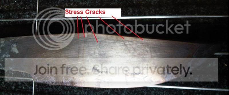

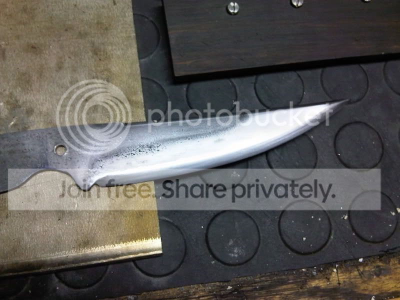

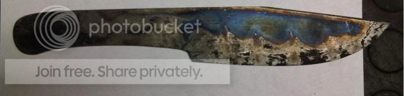

Here's the blade just after heat treat and prior to temper. You can get an idea of the hamon by looking at the blue tempered area. I heated the blade to 1,475 in my forge, soaked it for 5mins or so, then gave it an interrupted quench in 100deg brine. When I did the quench on my first blade above I held it in for 5sec, pulled it out for 3sec, then back in until cool. Turned out the hamon line jumped up under the clay line by 1/8" or so. To avoid this on this second blade I queched it in brine for 3sec, out for 3sec, then back in until cool. On both blades I used the same forge temp, same brine temp, but altered the interrupt timing since Bladsmth stated that a slight variation in your timing will have a major effect on the hamon. He was right.

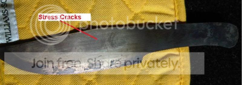

Here's the blade on it's first cool-down cycle after first temper. (I temper for 2hrs @ 450deg, 30min cooldown to room temp, another 2hr temper @ 450deg, and then a final cooldown. It's in my oven right now finishing its second cycle). Here's where it gets interesting. When I was scraping off the clay after the quench I noticed some swirl marks that look like surface cracks. When I saw this my heart hit the floor. I was hoping for the best, but after the first temper these surface cracks became more apparent as the heat highlighted a fair bit. They can be seen below in the pics as faint, brown, hair-line fractures.

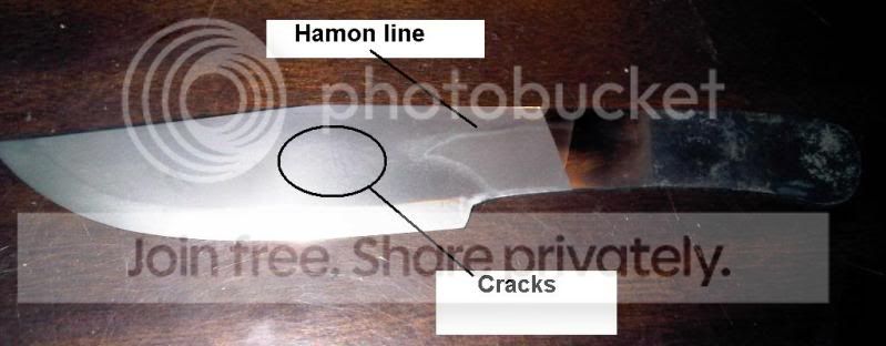

My question is are these cracks fatal? I'm not sure of their depth and am hoping that they'll get removed during the polishing stage, but I'm not holding my breath. I didn't bang the blade around just prior to tempering, and I scuffed it as light as I could with 220g to get some bare metal exposed so I could see the oxidation color, so I'm assuming these cracks were caused by the clay not being completely symmetrical. Next time I won't make such dramatic waves in the clay.
Has anyone had any luck with these cracks not compromising the whole blade? I can see the hamon right after I hit it with 240g, so the it's going to look pretty damn neat when polished up!
Thanks all for taking a look!
Are you sure they are cracks?? They do not make sense to me. The area under the clay should have not had a problem. I guess they could have traveled from the hard portion but they still do not make sense. What grit did you finish the blade to prior to HT? I would recommend taking it to 150 grit. You need not go above that but this will prevent stress risers. I did not see what you quenched them in. What are you using as a medium? I am still perplexed by the positioning of the cracks. I can only assume they were there prior to HT. That is the only explanation that makes sense to me. I have had one blade spiderweb on me. But I am pretty sure it was because it was an over stressed spring. This is the drawback of using used material. Another question is were did the steel come from? are you sure it was 1095? Hamons are a bear. They are much more difficult than making damascus. Keep trying, it is addictive.

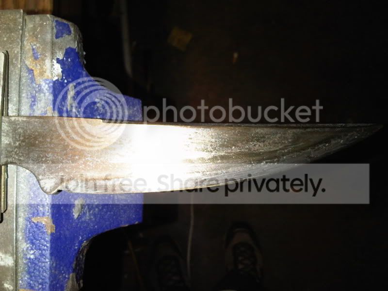

Well, 3rd knife is a complete failure. After 2nd temper I hit it with the grits (up to 1200) and then a couple of quickie FeCl etches to see if there was anything worth developing.
Turns out there isn't. At all. The hamon jumped all the way to the tang! I screwed up royally somewhere...or maybe this particular blank was a little higher on the carbon than the other. (I got four 1095 blanks from Texas Knifemaker's Supply here in Houston. Perhaps I'll try some 108x instead. I have one more blank so we'll see what happens). Here's the 3rd knife after etches and a number of polishes with Flitz:
I have no idea how the hell the hamon line jumped all the way back there. the rest of the blade has that hazy, satiny, stainless steel look like the whole blade got hardened. Did a file test just after quenching and it skated on the blade edge, but not on the spine. Did it again after temper and it bites into the blade edge and spine the same. Might have screwed that up as well. (My temper oven currently has an accuracy of +/-50deg. Need a toaster oven).
The medium I used to quench was a 10% brine - same medium I used on the first blade and came out ok. The only thing I did differently was make a different clay line for the hamon, and alter my quench timing (previous knife was 5 sec in, 3 out, then back in until cool. For this 3rd blade I did 3sec in, 3 out, and back in until cool).

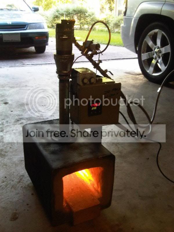

My forge is a PID controlled propane unit I built a couple weeks back:
In the forge I'm using a 3" muffler (exhaust tubing) to even out the temps a bit, and a second PID contoller with remote K-type thermocouple to monitor the interior temp of the muffle. Again, worked perfectly like last time.
There are definitely pronounced surface cracks on both sides of the blades. I'm guessing that my upstrokes in the clay were too drastic and stressed the metal between the upstrokes too much, and they cracked. (The cracks flow through the areas between the upstrokes in the clay). There's also a major surface crack on the tang that runs perpendicular to it.

My guess would be too much clay and/or too hot . The heat problem could explain the cracks, too.
BTW, you should have triple normalized the blade prior to HT by cycling down to sub critical. This will produce a fine grain with no stresses.
Put a wash of clay over the entire blade. Then put an 1/8" of clay to form the hamon . The hamon line will be somewhere just behind the edge of the thicker clay, so don't get too far back . Your blade has the clay way too far back in my experience.
As to the clay, I recommend satanite. That furnace cement you used looks way too thick and heavy. It probably lifted off the blade in the quench.
Set your forge to 1450 F and let it run for 15 minutes to heat the lining ( this is always important for any HT). Apply the clay as suggested and let it dry well before HT. Bring the blade up to heat, avoiding having the flames shoot directly down on it. After five minutes, shut off the gas and let the blade sit for one full minute before removing it and quenching in the 120-130 F brine. The one minute soak in just the hot oven will assure that the blade is not super-heated by the flames.The hot liner will maintain the 1450F temp just fine for the 60 seconds. If it drops in temp a bit, that is fine. If you have a good quality laser pyrometer, you could check the forge temp when the flame is off to see how accurate it is to the PID setting.

This contrast of structures and temperature differences between the hard,brittle martensite and the softer and hotter pearlite under the clay can pull the blade apart. To avoid this and allow the desired structures to form where we want them the brine quench is "interrupted". The blade is quenched for a period long enough to get the edge to form martensite (.7 seconds) plus enough time to drop the edge and part of the rest to a temperature between 900 and 500F. This will ease the stress of the conversion when the edge reaches 450F. The blade is then placed back into the quench to finish cooling. This "Interrupted quench" usually goes something like IN-1-2-3-OUT-1-2-3-IN to cool. It takes some experimentation to get the quench timing right.
