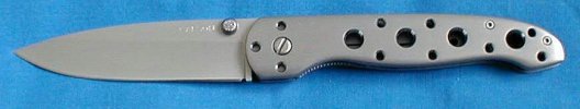

View attachment 1762730View attachment 1762731

That blue handle with the Bowie blade is defiantly one of my dream knives. Such a beautiful folder and it’s the perfect size
The blue handled knife in the photo is a Talonite model which is quite rare. The D-2 CUDA MAXX’s are much easier to find.
