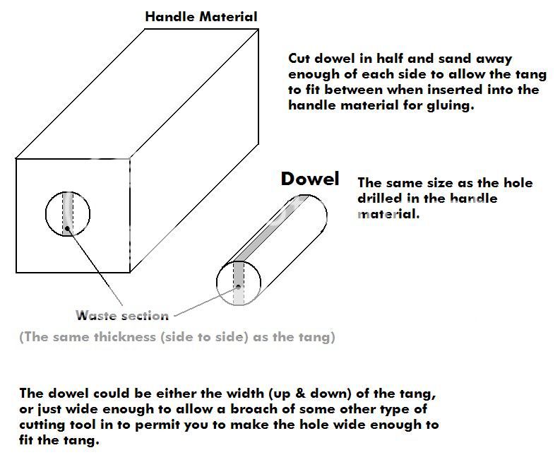

I've not successfully made a tang hole through a piece of wood, and I have a drill press. My last failure was last week.
But reading these responses has given me an idea. Briefly, Drill a large hole in the handle material and fill it with a dowel the same size as the hole except that the dowel has a section removed cutting the dowel into to pieces. Here's a diagram.
This would not have to be the final size for the tang. Rather it could allow you enough room to continue to remove material from the top and bottom until it fit the tang.
Remember, free advice is worth what you pay for. I've not tried this so I have no idea if it would actually work or not.
