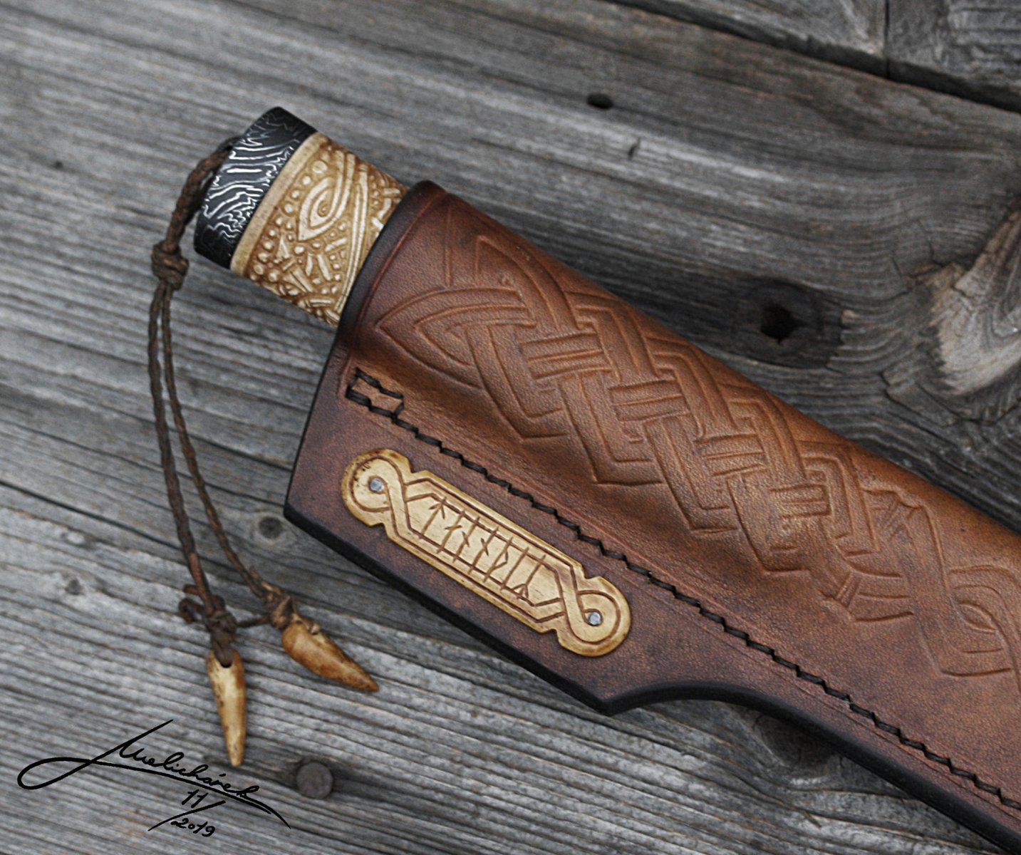

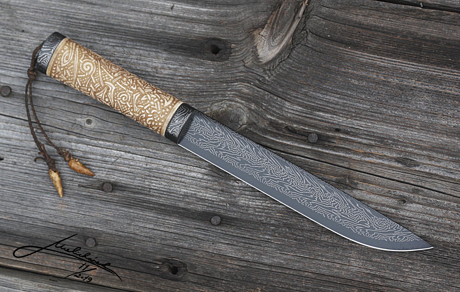

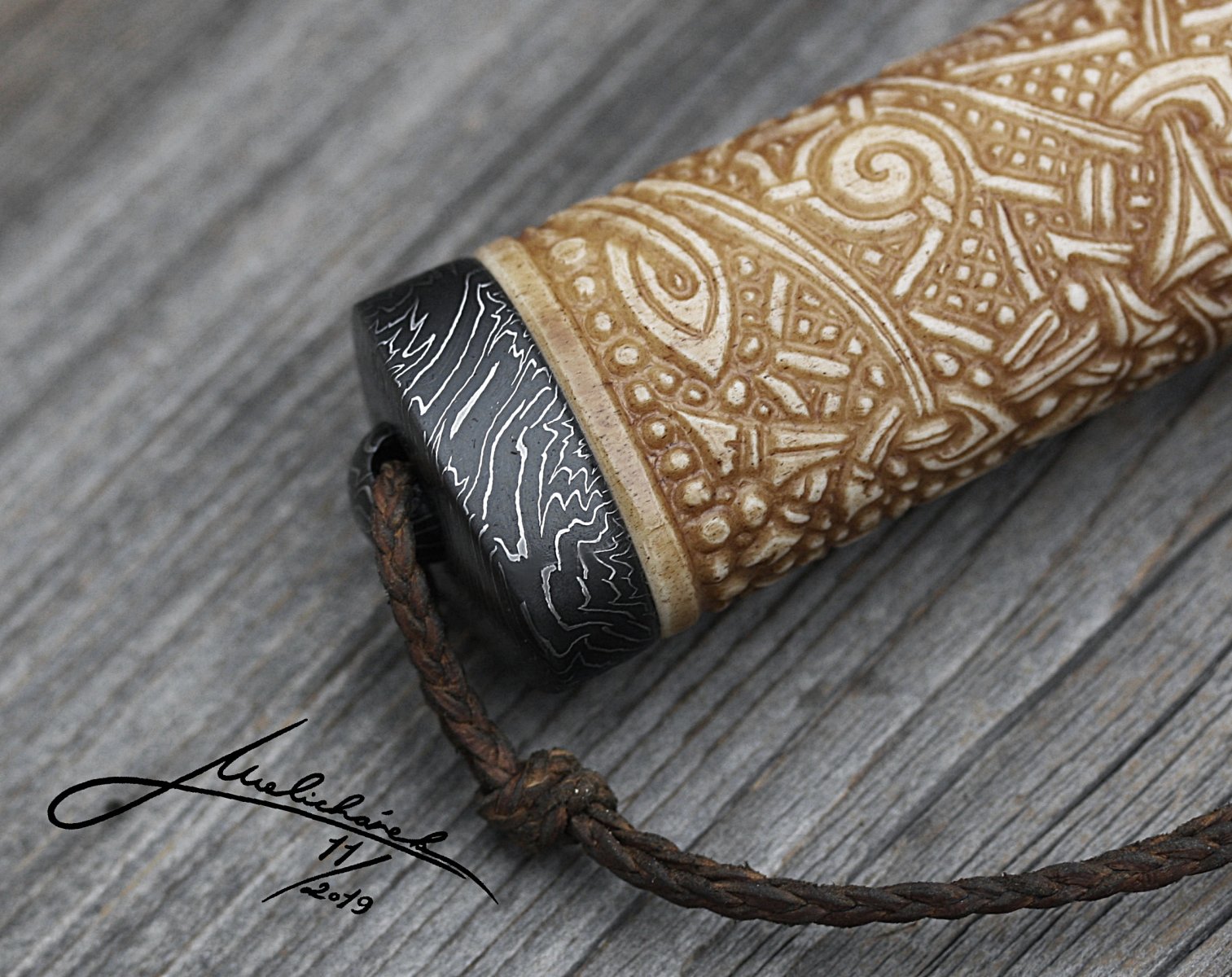

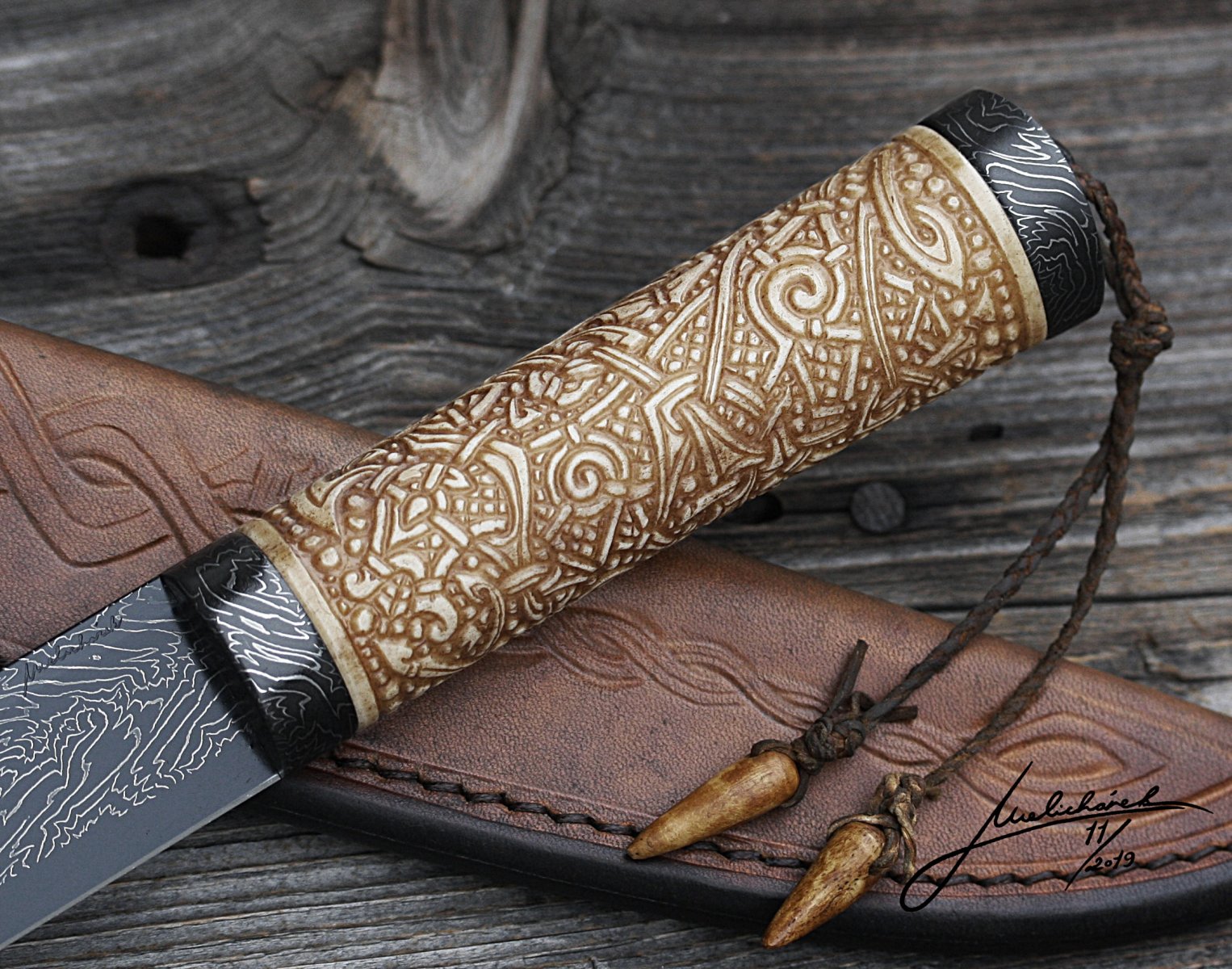

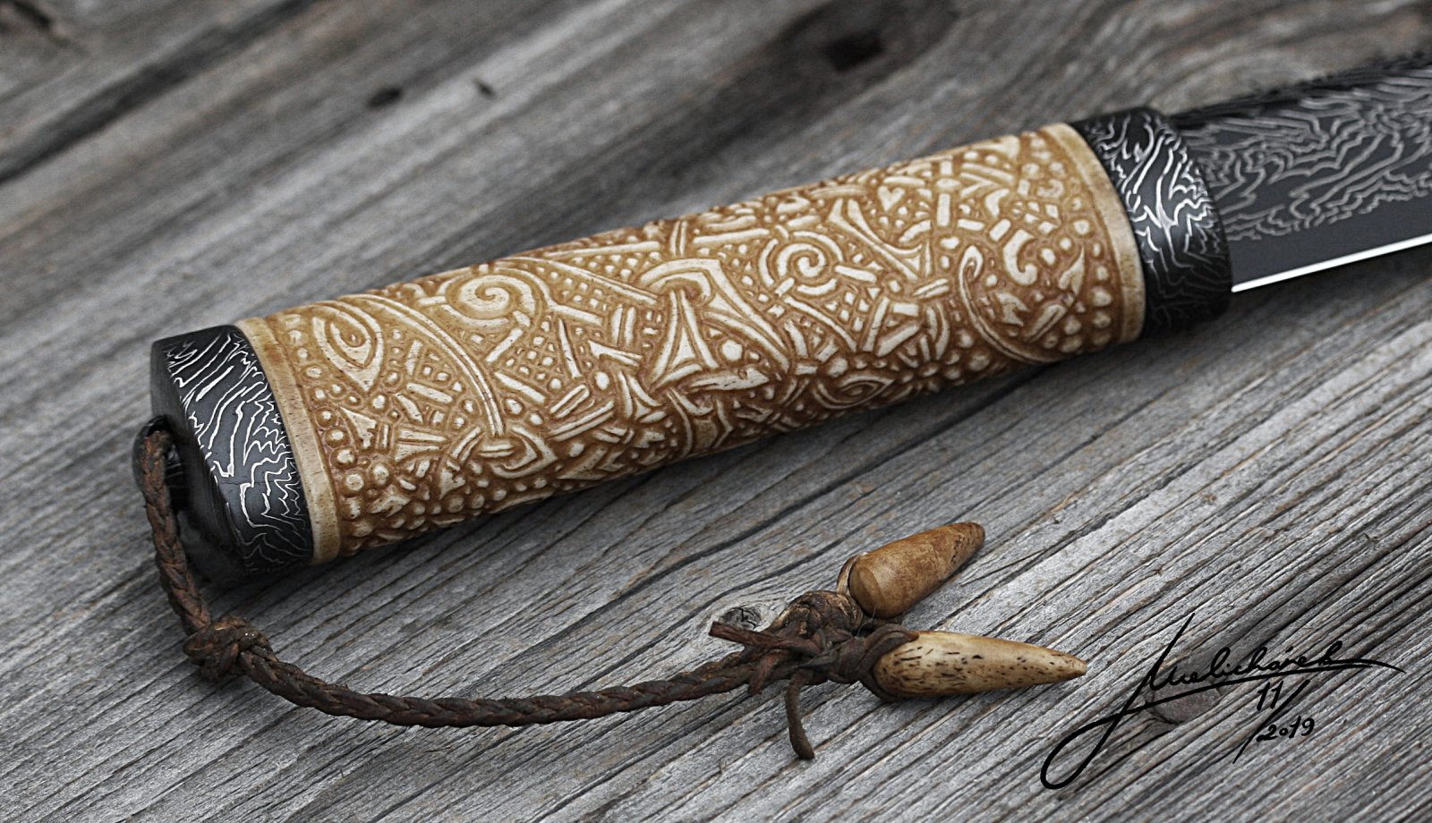

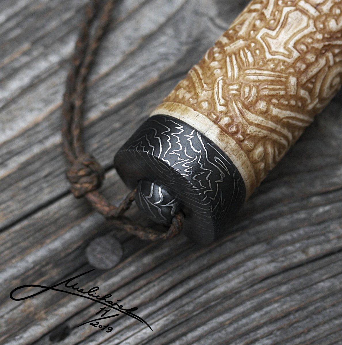

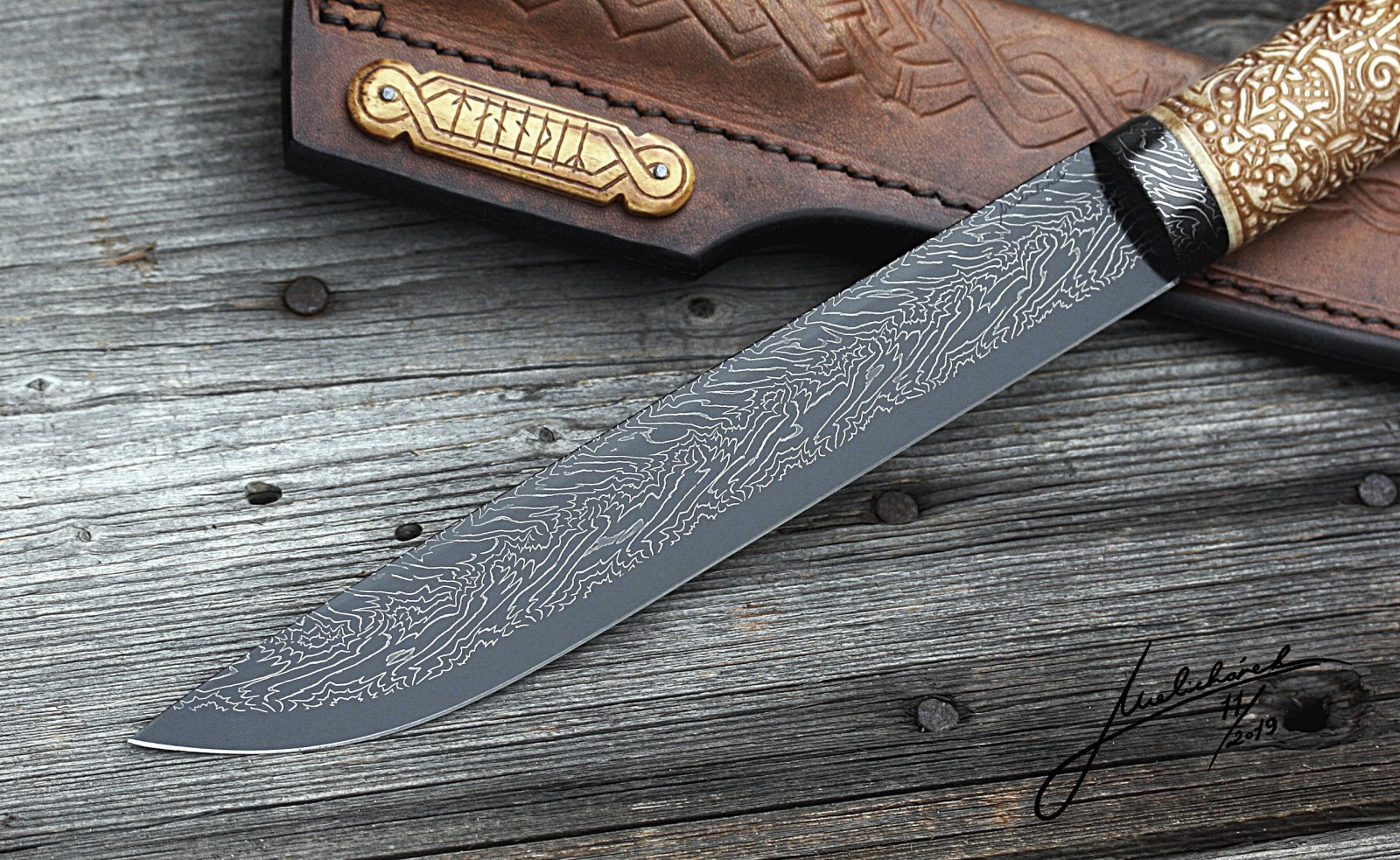

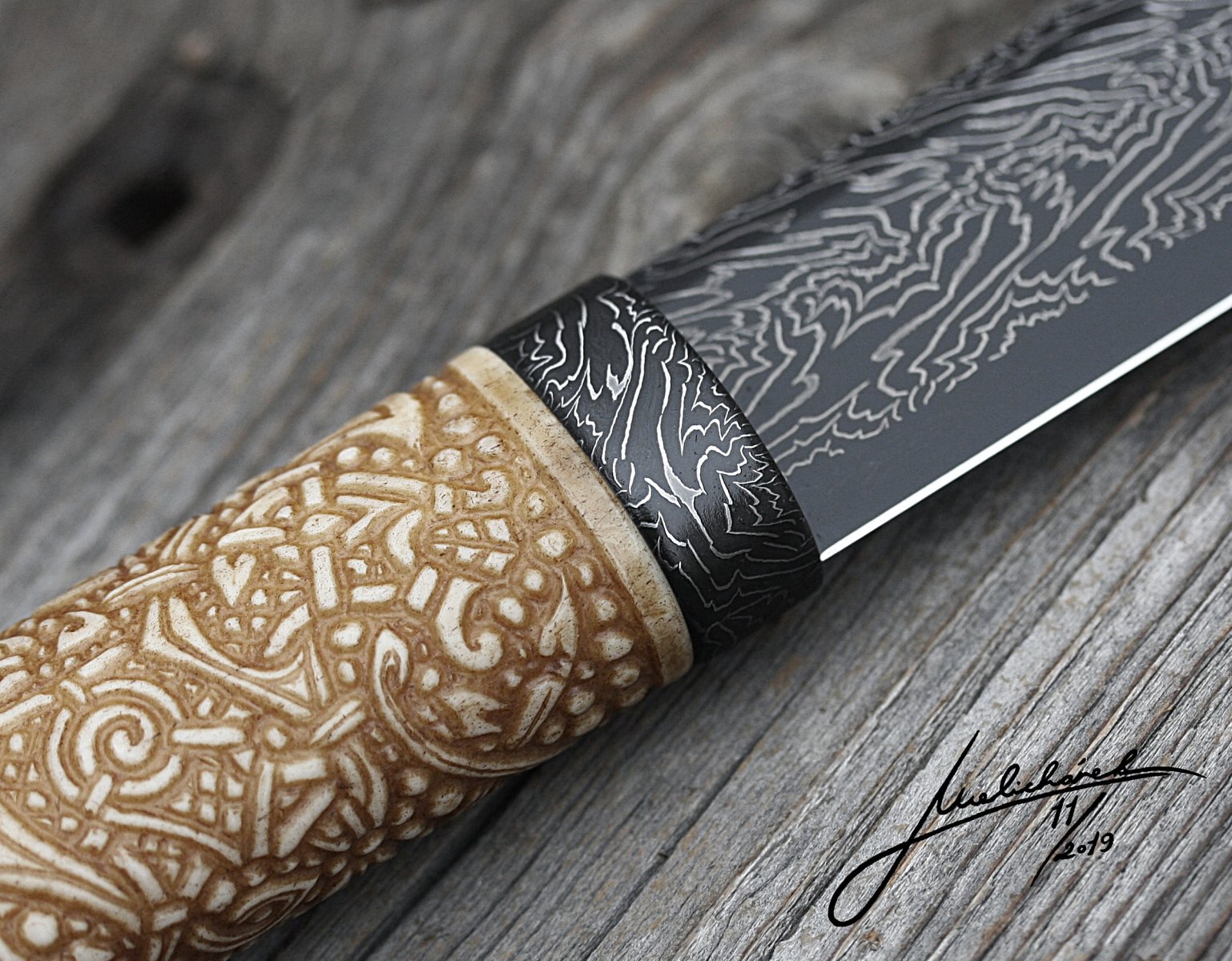

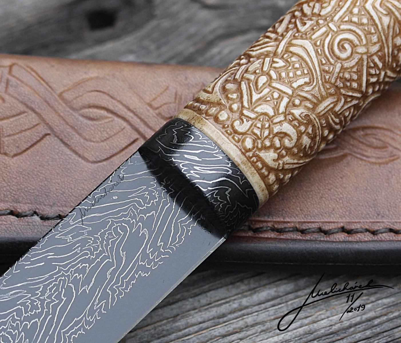

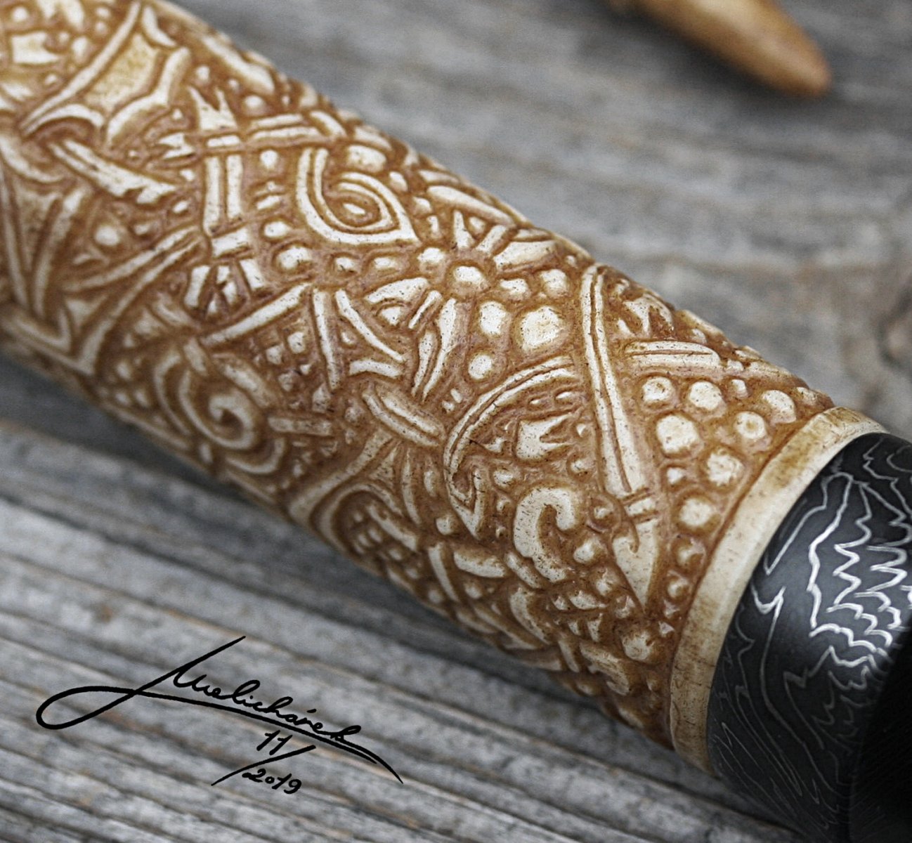

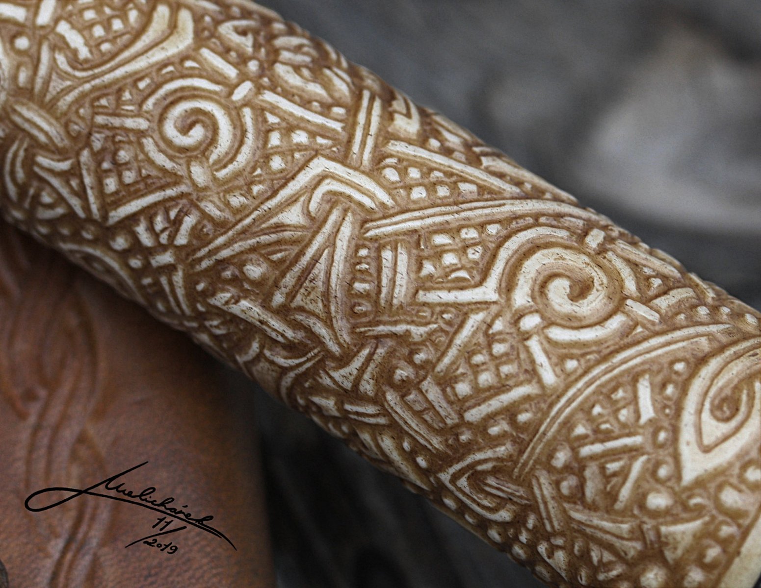

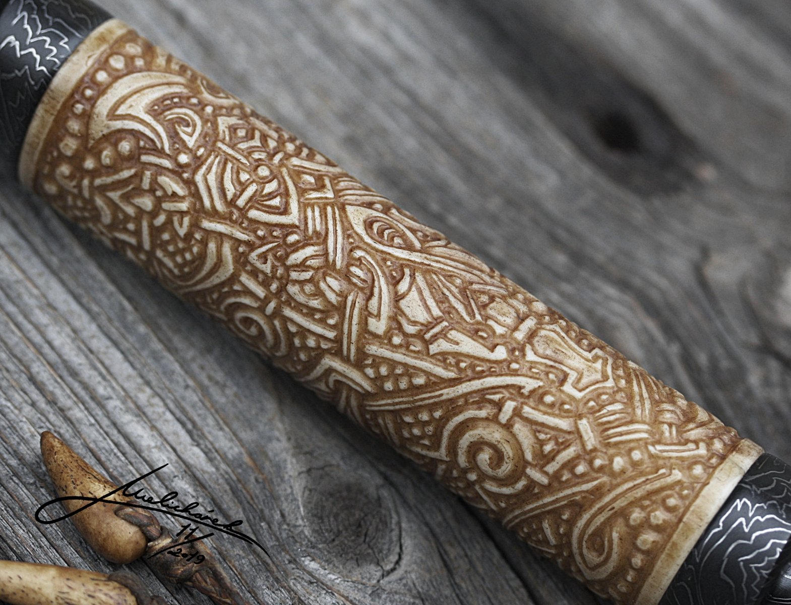

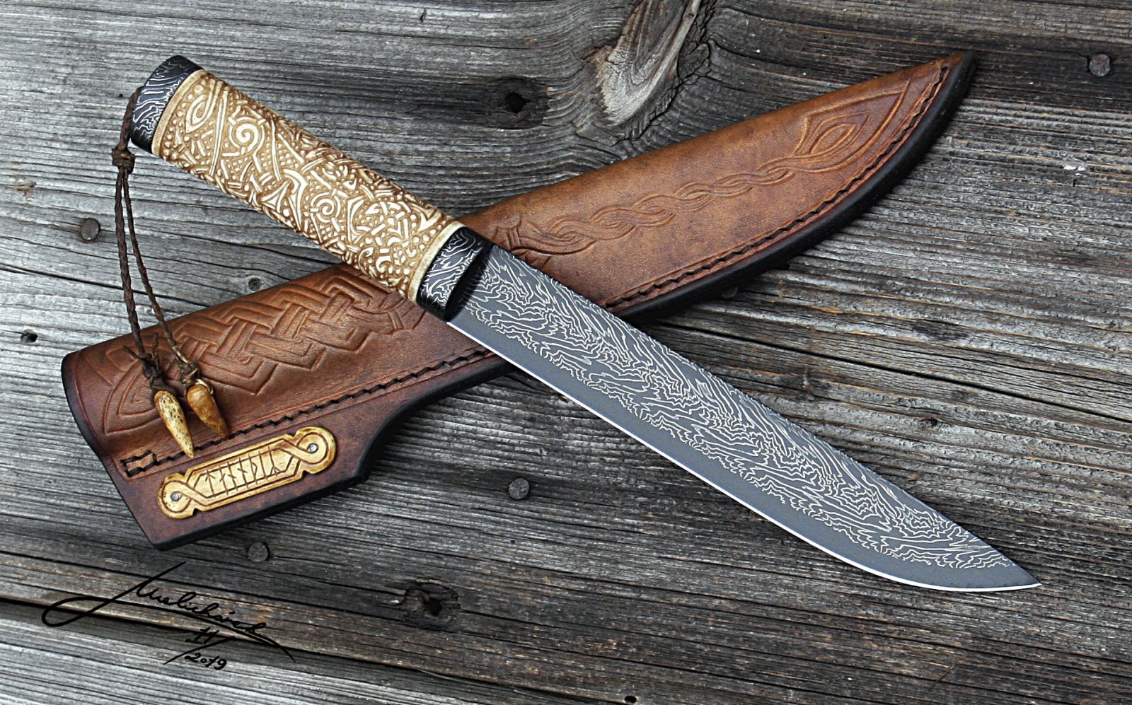

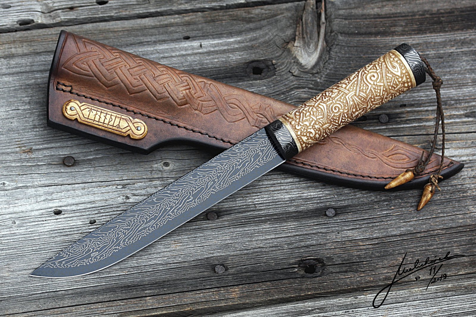

Hi everyone

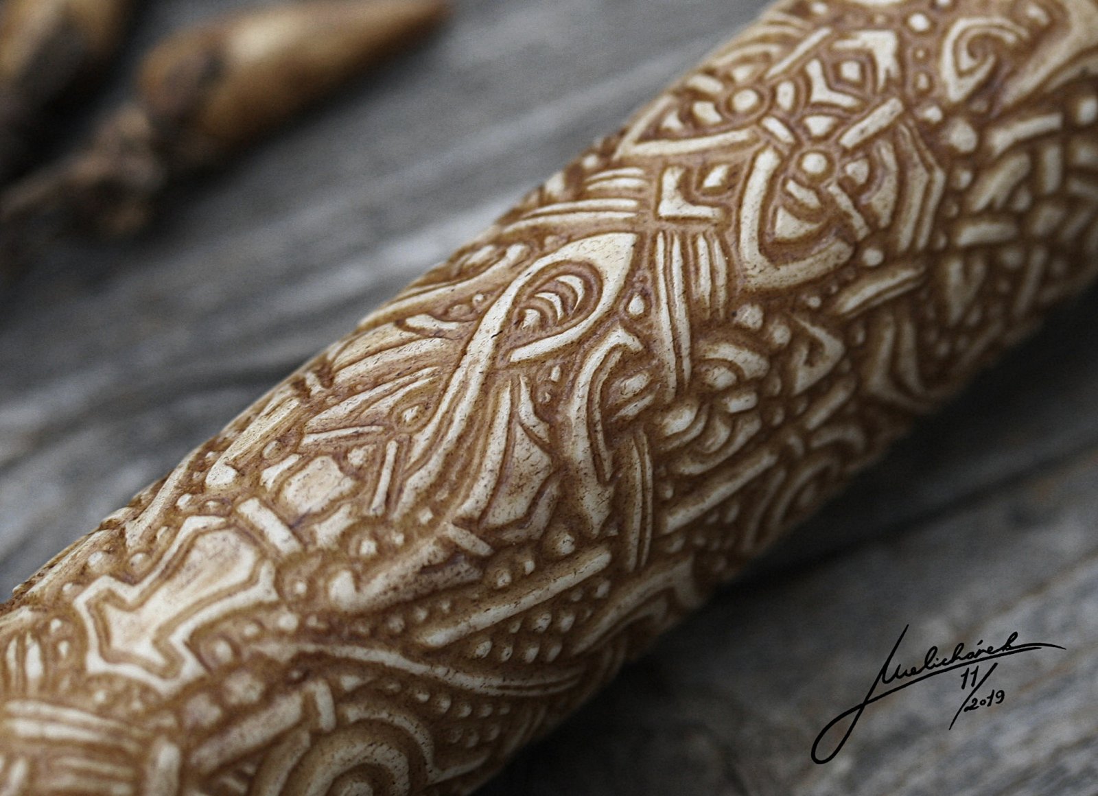

I finished another "viking"/fantasy knife, inspired by norse mythology. The carving shows Thor riding his chariot pulled by his goats - Tanngrisnir and Tanngnjóstr. The carving is inspired by mammen style with some added creativity from my part
I hope you will like it and see you with more knives soon
bb Petr

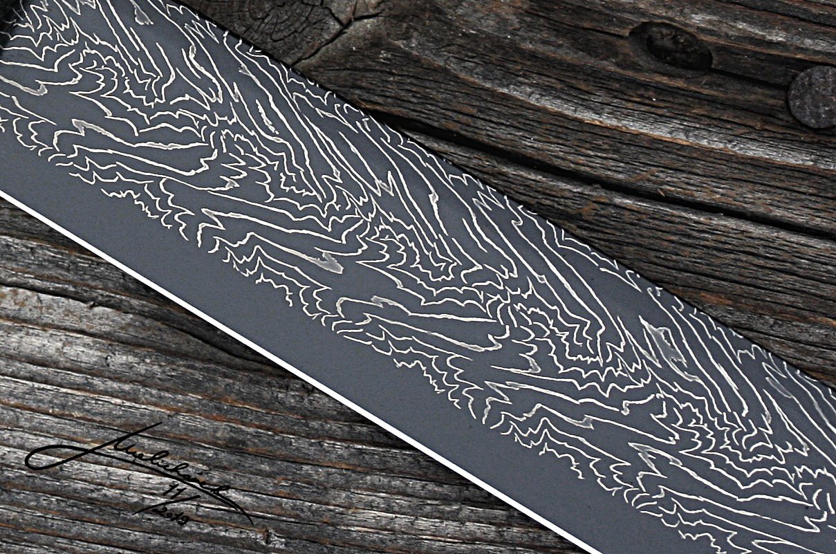

TANNDHIR
Blade - multibar twisted damascus steel 1,2842 (O2) + 75ni8 Uddeholm (15N20) , added edge and spine 1,2842 (O2)
Guard - multibar twisted damascus steel 1,2842 (O2) + 75ni8 Uddeholm (15N20),
Handle - engraved bone
Average length - 36 cm (approx- 14.2 inches) , blade - 22 cm (approx- 8,6 inches).
Blade width at widest point 32 mm (approx 1,2 inches) , blade thickness 5 - 4 mm (0,197 - 0,157 inch) - distal taper.
