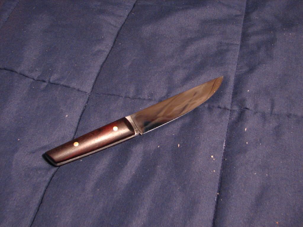

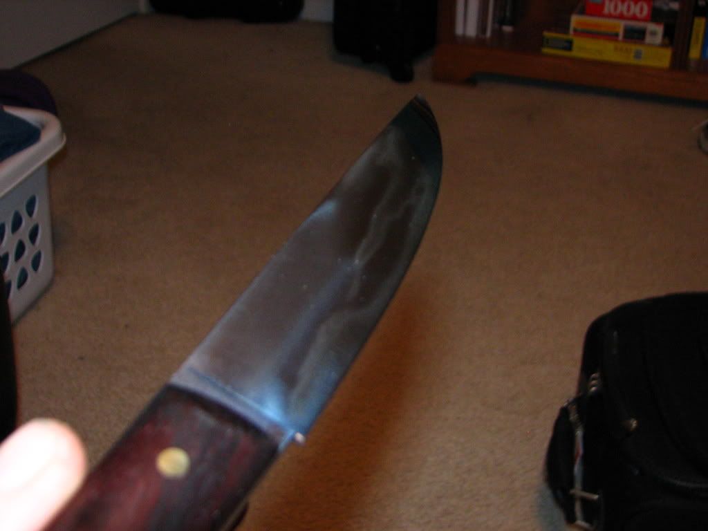

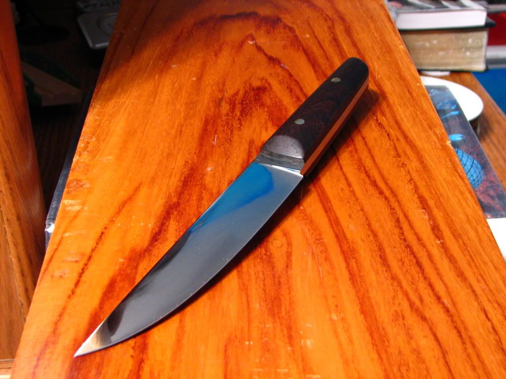

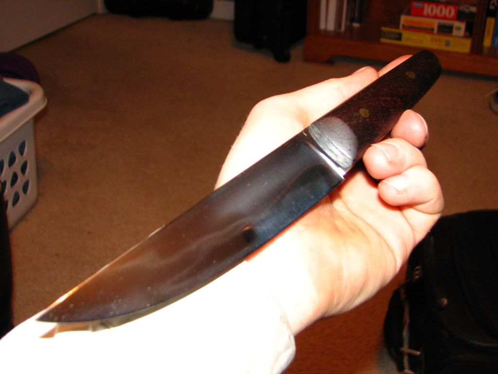

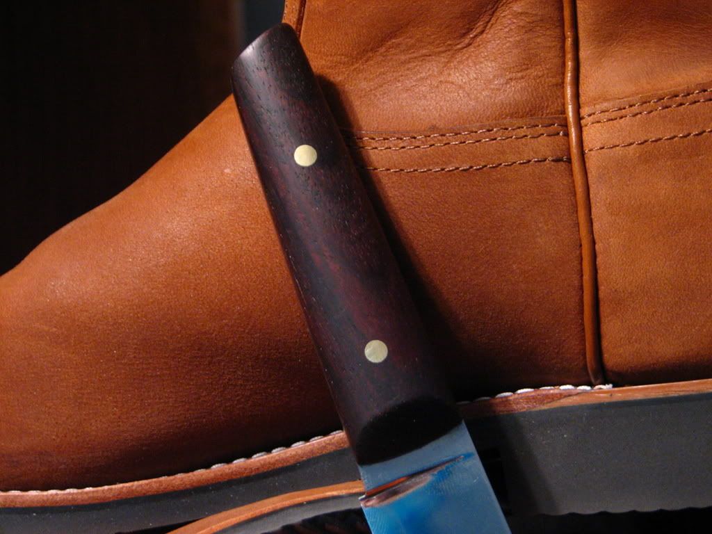

This is something that i kinda "threw together" after a cracked a blade on saturday. i had the blade blank cut out, but i made it not caring as much how it turned out. it is a semi flat grind, filed and hand sanded. it is what the japanese smiths call an "appleseed" profile it is slightly convex. i quenched it in water and it hsa s very unique hamon. it actually has a "blip" in it. i am not usre what to make of it, but it is really hard!
the handle is grenedillo wood secured by two 3/16 brass pins. the steel is 3/16" 1095 high carbon steel. the blade is down to 2500 grade paper.
comments and criticizim is welcome and asked for.
thanks for looking!
~Chris
thanks for looking!
~Chris
